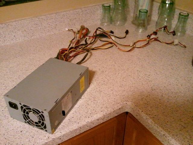

    Got this 700W for $14.99, pulled out of a gateway FX computer. Thing is huge. Biggest ATX power supply I have seen.
    Sorry about these picture's qualities. It was about 8:50 at night when I took these so the only light was the soft yellow kitchen light. Also trying out the camera on my phone, still need to fiddle with the settings.

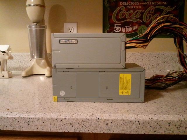

    Big guy. Here's a shot of it with a Delta DPS-700FB on top of it, which is itself a pretty big power supply. They are about the same weight.
    A hem. Ignore the big grey box I put over the label. Keep ya guessing. Internal pics will come tommorow when I can get better lighting and mess with the camera settings.
    (BTW, I wish coke was still 5c...)

      Is the big fella also a delta?
      • POM_MJ
        • Aug 2009
        • 228
        Re: Bruiser of a 700W
        It's HIPRO, my guess
        | AMD Phenom II X2 550BE | GIGABYTE GA-MA790FXT-UD5P | GeIL DDR3 Ultra 2x2GB 1600C7 |
        | XFX GTS250 DDR3 512MB | Dell H525EF-00 | Lancool PC-K62 Black | Samsung 2232GW |
        | 2xWD7500AYYS | 2xHD322GJ Raid0 |
        • weirdlookinguy
          • Sep 2007
          • 1638
          I vote for HIPRO (the fan grill shape gives it away).
          • yyonline
            • Jul 2009
            • 692
            My vote is LITE-ON. Many manufacturers use that fan grille. Some more commonly than others, so it might be a hint, but I don't think it's a giveaway.
            • ratdude747
              Black Sheep
              • Nov 2008
              • 17136
              my vote is delta... possibly acbel...
              sigpic
              (Insert witty quote here)
              • Toasty
                • Jul 2007
                • 4171
                ♪♫ Jeopardy Music ♫ ♪
                Hipro
                veritas odium parit
                • ratdude747
                  Black Sheep
                  • Nov 2008
                  • 17136
                  i still vote delta. look at the censor block on #1. delta has a logo that small. hipro does not.
                  sigpic
                  • Toasty
                    • Jul 2007
                    • 4171
                    1 vote.
                    Insisting still does not get another vote...
                    or chance...
                    veritas odium parit
                    • mockingbird
                      • Dec 2008
                      • 5488
                      It's most definately a Delta.
                      • POM_MJ
                        • Aug 2009
                        • 228

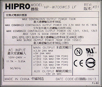

                        My vote is still HIPRO Model: HP-W700WC3 LF
                        • acstech
                          GrumpyModerator
                          • Jul 2007
                          • 1432
                          Another vote for Hipro.
                          A man convinced against his will is of the same opinion still.
                          • 370forlife
                            Large Marge
                            • Aug 2008
                            • 3113

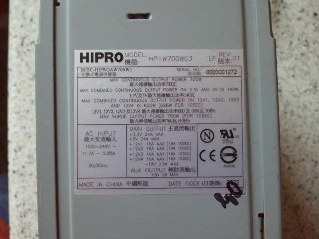

                            Ding ding ding! Exact model.
                            Label, nothing strange here.

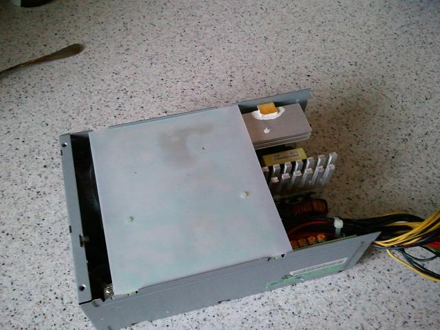

                            Clamshell case removed, revealing the semi-dual PCB design.

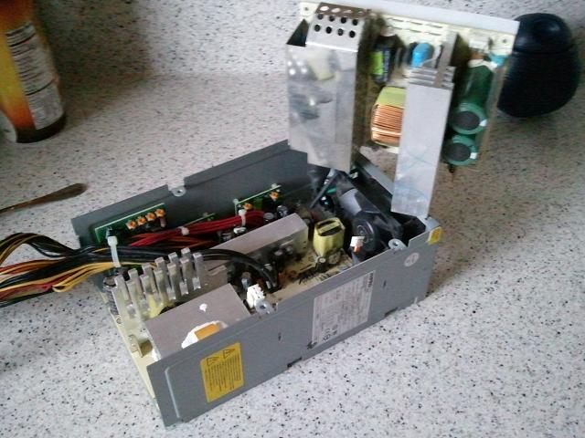

                            Top PCB pulled up.

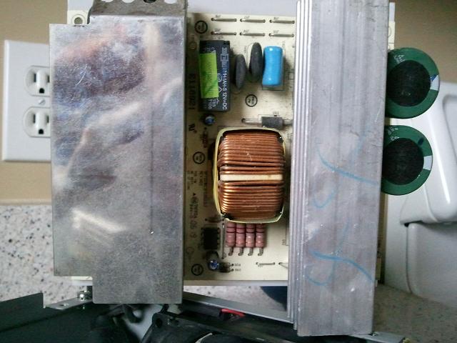

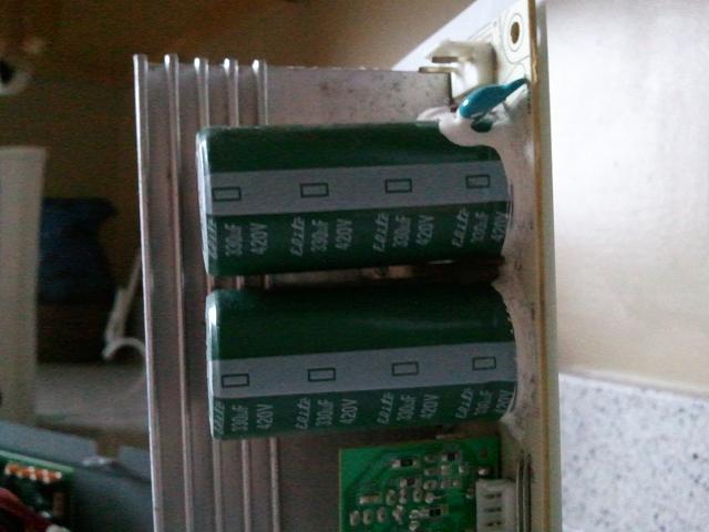

                            The top PCB is simply for most of the primary. The heatsink cools the APFC parts, which are two 21N50C3's and a diode. Primary caps are two Elite 420V, 330uf's. Under that perforated cover is the input filter, consisting of 4 coils, 2 .68uf X caps, and 4 Y caps, with 2 more Y caps on the AC receptacle.

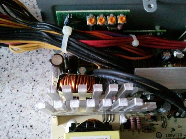

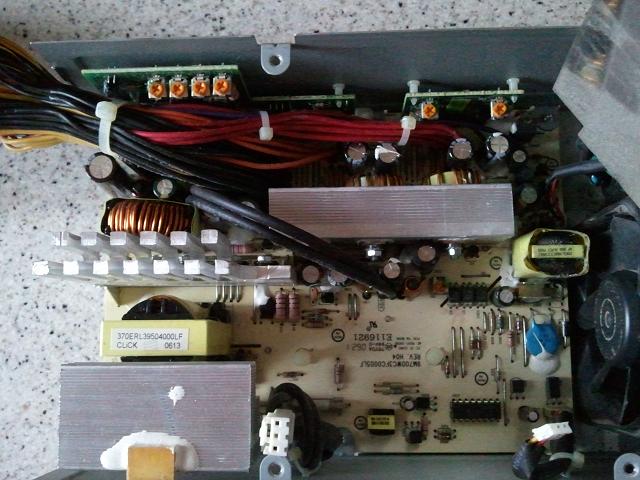

                            Bottom half. Left bottom heatsink cools the primary switchers, two IRFP460A's in two transistor forward. Heatsink above that contains the 12v rectifiers, 5 STPS20H100CT's, good for 20A for 100A combined.

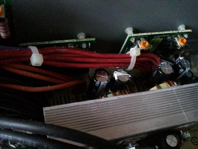

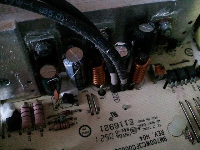

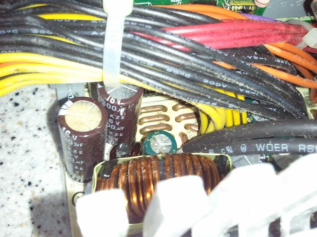

                            OCP shunts for the 12v rails. Secondary capacitors on the 12v are a mix of 16v, 3300uf UCC's and 25v, 470uf Teapos. Those two big 12 gauge wires feed 12v to the right side of the PCB.
                            Here's where they end up. The inputs are filtered by some Nichicon HM's and Teapos.
                            The output from that heatsink is the 5v and 3.3v rails, indicating this is independently regulated. This unit seems to derive these rails by using two P60NF03's connected in parallel for each rail for a DC-DC configuration. Each output gets a choke and two Nichicon HM 10v, 1500uf.

                              Does it need to replace Teapos and Elites?

                                None are bulging, I'm not worried about them. All the HM's have a 2006 datecode, just as the unit itself was made in the 22nd week of 2006.
                                There are also some random small value (<1uf) Ltec's scattered around. Forgot to mention the fan is a San Ace, I can't get the model number as the fan is mounted using rubber mounts and I don't feel like breaking any of them. Also, shunts are present on the two minor rails as well.
                                The "CLiCK" brand transformer I have only seen in other units made by Kingnod.
