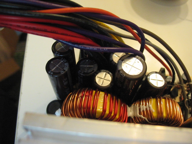

              Here's a couple of pictures of Antec TruePower 380SP with covers removed. I've done enough reading and I'm about to begin my recapping career with this. I bought some (500pcs) Nichicon caps, mostly PL(M) series, to begin with so there is more to come
              Edit: Oh yeah, this beast is all-Fuhjyyu as Antecs tend to be.

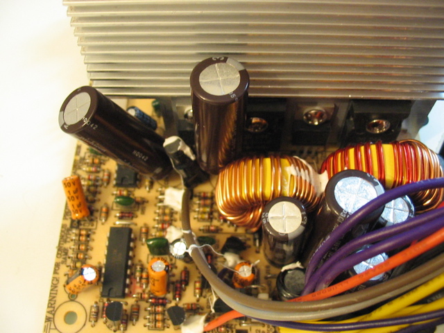

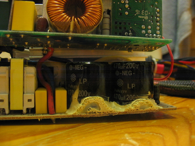

                  Here's aopen 300W W/PFC that came with HQ08 case. Big o/p caps were 1 jamicon, 1 fuhjyyu (bulged and leaking) and 3 teapos. Replaced with physically larger Nichicons without much effort. Input caps were teapos (and will be as I dont have replacements for i/p caps).
                  Hi-res pictures and more are available in http://sourapple.dnsalias.net/photos/?album=60 as always.
                  PS. The 380W Antec mentioned above is now working again. Recapped with Nichicons exept for i/p caps.

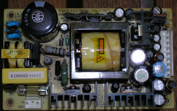

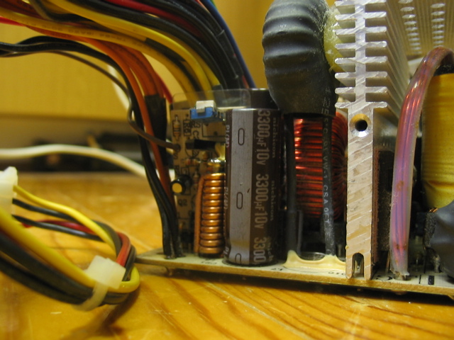

                    Touch Electronic T60-9313 (www.bothlandusa.com), made in 1999 for a UMAX Gemini D-16 scanner.
                    Hitachi HP3 150uF 400V and LTEC TK 100uF 25V on primary side.
                    +5V 2.5A rail: LTEC LZG 3300uF 10V and LTEC LZF 1000uF 16V before output inductor, LTEC LZF 1000uF 16V after it.
                    +/-15V 0.3A rails (each): LTEC TK 220uF 25V befoe output inductor, LTEC TK 100uF 25V after it.
                    +24V 1.6A rail: Nippom Chemi-Con SXE 1000uF 25V (should be 35V) before output inductor, Teapo SX 470uF 35V (bulging ) after it.
                    Leakage between Live/Neutral and Earth was caused by glue on the controller PCB module .

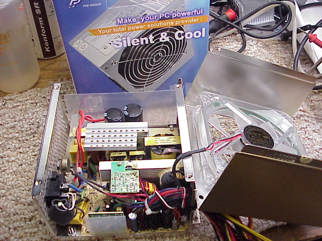

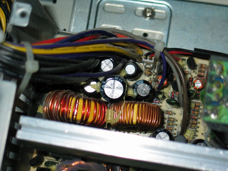

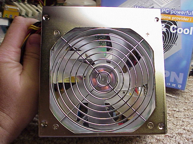

                      fsp aurora 350 fsp350-60pn
                      secondary caps are mostly jamicon with a few teapo

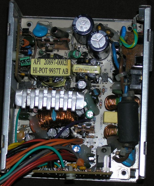

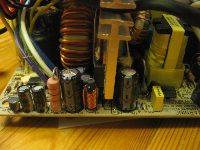

                          AcBel API-8628 110W
                          Teapo SK 330uF 200V primary units, Rubycon YXG 1000uF 10V on +5VSB, Rubycon YXG 1000uF 6.3V before +3.3V regulator; Rubycon YXG 2200uF 6.3V after it, Nippon Chemi-Con SXE 470uF 16V before and after +12V output inductor, Rubycon YXG 1000uF 6.3V befor and after +5V output inductor, with a number of general purpose Lelon units as well.

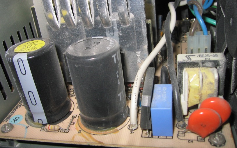

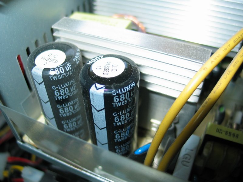

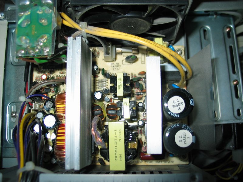

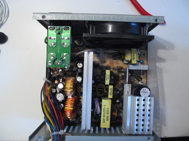

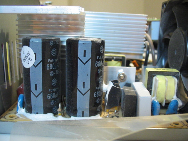

                                      DTK PTP-3007 (Macron power OEM)
                                      G-Luxon 680uF on primary:
                                      Overall view:
                                      Output caps:
                                      G-Luxon output caps, the small orange one is JPCE-TUR:
                                      Macron-like label:
                                      Is in use since 2002 without any problems:

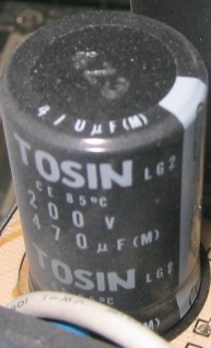

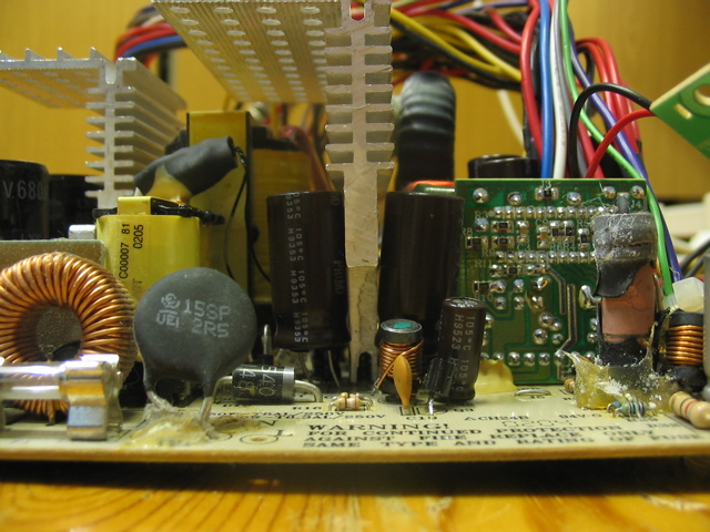

                                        Another DTK - this time PTP-2007 from 2001, works fine:
                                        Nothing wrong, just some dirt:
                                        Unknown 470uF caps on primary side (the same brand is on secondary, along with some JPCONs and JPCE-TUR):

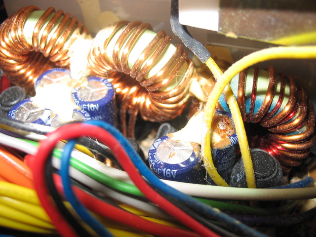

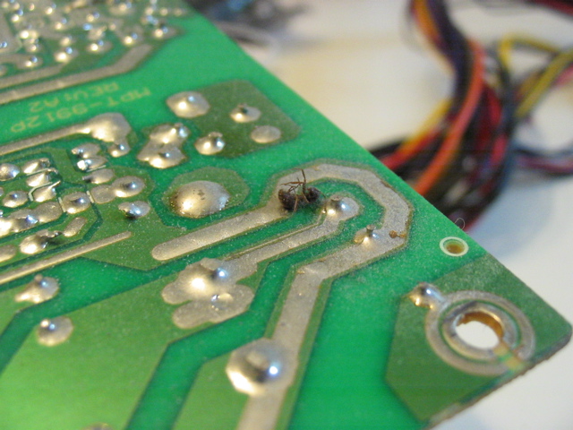

                                          Macron Power MPT-301P
                                          Looks pretty much same as the DTK above. Original caps were same brand except for the input, mine has Fuhjyyu
                                          Recapped output caps with Nichicons while I was at it. Did not have scope or ESR meter to check originals with, but none were visibly at fault.
                                          This one had a bug inside as well. Nicely charred between ip lytic contacts
