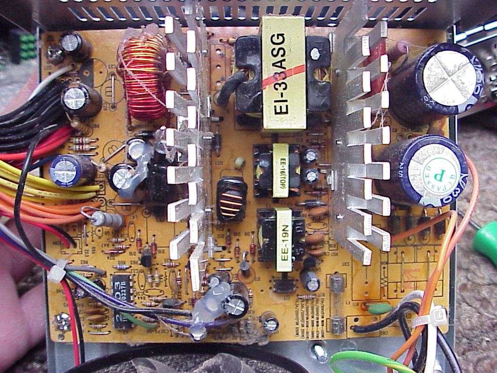

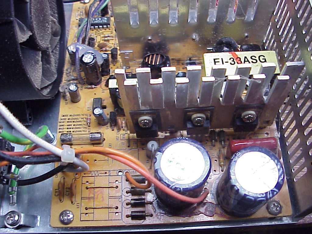

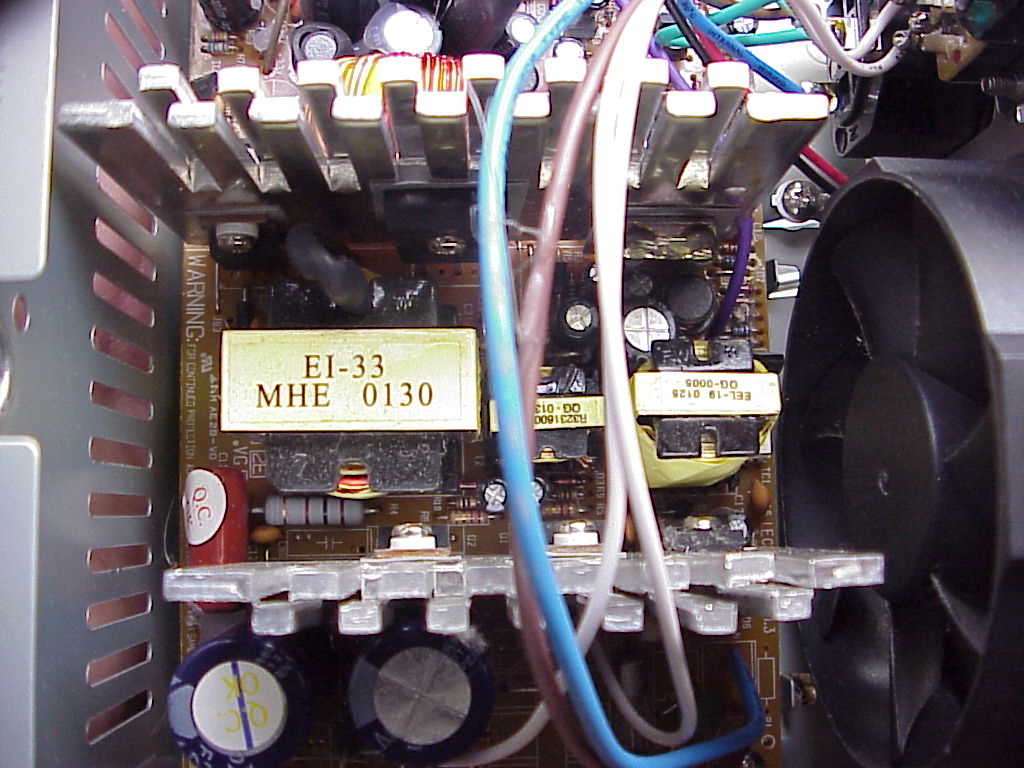

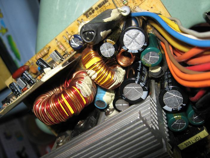

    i got in a big pile of those in sparkle,aopen,and powerman brands.
    all identical except the label.
    even have the sane model number.with "noise killer"
    all full of fuhjjyu caps.
    odd but these all have 4700uf on 3.3&5
    but only a 1000 on 12.
    thats why they are noisy on 12
    i put a 2200@25 fc in the single +12 and the hash is almost immeasureable.
    several had bad yate loon fans too.

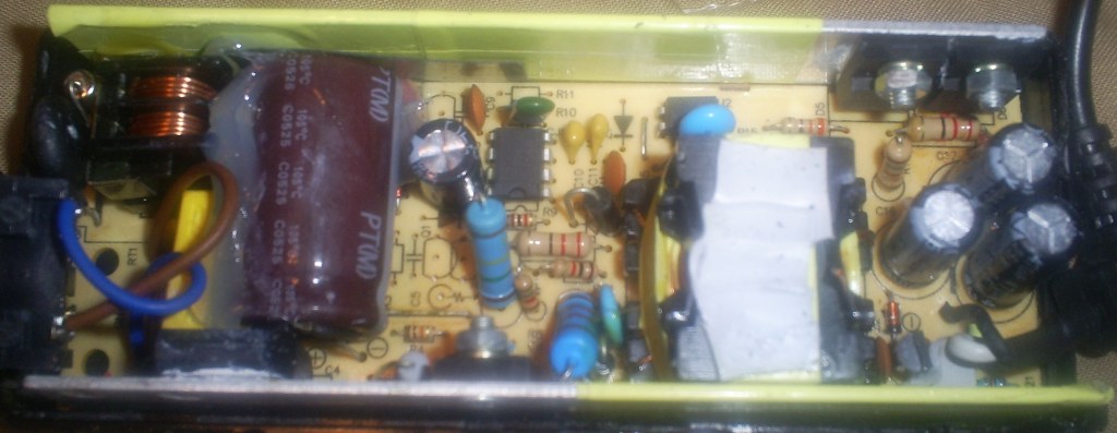

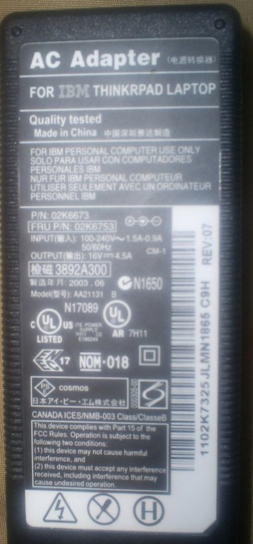

        Here's a fake IBM Thinkpad power supply. I bought this on ebay not realizing it was a fake. It made my sister's laptop freeze and sometimes reset itself. The problem continued (less often) when she started using a real IBM unit. I ended up having to replace the motherboard to fix it, but I wouldn't be surprised if the problem was originally caused by this PSU.
        The "For IBM" wording got me suspicious, then I found this web site:
        http://www.electricstuff.co.uk/acadapter.html
        which made me realize this thing was bogus.
        Only today did I notice that they actually wrote "THINKR PAD" on the label.

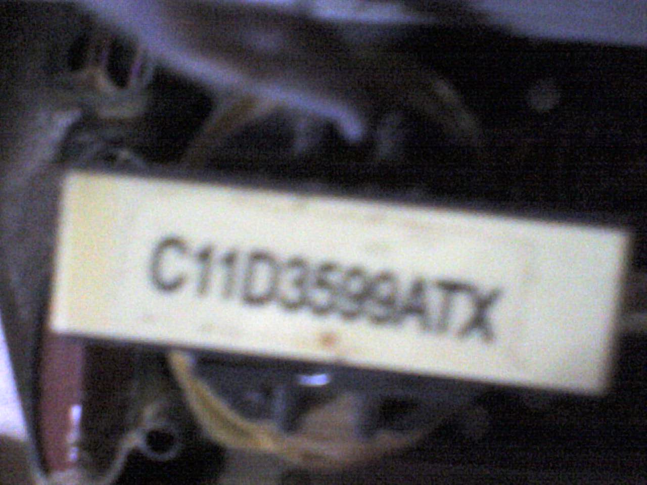

          Re: Power supply build quality pictorial
          For the sake of anyone who tries to google or forum search for that adapter, I'd like to add these part numbers for the above "thinkrpad" AC adapter:
          P/N: 02k6673
          FRU P/N: 02K6753
          And another number which appears highlighted on the label: 3892A300

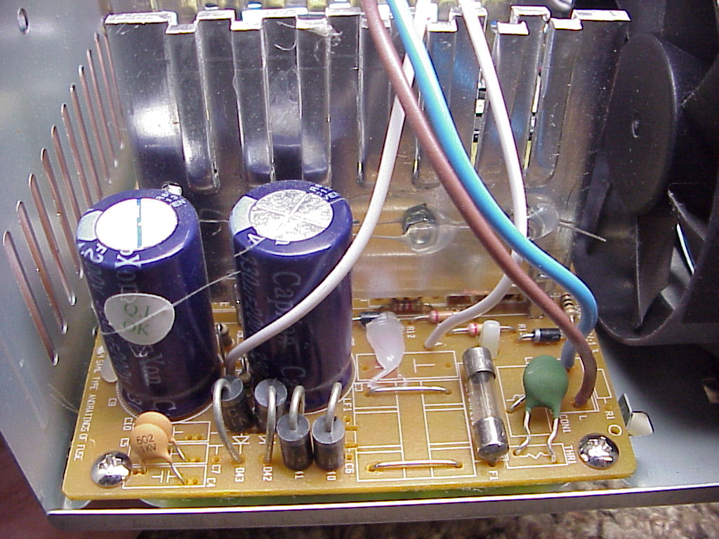

            noname

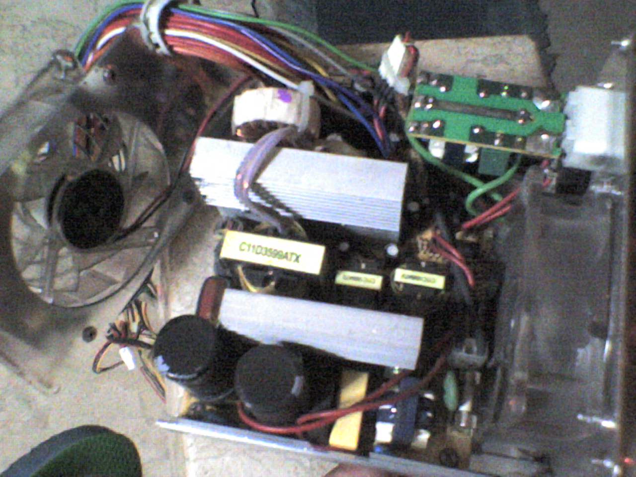

                It looks similar to the amount of open space in the Avance Technologies ATX12V-250MNF supplies that hang like an Albatross around my neck.
                I have a client with several machines that rely on this non-standard shape PSU. This is the type where the fan protrudes out the rear of the PSU.
                Another gripe is the crappy lil' eMachines PSU that use a half-thickness fan. I can't find a source for fan replacements, so the whole PSU becomes useless for want of a fan.
                Gotta love those proprietary parts.

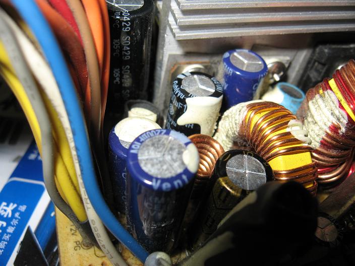

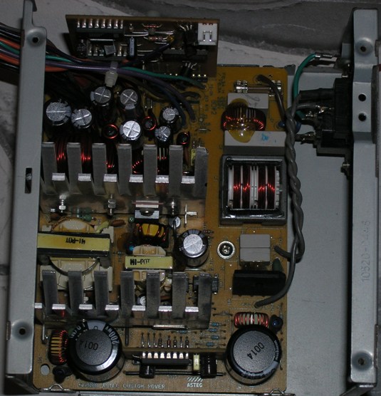

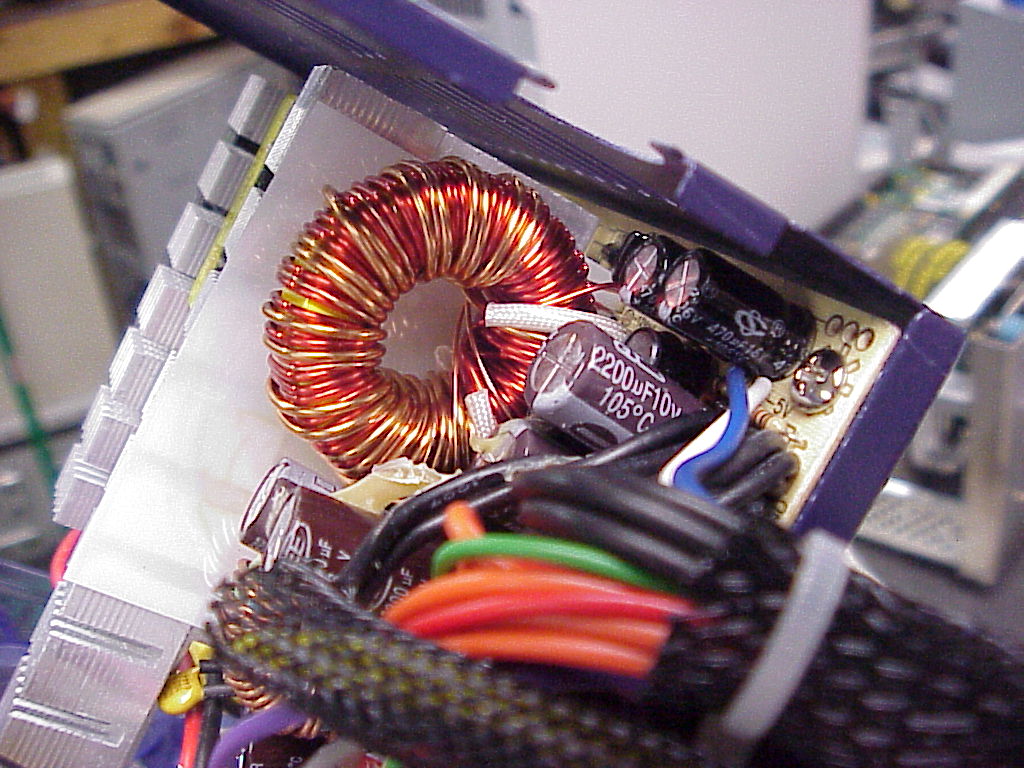

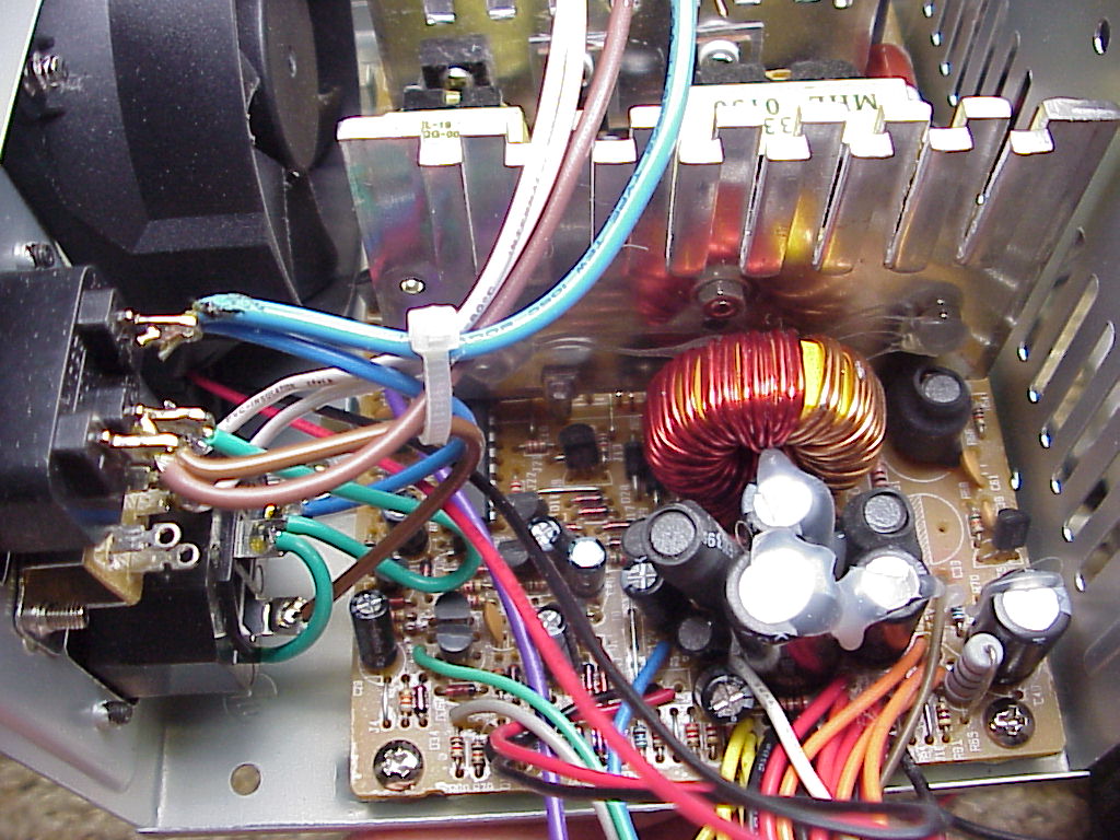

                    Astec ATX202-3555 from a Gateway system.
                    All Japanese caps!
                    Nichicon LQ 470uF 200V primaries.
                    Nichicon PM 2200uF 10V on +5VSB rail.
                    Nichicon PM 2200uF 6.3V before and after inductors on +3.3V (30A 45V rectifier) and +5V (30A 45V rectifier) rails.
                    Nichicon PM 2200uF 16V on +12V (16A 200V rectifier) rail.
                    Rubycon YXG 470uF 16V before -12V inductor and Nippon Chemi-Con LXY 470uF 16V after it.
                    • PeteS in CA
                      • Aug 2005
                      • 3576
                      • USA, Unsure of Planet
                      #250
                      Astec makes quality stuff, but I don't know whether they do PC P/Ss any more.

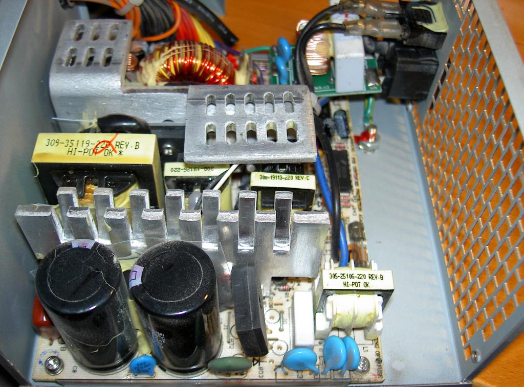

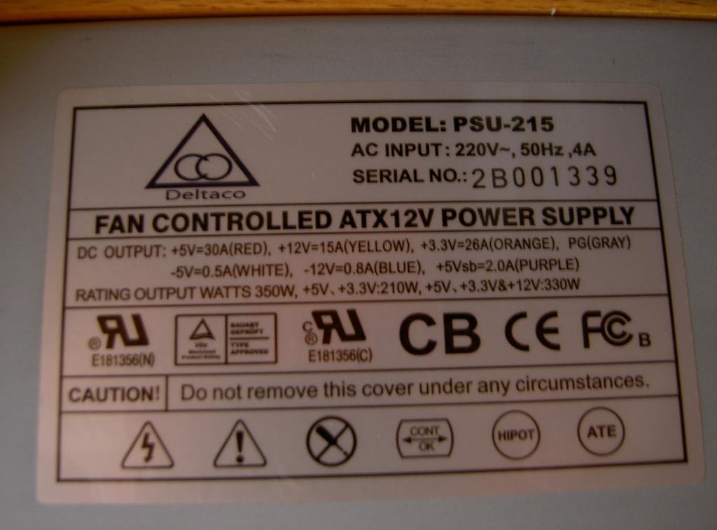

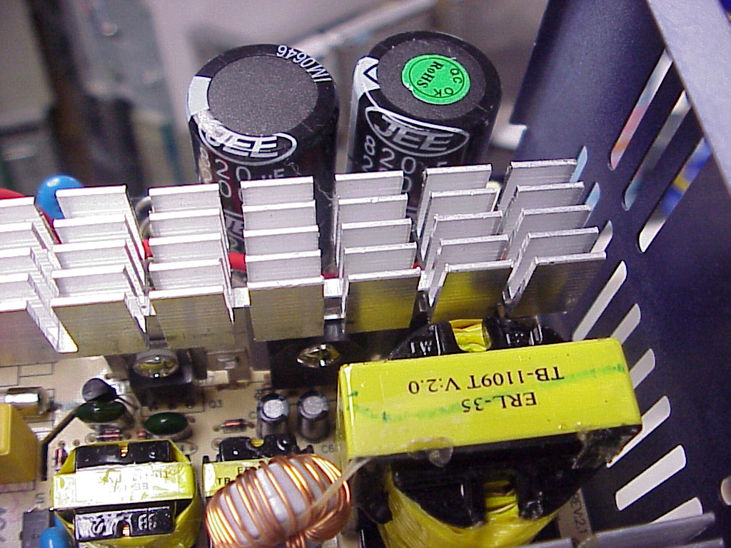

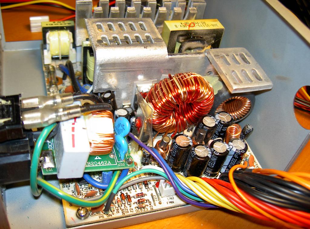

                        Deltaco PSU-215 350w PSU
                        A decent PSU, got two dead comps for free, both with PSU problems... This is the first PSU, it was just a loose solder joint on the filter PCB from the power contact... (The other was a deer POS which I wont even bother to look at...)
                        2x 1000uF 16v & 4x 2200uf 10v United caps on secondary side. 2x 680uf 200v on primary side. (unknown brand)

                          #252
                          I thought Del Taco is a SoCal Mexican fast food chain. They do power supplies too? Seriously, the label says 350W, but 250-275 looks more realistic (given the large fan; otherwise 200W-225W).

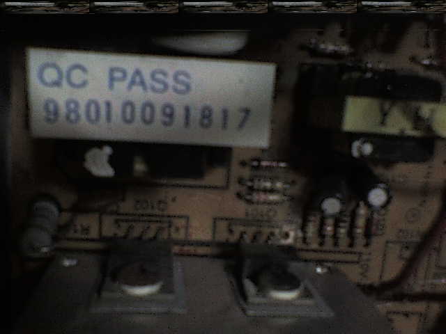

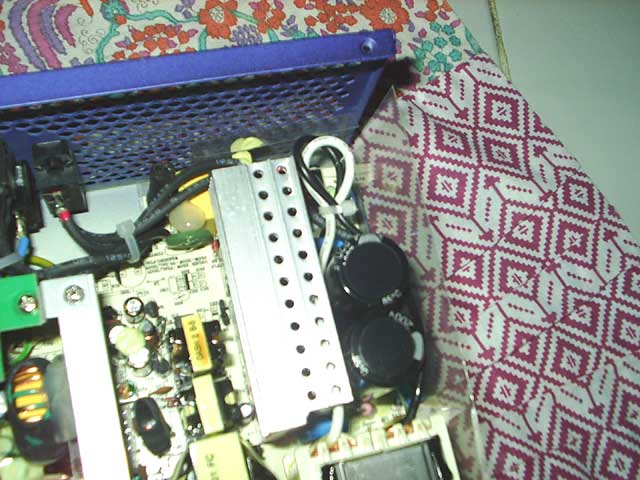

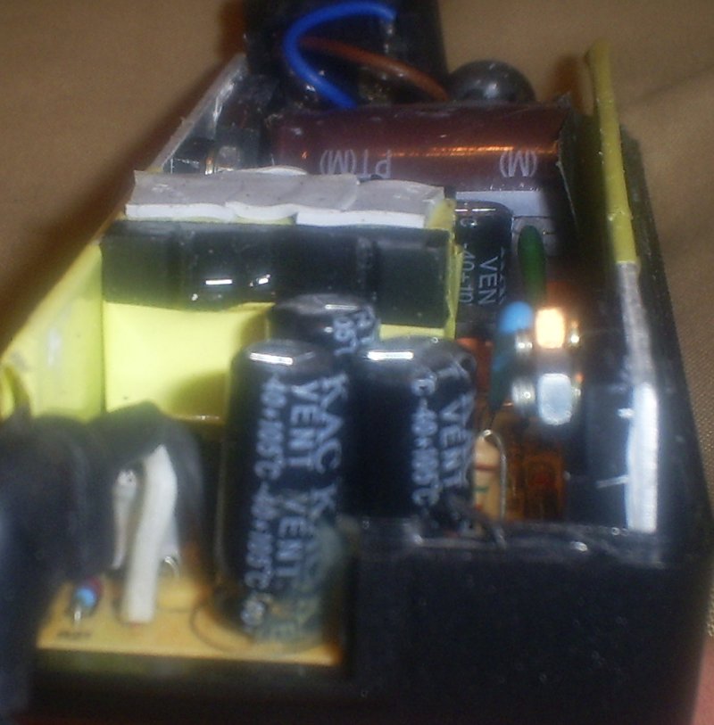

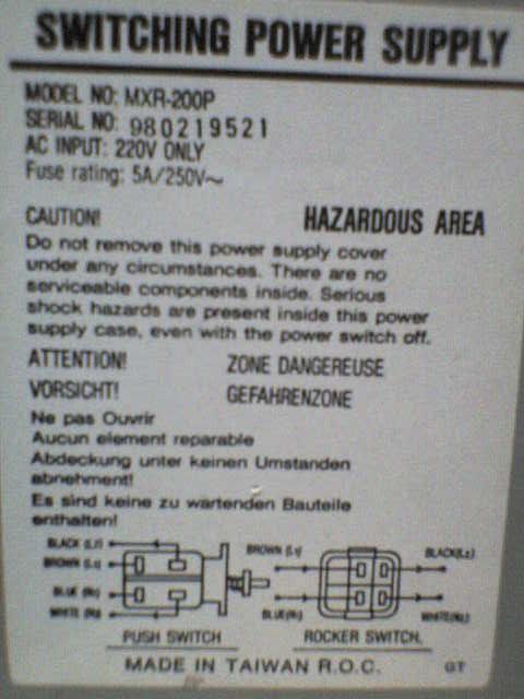

                                MXR-200P AT PSU
                                Pulled this one from a Pentium S 150 Mhz unit with a 1mb VGA Card; 10/100 mbps land card (Realtek), 2 1.44 FDDs. Its 12v rail was only giving out 9 volts!!! Capacitors are "EVATOP."
                                BTW, sorry for the lousy pics this is the only digital camera of a sort that I own. :-(
                                Interestingly enough when i Google the model no. it came back to Badcaps. :-)

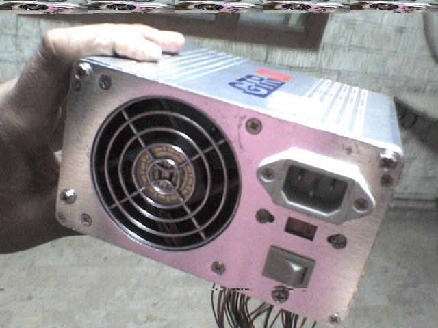

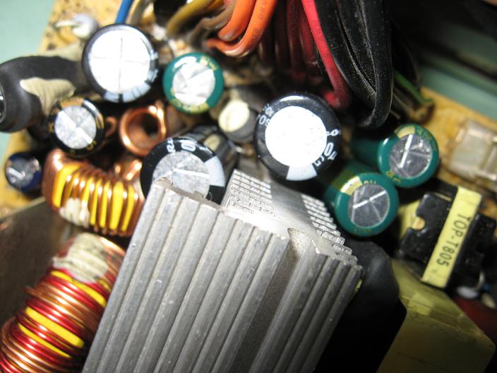

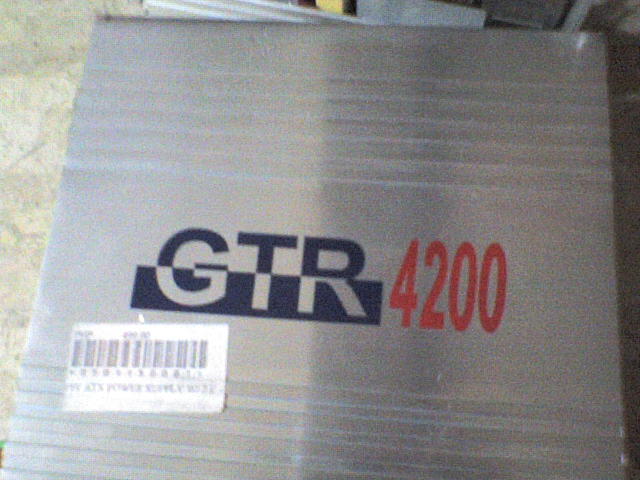

                                  GTR-4200
                                  Yes. That is an aluminum casing. Googled it but found nothing. :-(
                                  Its allegedly a 420w.
                                  Fuhjyuu caps mostly.
                                  Again, apologies for the lousy pics.

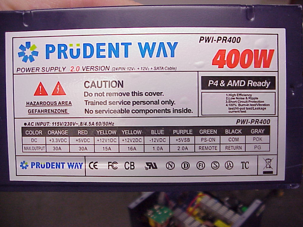

                                    prudent way "400"

                                      note also known crapcaps and line-ground caps without ul,csa, rating

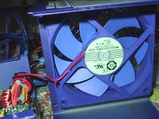

                                        2themax HE370PRO
                                        • Techno Pride
                                          • Apr 2007
                                          • 11
                                          #260

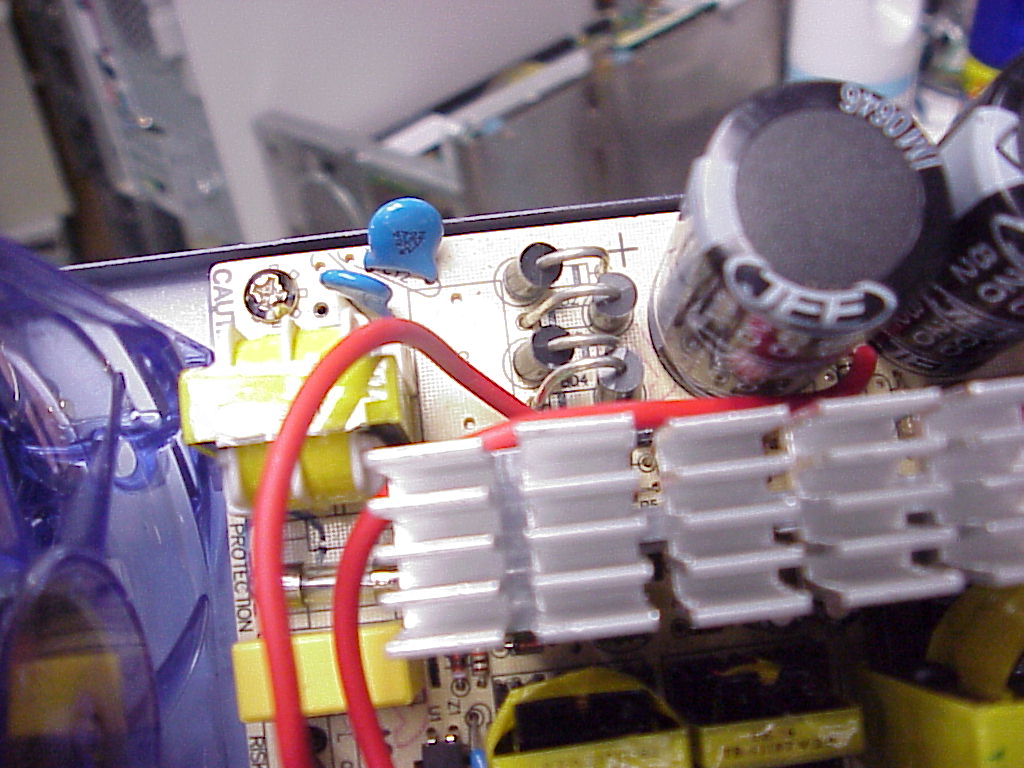

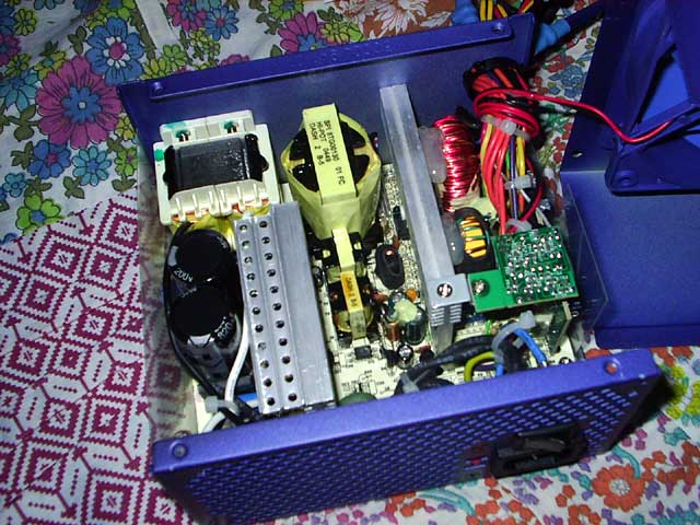

                                          FSP Bluestorm 350w w/ Passive PFC (FSP350-60THN-P)
                                          FSP Bluestorm fanswap
                                          I swapped out the noisy fan for a 1200rpm max fan the moment I got it. The quiet fan is connected to the PSU's onboard controller. This has been running with a quiet fan for over 2 yrs. It has been in service in a casing with very low/bad airflow. I opened up the PSU a few days ago. All caps look fine. Never regretted the purchase!
                                          Here are the pictures.
