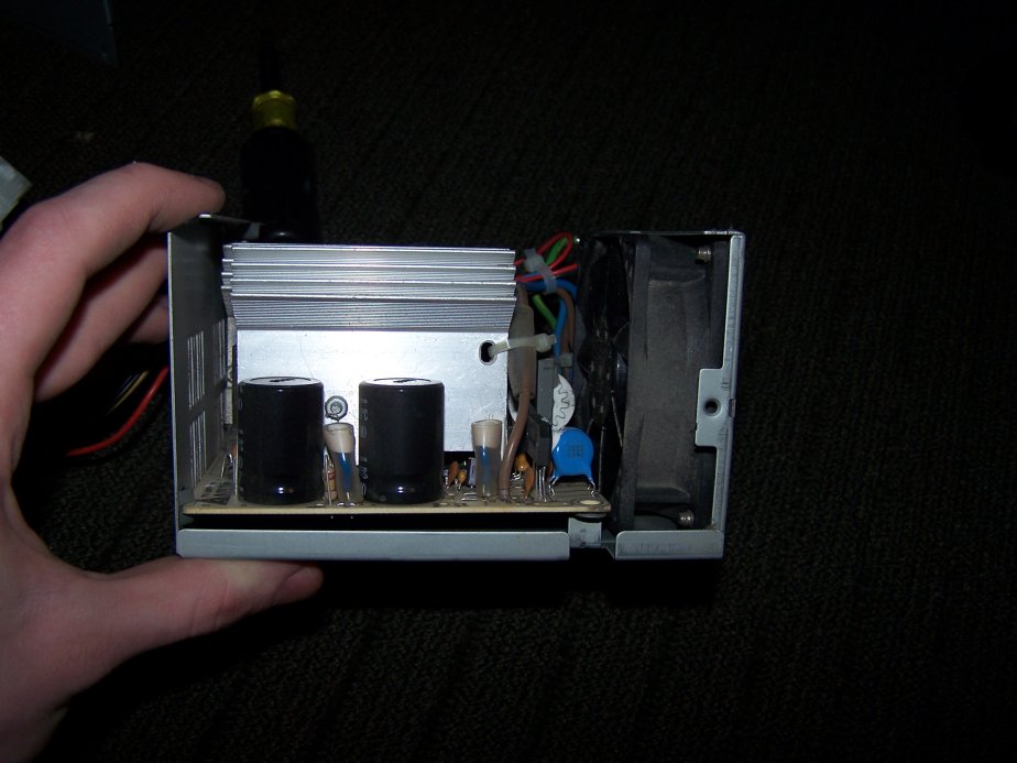

    Re: Power supply build quality pictorial

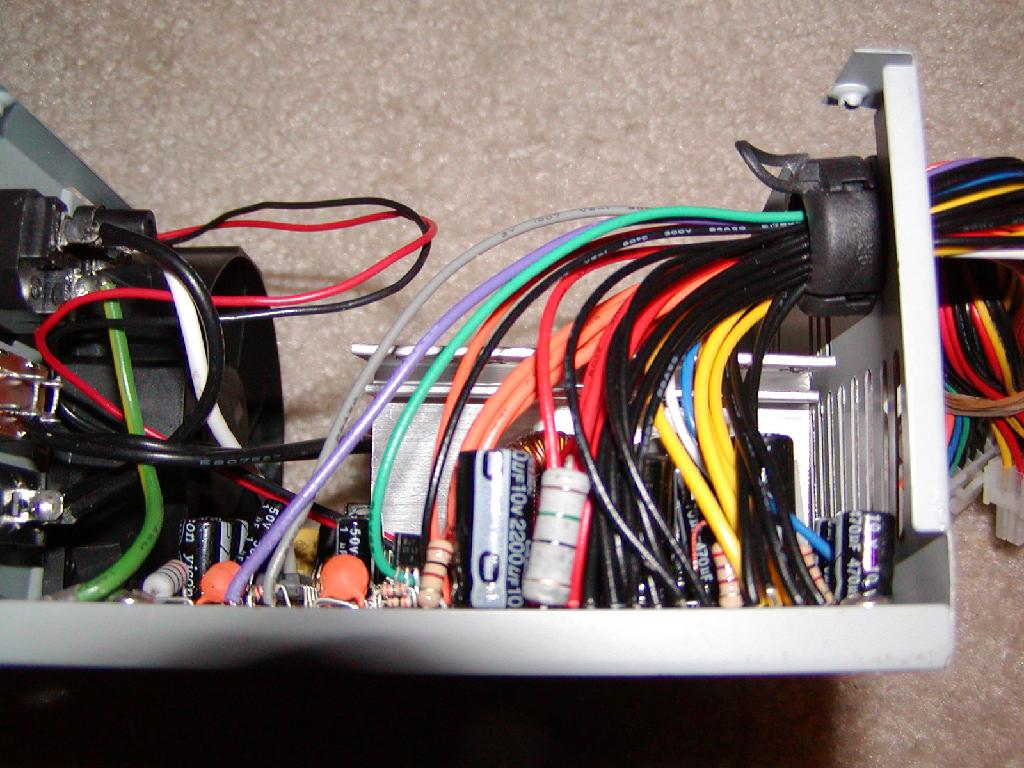

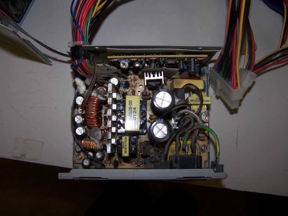

    Delta DPS-200PB-86 145w ATX supply (no aux connectors) (Compaq OEM)
    PSU is quite old... this is a Pentium II 333mhz machine. Board says Delta on it, plus it's a typical Delta PN. No problems with it at all. Uses Chemicon and Nichicon caps.

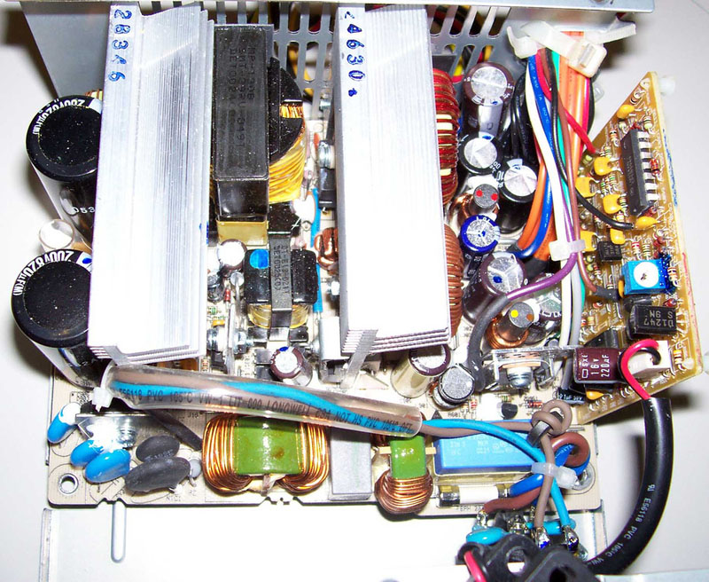

    • dood
      Deputy dood
      • Mar 2004
      • 2462
      #42

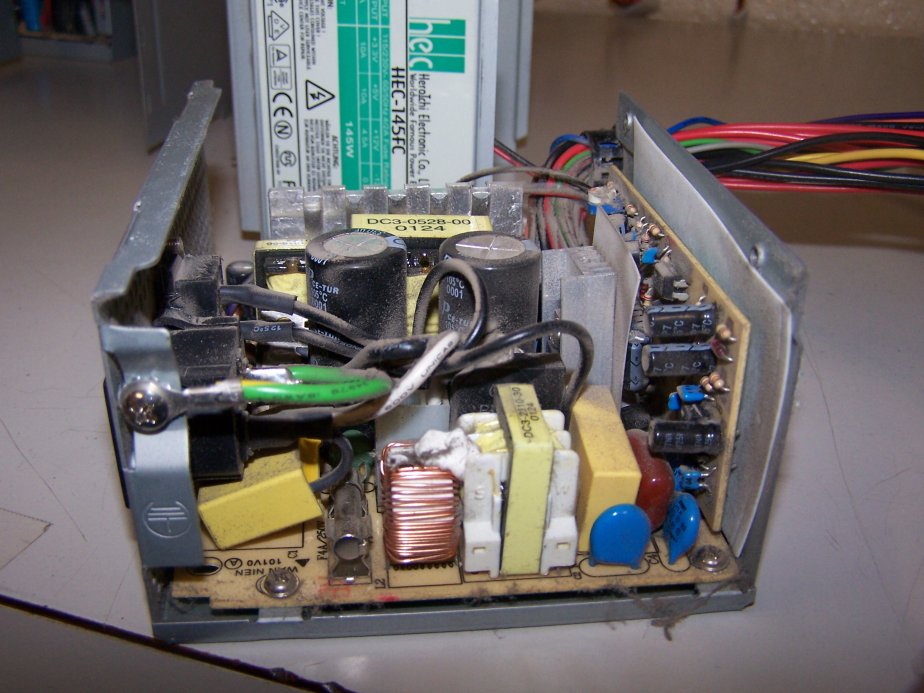

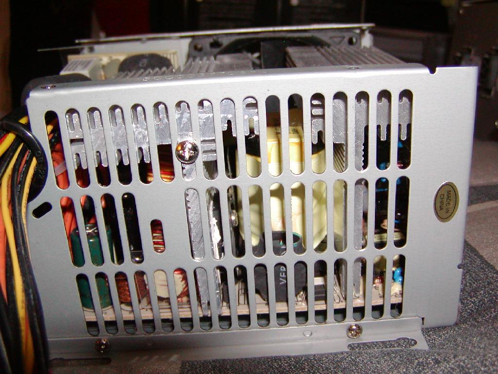

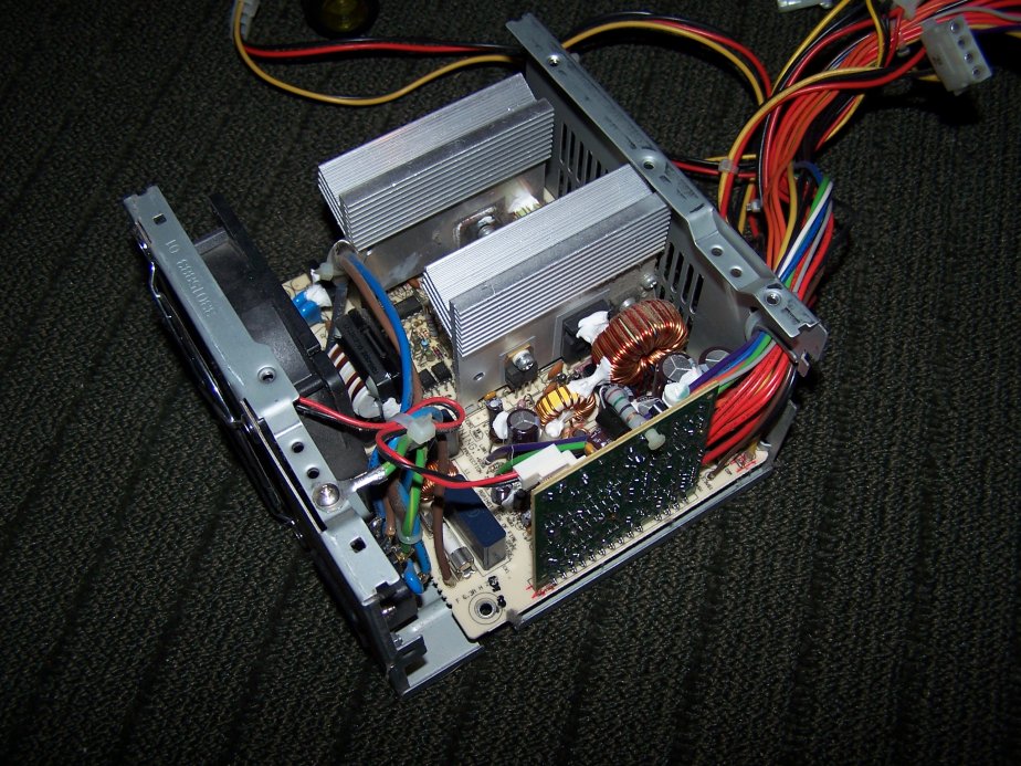

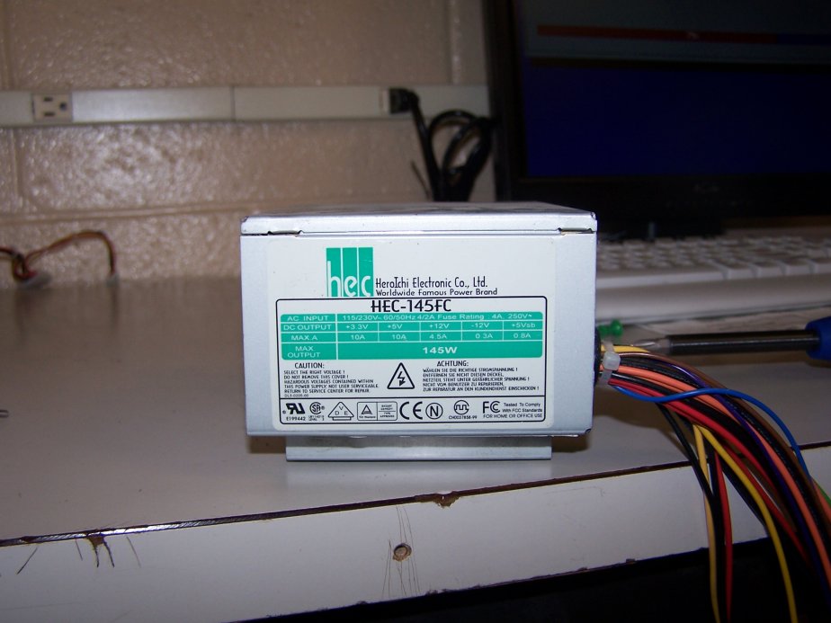

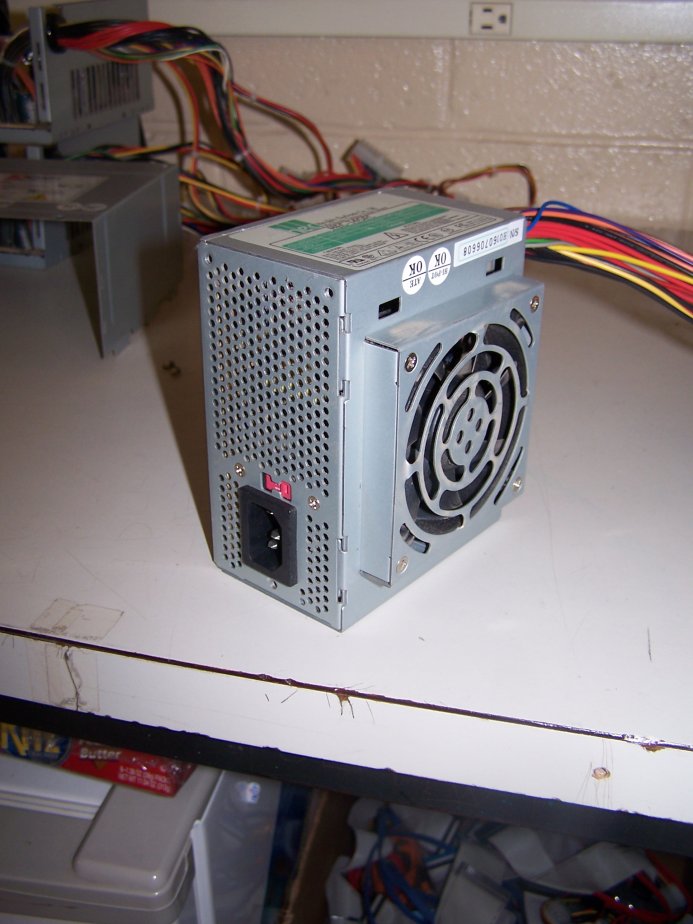

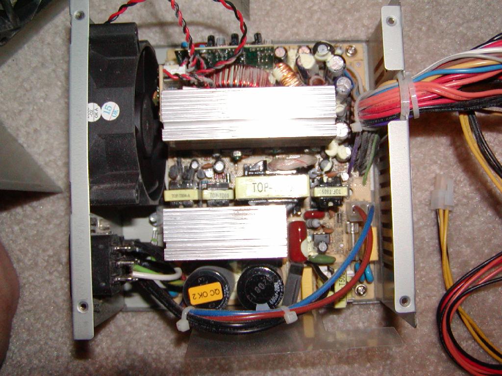

      HEC-145FC 145watt MicroATX (no aux connectors)
      I'm including this one to compare to the above MicroATX supply... A more "normal" chassis design in this one...
      PCE-TUR caps all over.
      Ludicrous gibs!

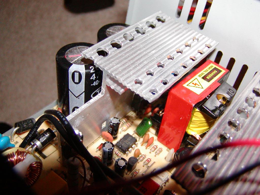

        #43

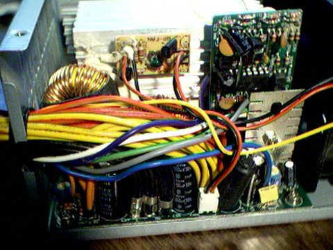

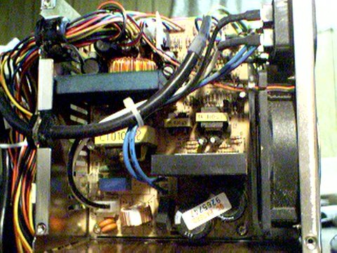

        Falcon Technology PE-250X (circra 1998) - CapXon, Su'scon and Viva caps, as well as 2 JP CE-TUR 200V 470uF units.

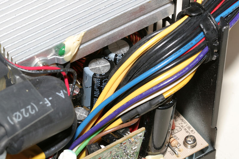

          #44

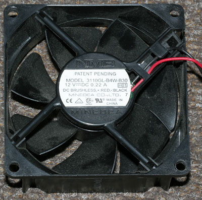

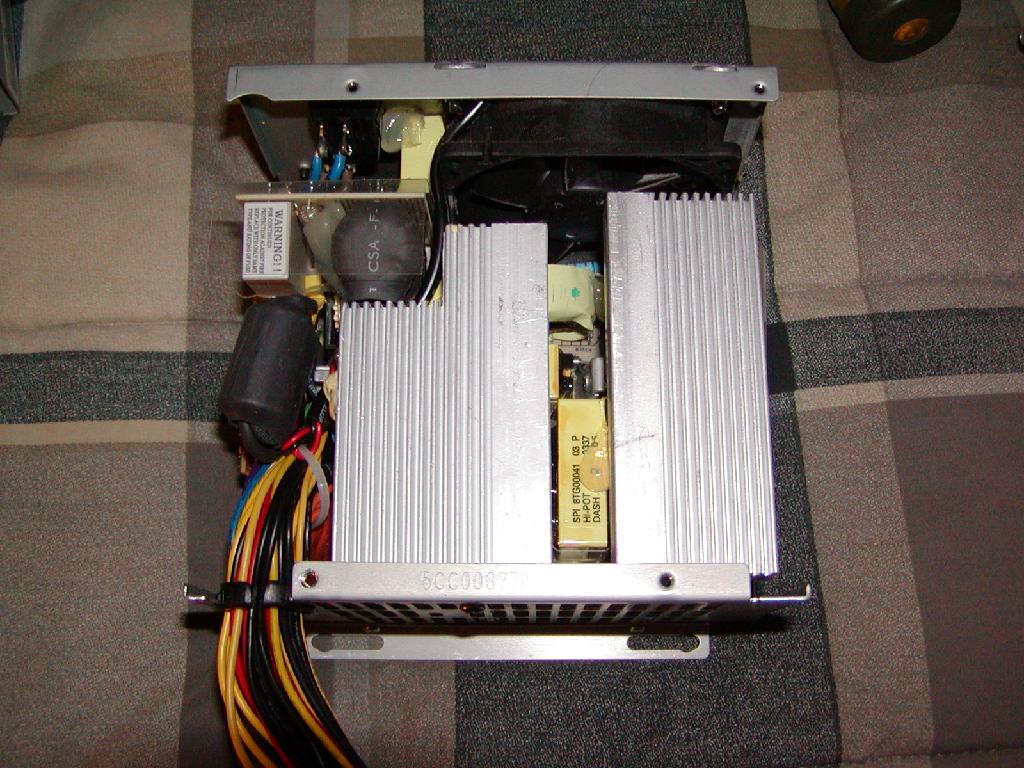

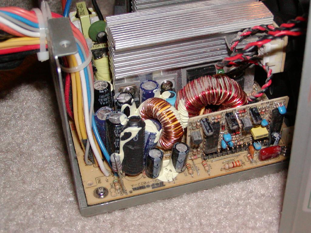

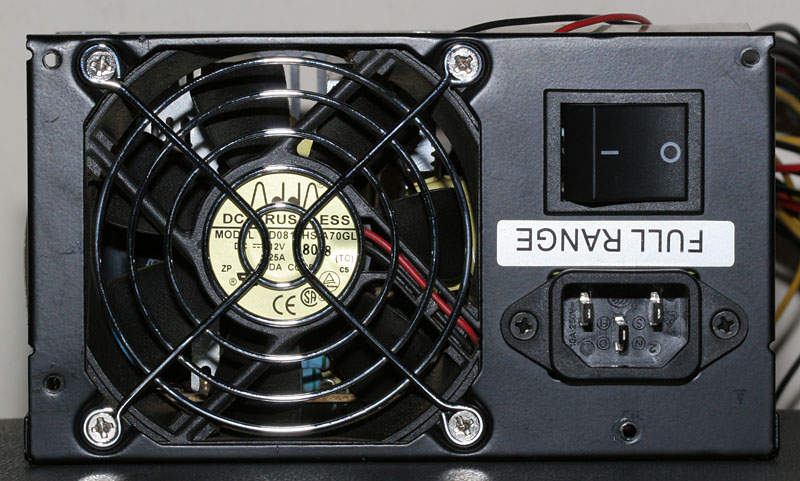

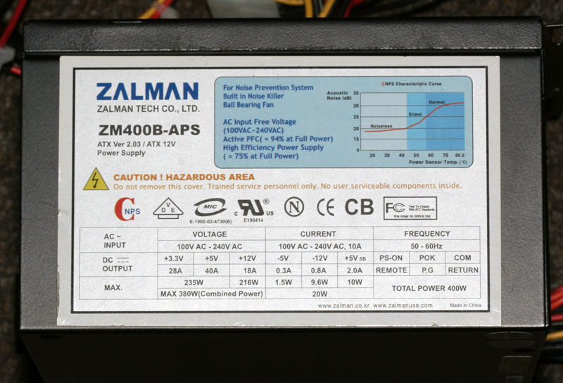

          Zalman ZM400B-APS 400W
          fan is not original....original fan shown removed

            #45

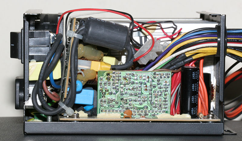

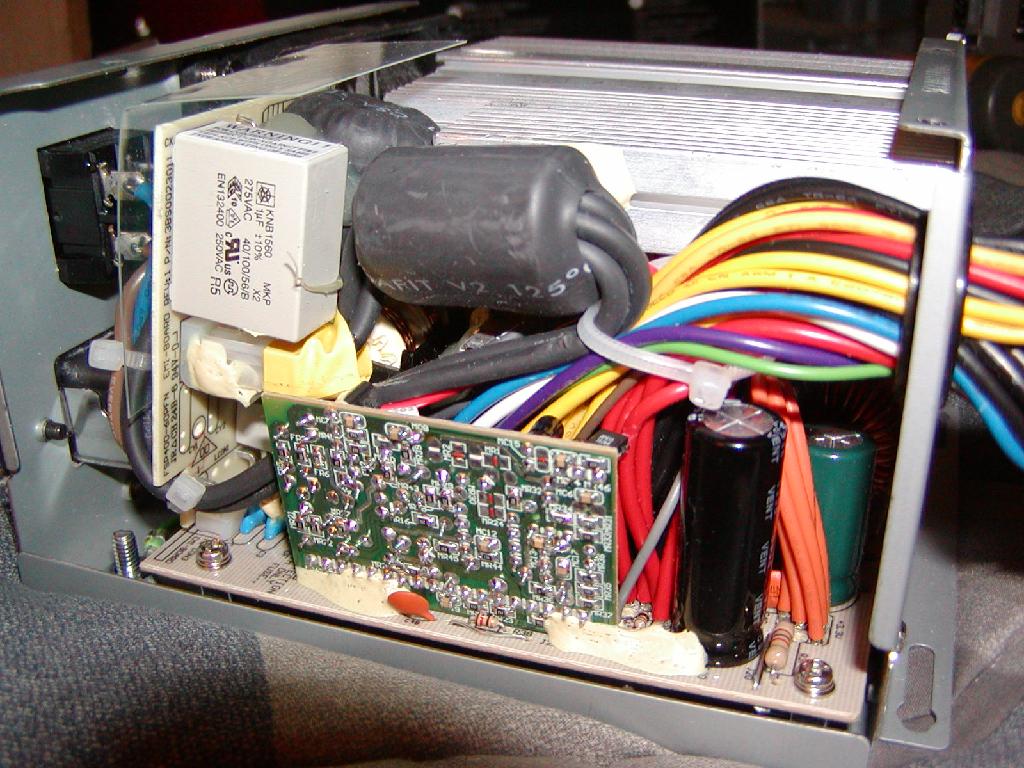

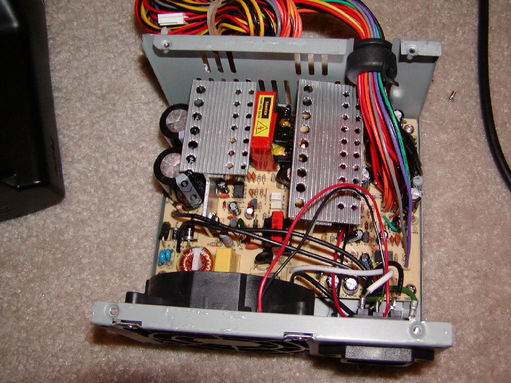

            more pics

                #47

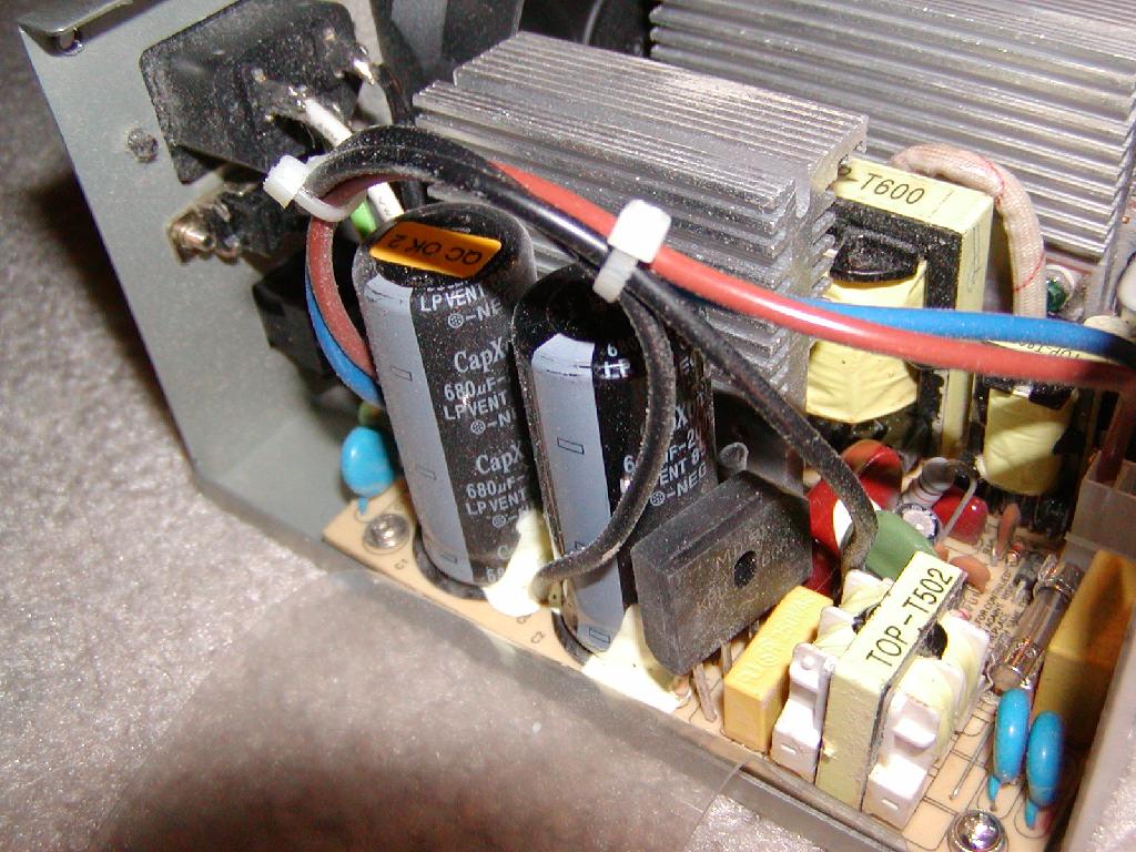

                Capxon and Ost RLP

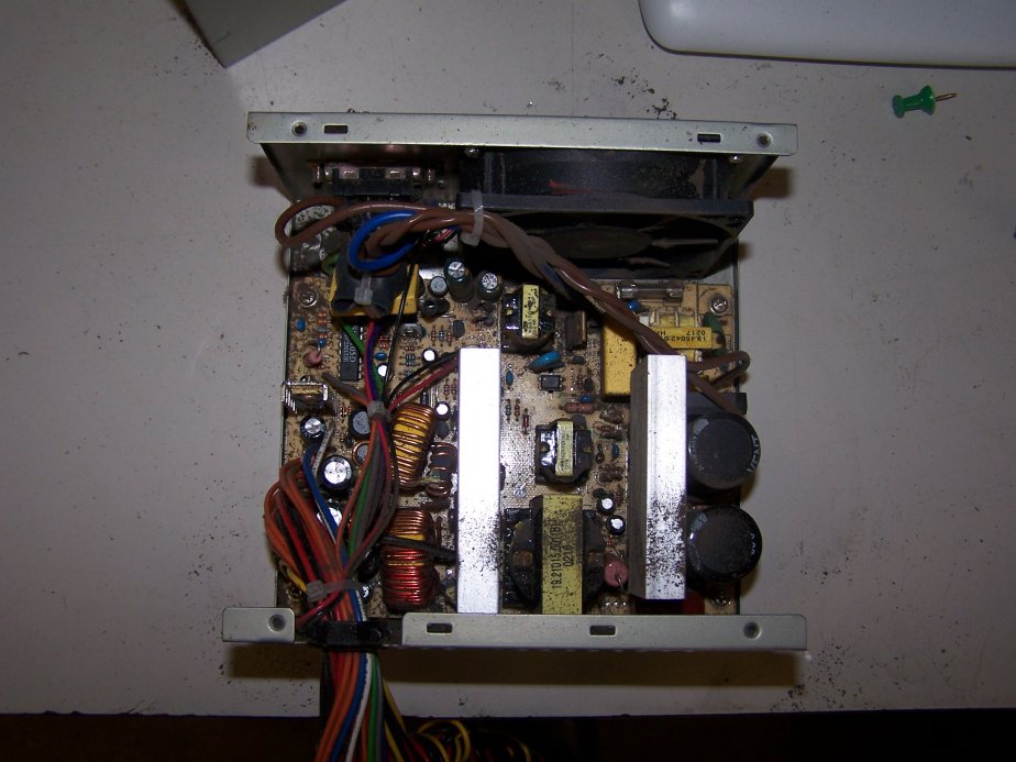

                  • 2462

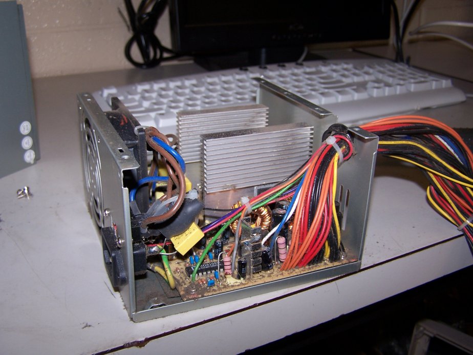

                  #48

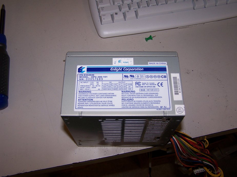

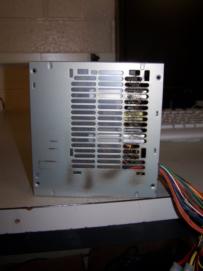

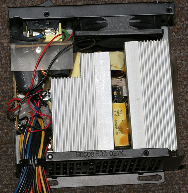

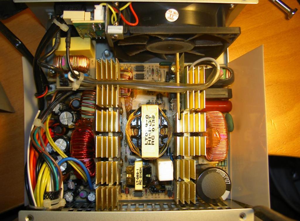

                  Enlight HPC-300-101 (EN-8304946) Peak load 300w ATX +12v
                  Notice the plastic sheet that makes the air enter at the opposite end of the PSU for optimal cooling from the single 80mm fan
                  Dirty... this one came from our welding department... nasty stuff.
                  I see Jenpo and Teapo in here...
                  Ludicrous gibs!

                    #49
                    The enlight is a High Power built unit.
                    can you guys start posting only two pics per post, so if you had 6 pics to post you would make 3 posts. This will help to load the pages faster as they will have less images per page. The pages break on number of posts (i think it is 15 posts then new page)

                      #50
                      Those Falcon and HEC units look like someone forgot to install the heatsinks.

                        Capxon and Ost RLP

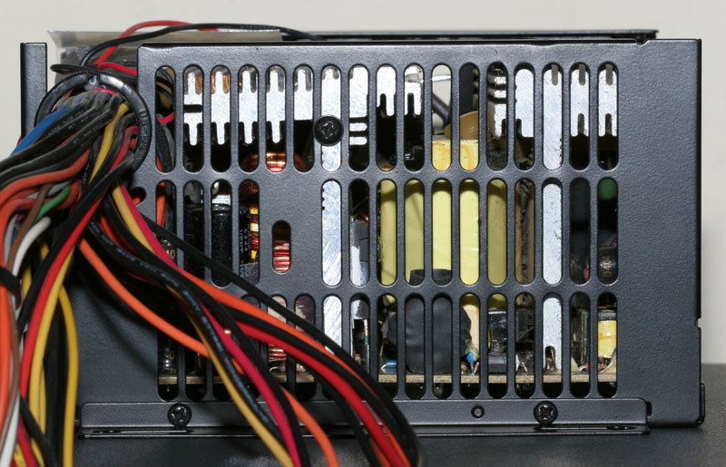

                        Very interesting - that Zalman is a Fortron built unit, but I'm used to seeing those with all Teapo on the secondary side since they're an old design. Must be relatively recently they moved to OST/Capxon.

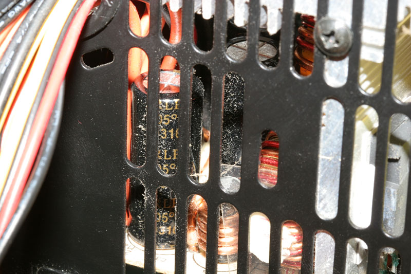

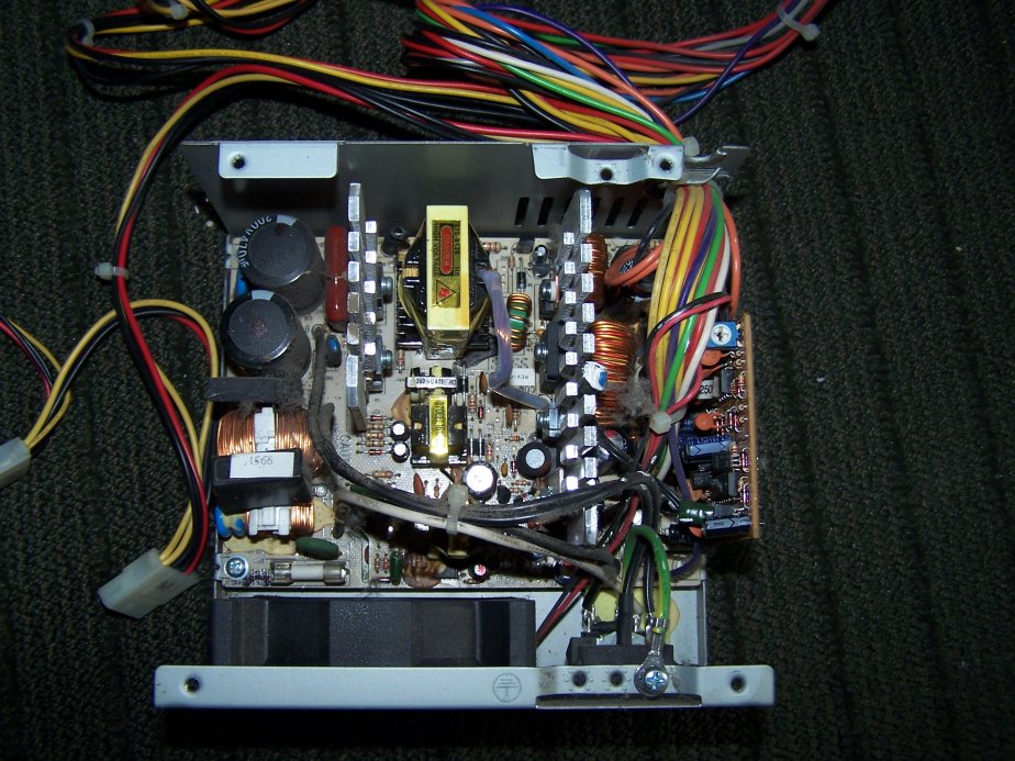

                          Fortron FSP400-60PFN. Its got a single Hitachi cap on the input and a combination of Teapo and CapXon on the output.

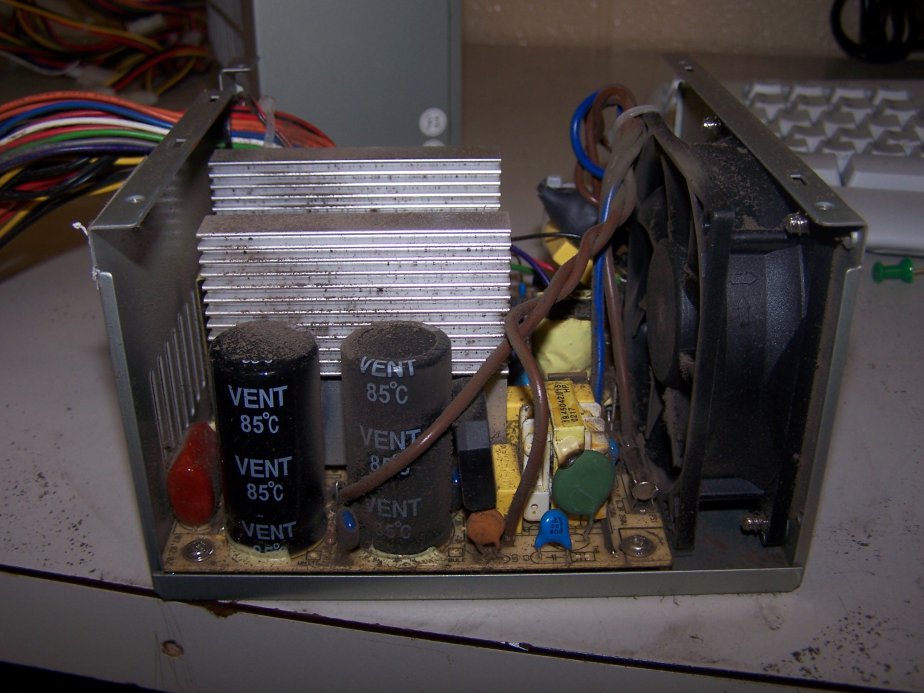

                            The diametric opposite, of the above (unbranded Generic 450W pulled out of a cheap case... after opening it looks like a Leadman LP-8860) loaded with caps from the netherregions. Not a single brand I recognize... TS brand 470uF caps on the I/P and a combination of TEK, Yicon, and Chmec on the output. This one is rated higher than the Fortron 400W I posted above... looking at the insides, makes me think twice.

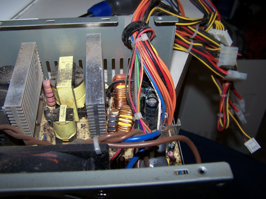

                              Topower TSP-350P4 (350W). CapXon on the Input side, and an all Fujiyyu lineup on the output side.

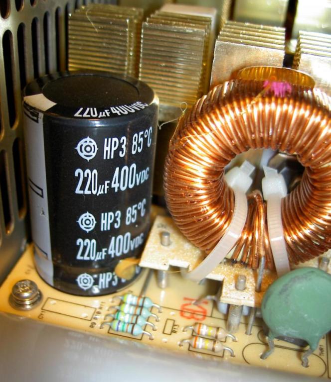

                                • Per Hansson
                                  • Jul 2005
                                  • 5895
                                  • Sweden
                                  #56
                                  Enermax EG365AX FMA, 353w, +5v 32a, +12v 26a, +3.3v 32a. +5v & +3.3v 185w max. 220uf Hitachi primary cap, secondary side Pce-Tur, no bulging after years of use...

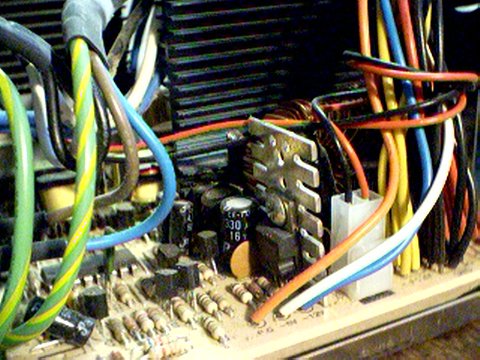

                                    #57

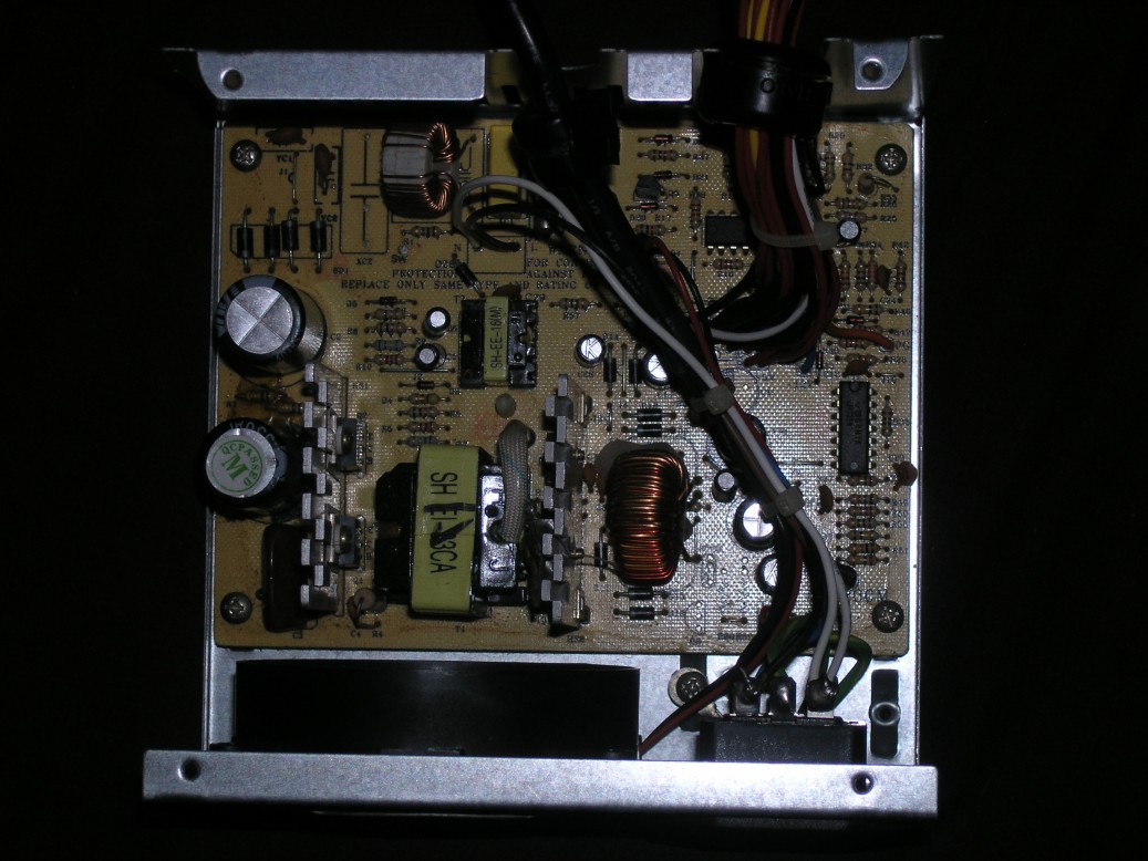

                                    Hipro HP-250NLXAK Max output 250w ATX (no +12v)
                                    Teapo main caps, Su'scon output caps, two of which are bulged and leaking. Has been in service for a few years...

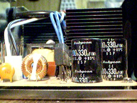

                                      Delta 300W DPS300-BB. Rubycon, Chemicon, and Nichicon caps:

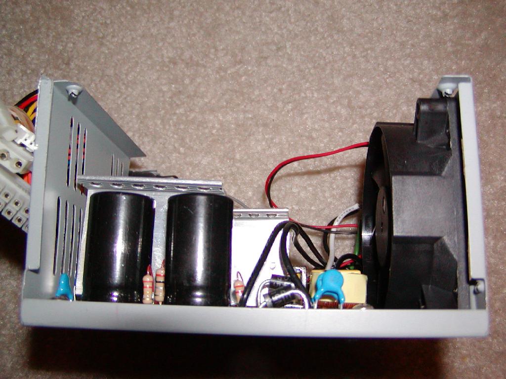

                                        Vogue (rebadged Deer) 230W AT unit, manufactured July 2000. Viva primary caps; the rest Rulycon (my first real sighting of this brand!) and one CapXon.
