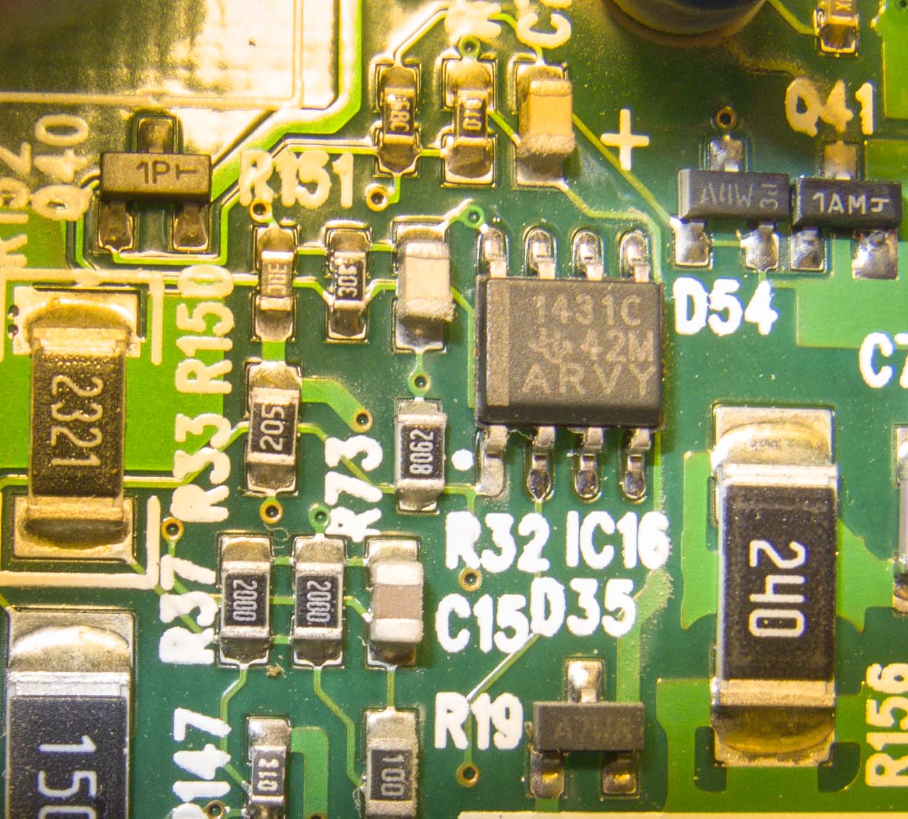

      Components were burned in my APC RS-1500, but I can not read their values . There is a board diagram of the board?
      The components are D35, Q41, R73, R37 (I can't read)

        arielleon305,
        Photo attached...
        D35 = "A7W"
        Q41 = "1AM"
        R73 = "2000"
        R37 = "2000"
        My board is labeled 640-0253E in the bottom right corner (when the big transformer is in the upper right).

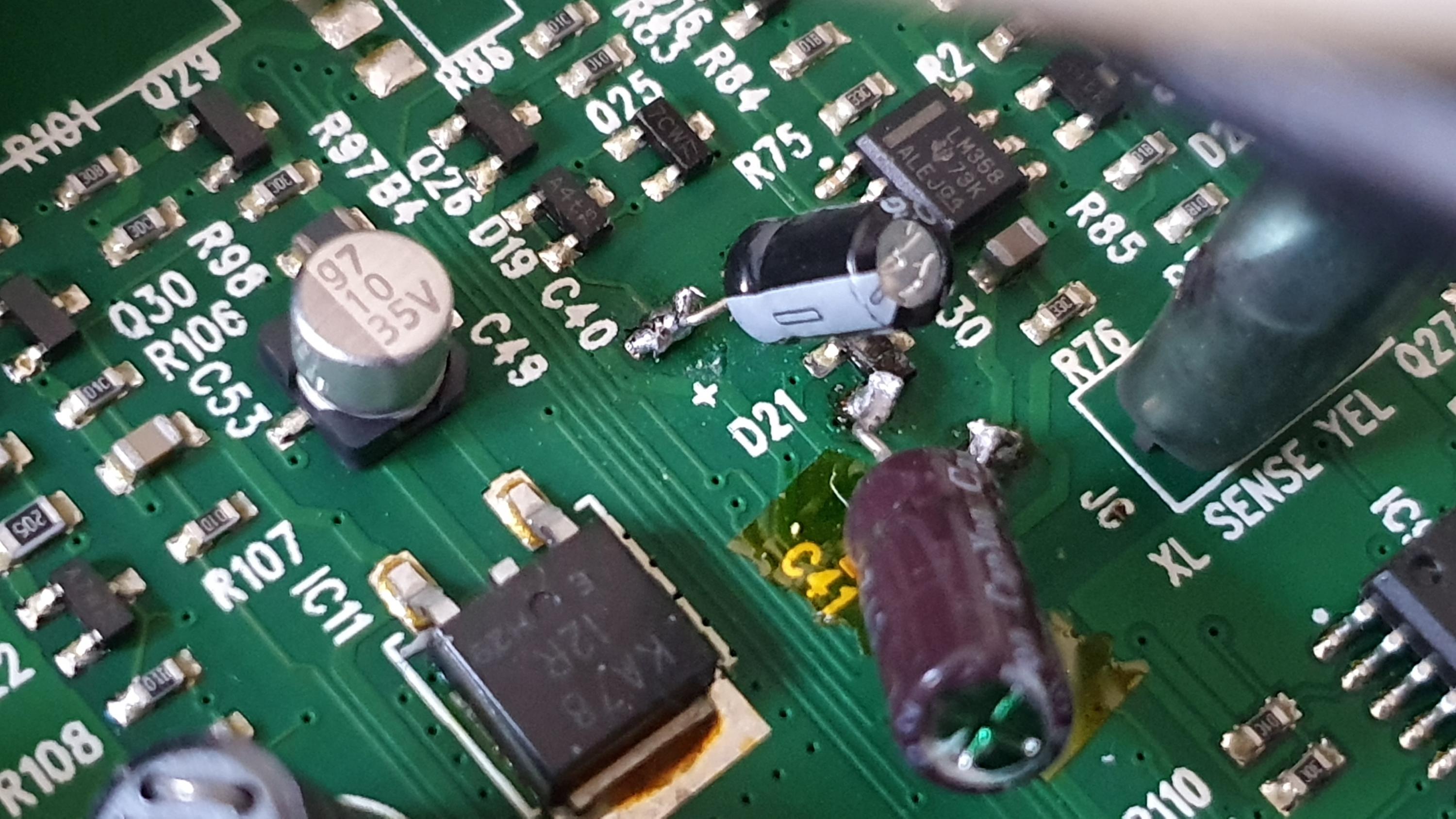

                          I know this topic is a little bit old but I think this could help. A common problem in the BR1500 model is that two surface mount aluminium electrolytic capacitors (C40 and C41) responsible for the -8v supply to the line sense circuit is marginal or failed. On mine, they read correct 22uF value but fail on ESR test. Replacing either or both of these should fix the on battery always or constant switching to battery.
                          I also have a PDF of the schematic for the board model 640-0253E. I don't know about this forum's policy though. APC has shut down sites providing schematics in the past.

                            Back-UPS XS 1500 was repaired by replacing all 22uF SMD electrolytic caps. There are five of them and they were reading anywhere from tens of ohms to infinite ESR. Symptom was failure to charge battery and eventually failure to power on at all emitting only a chirp on attempt.

                                    A common problem in the BR1500 model is that two surface mount aluminium electrolytic capacitors (C40 and C41) responsible for the -8v supply to the line sense circuit is marginal or failed . . . Replacing either or both of these should fix the on battery always or constant switching to battery.
                                    Thanks. My APC was immediately switching to battery whenever turned on. I replaced C40 & C41 as you suggested and it now works fine. Thanks again.

                                      Also another thanks to you all, I used my Ungar heat gut to locate the caps last week, and Just wanted to confirm that you were right, when I heated the caps with the gun It works fine, cooling them off with the Freeze mist = Fail, So we are in agreement, thanks again. Peace

                                          And I found this thread! I opened the unit and saw that C41 was already manually replaced (with a higher voltage one). I bough the unit as new and nobody opened it ever. I replaced C40 and yupppyyyy! now everything works! I used a 50V one to prevent it from burning again too soon... maybe it helps.
                                          I noticed that the marks for the polarity on motherboard are reverse to the ones on the capacitor (check attached). That is the "+" sign on the motherboard goes with "-" sign on the capacitor. I am not a specialist but I noticed this on the replaced one and I did the same.
                                          I didn't had a hot air tube to heat the old damaged capacitor in order to remove it so I just cut it off with a clipper.
