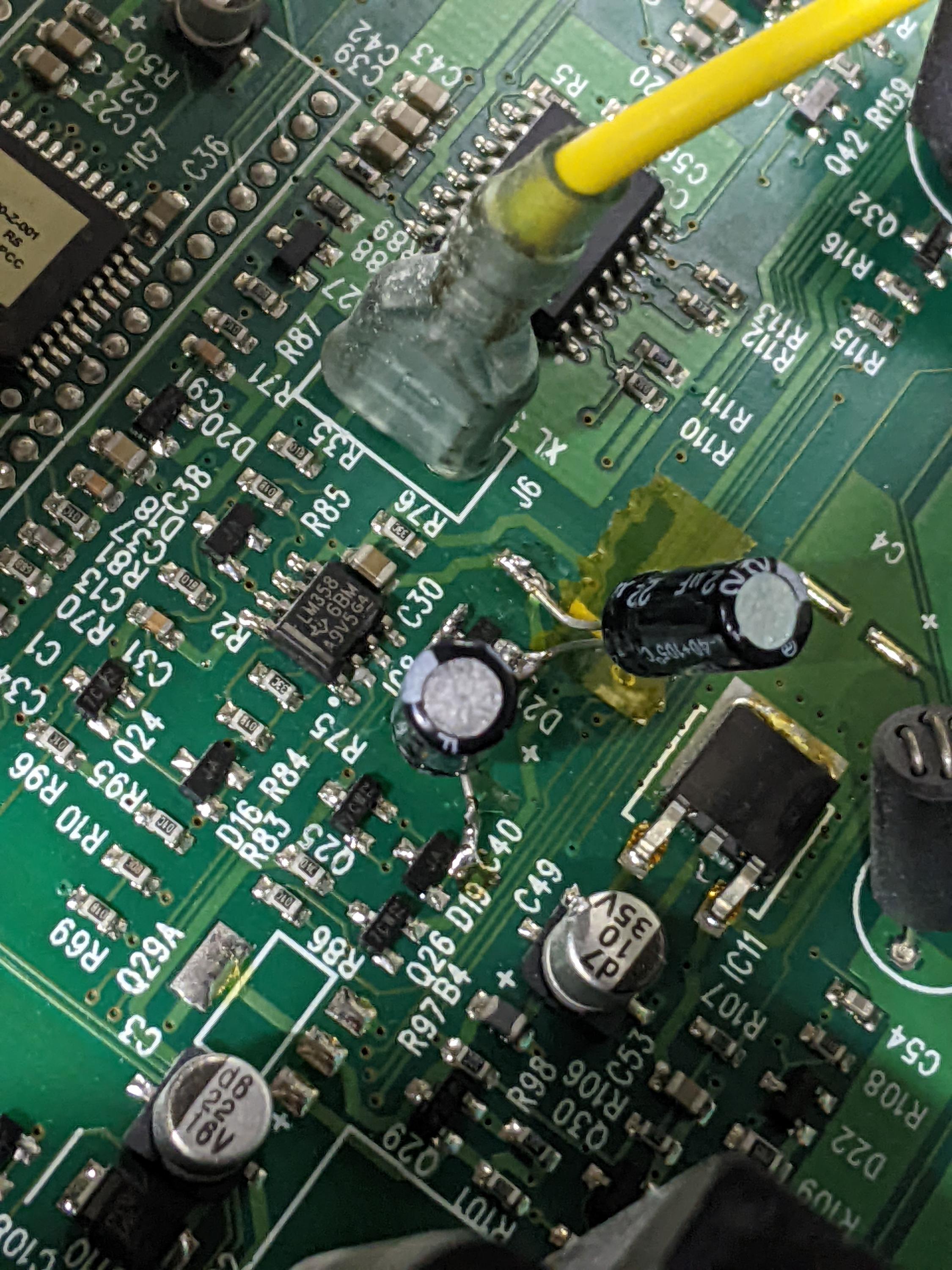

      I have this unit also and found this post some weeks ago because I had the exact same problems. The UPS would only discharge and not go back to charge mode when the power came back.
      I replaced the C40 and C41 and everything seems to work like a charm now. I only did it a few hours ago so I can't tell if it works permanently but given the other posts above I feel comfortable.
      I can confirm equalizr458 on, that the former post picture of sundance has the C40 reversed.

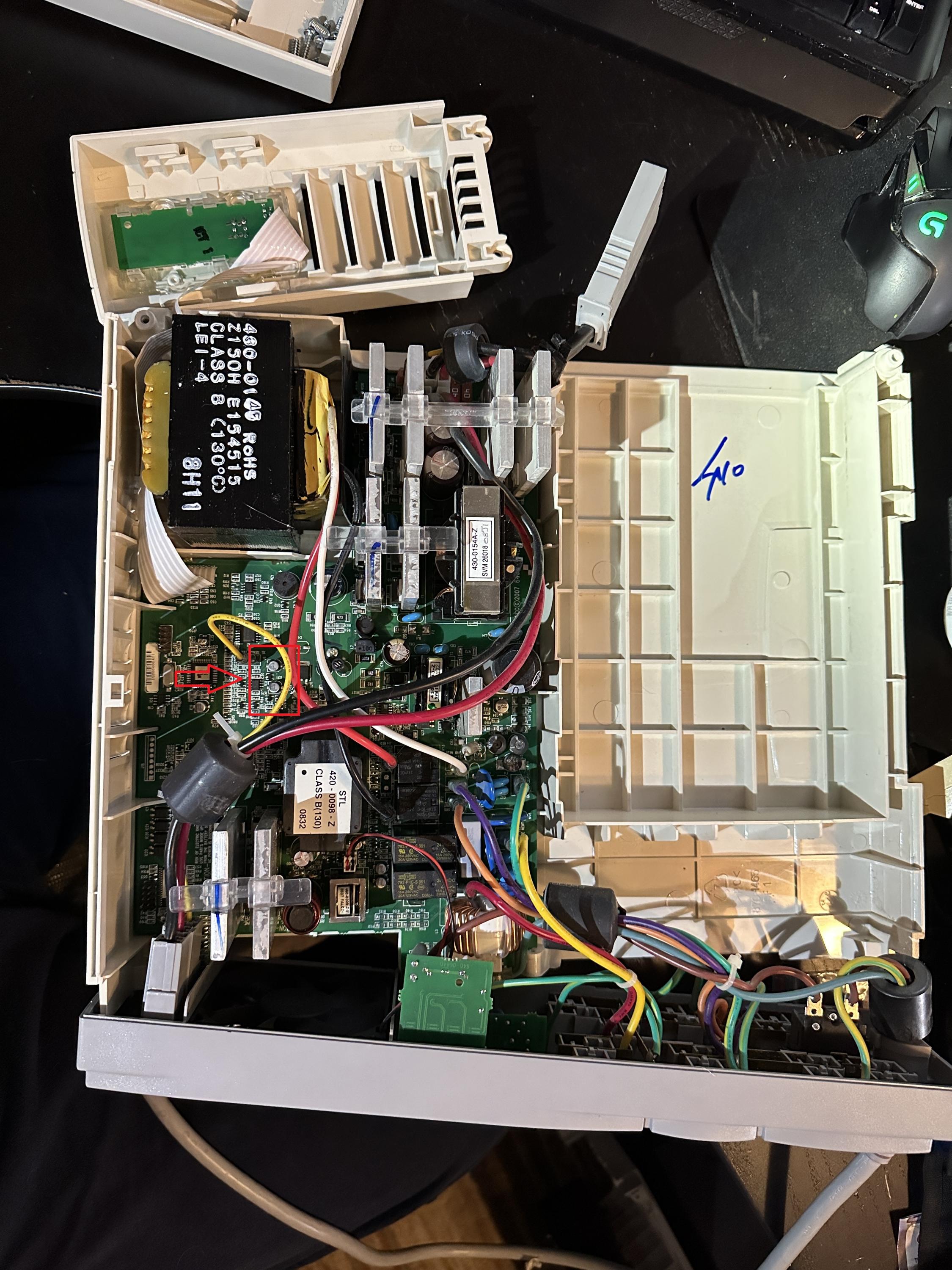

        Greetings All and great thread.
        My unit is a BX1500 not a BR1500. Appears to be similar family and both are included in user manual. Not sure if repairs of this thread apply but I'll put this out there.
        Board is 640-1019A_REV05
        The box has never had to protect against a surge, no blown out components I can see, no visible trauma, just an older box I bought brand new.
        I found C40 and C41.
        C40 is a Jamicon 22uf 63v
        C41 is 470uf 50v 80deg Celcius
        There are 6 more 22uf 63v at C2, C3, C19, C20, C42, C71
        There are 4 caps of 47uf 50v at C18, C21, C23, C60, C63
        Clearly I could get quite busy replacing caps.
        Do you recommend I focus only on C40 & C41?
        Or should I expand that to replace all 22uf 63v caps?
        Any other insights/advice?
        Thanks!!

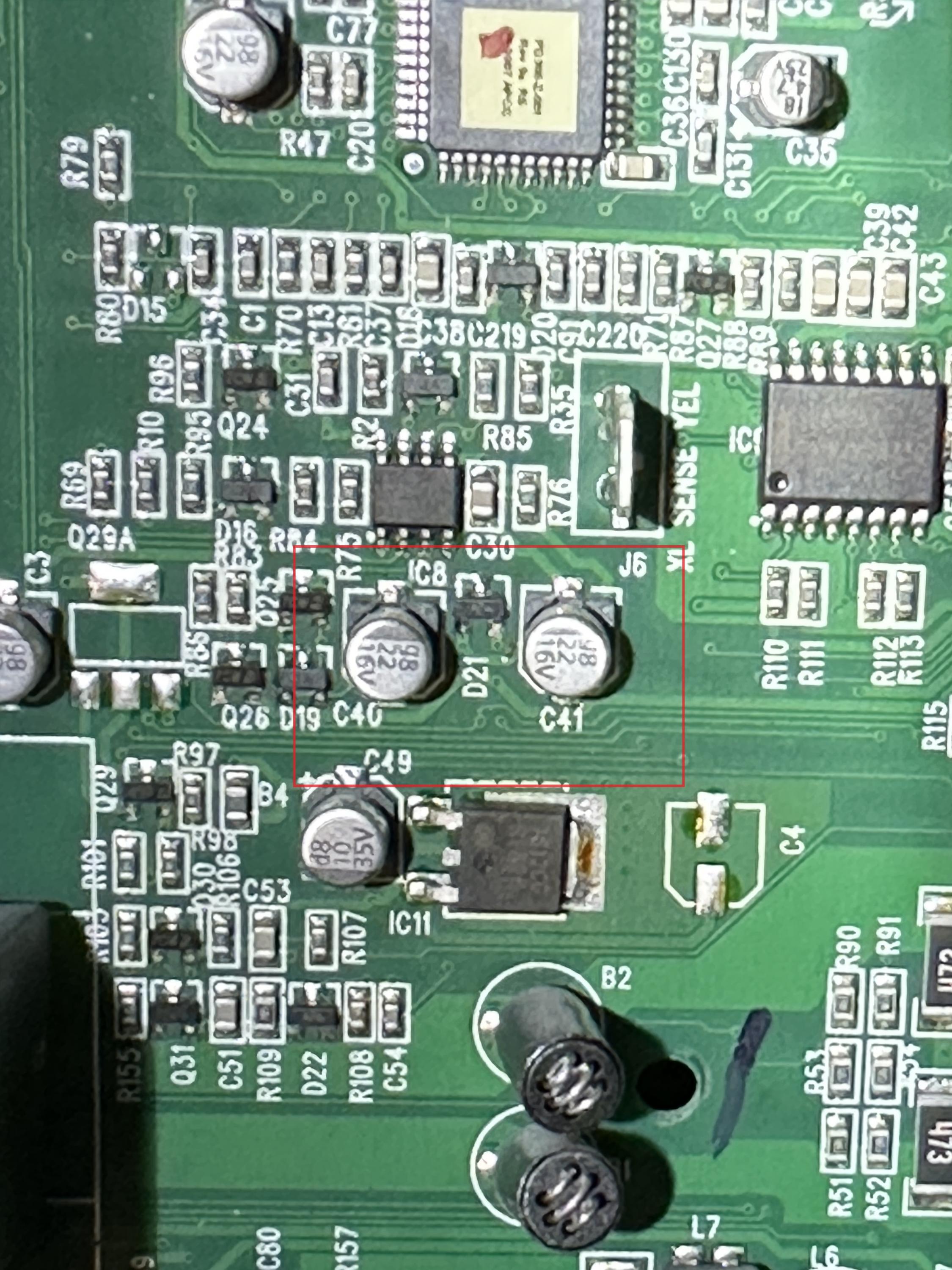

            Re: APC Back-ups RS 1500 Dead
            Not sure if this helps but I found an image of the same board and labeled C40 & C41.

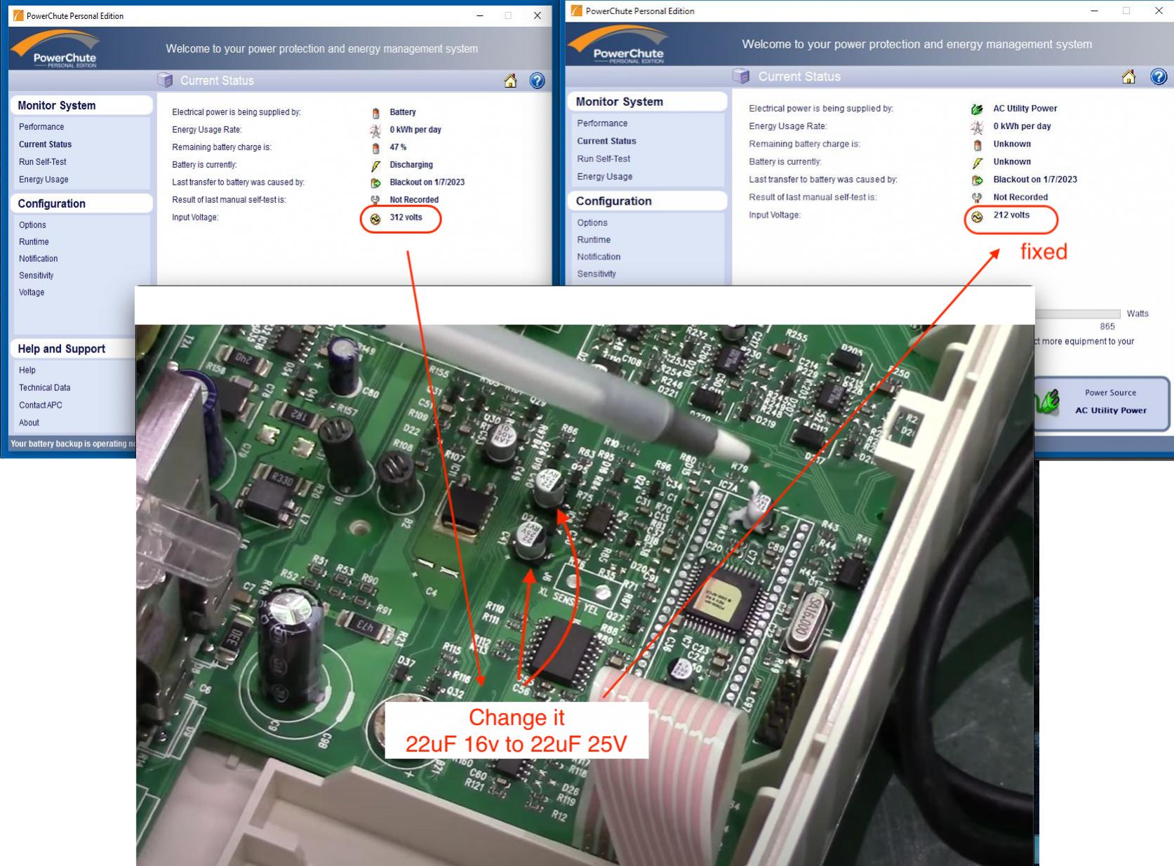

                  I know this topic is a little bit old but I think this could help. A common problem in the BR1500 model is that two surface mount aluminium electrolytic capacitors (C40 and C41) responsible for the -8v supply to the line sense circuit is marginal or failed. On mine, they read correct 22uF value but fail on ESR test. Replacing either or both of these should fix the on battery always or constant switching to battery.
                  I also have a PDF of the schematic for the board model 640-0253E. I don't know about this forum's policy though. APC has shut down sites providing schematics in the past.
                  Thank You. Another APC backup ups RS1500 saved!
                  Replaced caps 40 and 41. Cap 40 was SMD 22uF 16V replaced with 22uF 25V and cap 41 was bodged thruhole 22uF 16V replaced with 22uF 25V. Ups works great.
                  Simptoms were as folows:
                  Always on battery
                  Used software power chute V3.1 to check device, device was reporting voltage 188V instead 232V so it were in protection mode.
                  After replacing capacitors device reported voltage corectly.
