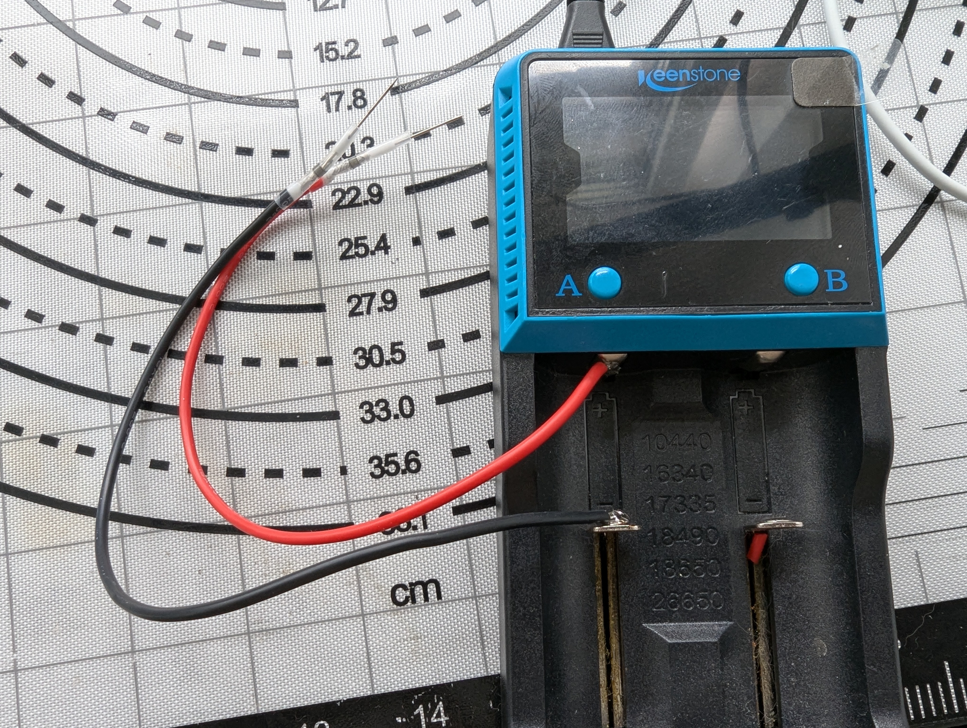

    sometimes i'm in need of a charger / tester for very small batteries and even if my multimeter doesn't show anything there is a chance that a smart charger helps to revieve. I'm happy with my Keenstone smartcharger and i made a small mod just to use it with smaller batteries like in smartwatches or even camera batteries with special contacts.
    Soldering wires on the charger contacts and using needles as probes. I covered both with a shrink hose with integrated solder.

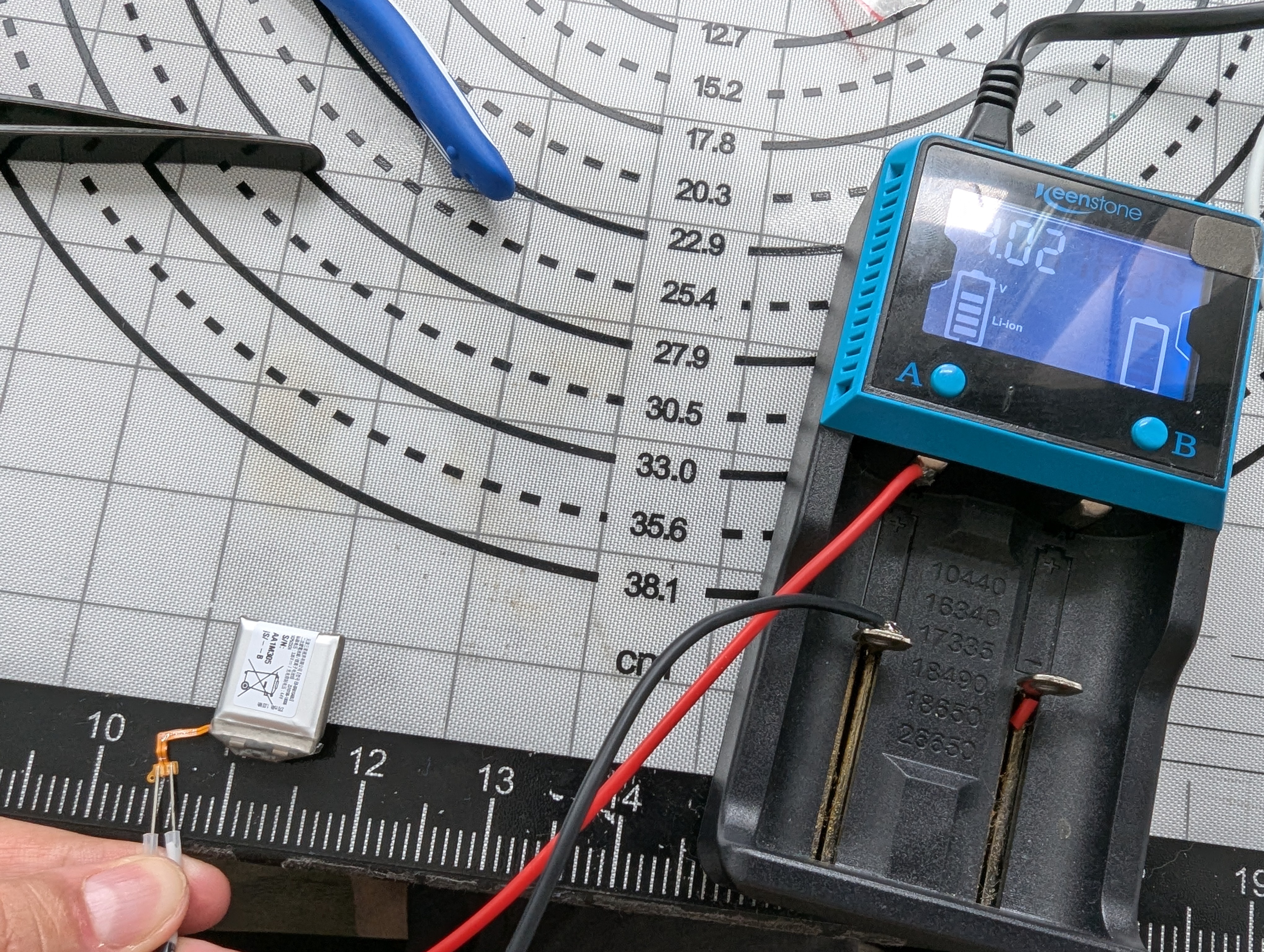

    My first work was to bring my Samsung watch battery back to life with was not recognized anymore by the charging station of the watch.

    thats tacky,
    i put a pair of 4mm sockets on my charger
    • CapLeaker
      Leaking Member
      • Dec 2014
      • 8340
      I just use my bench PSU?!
