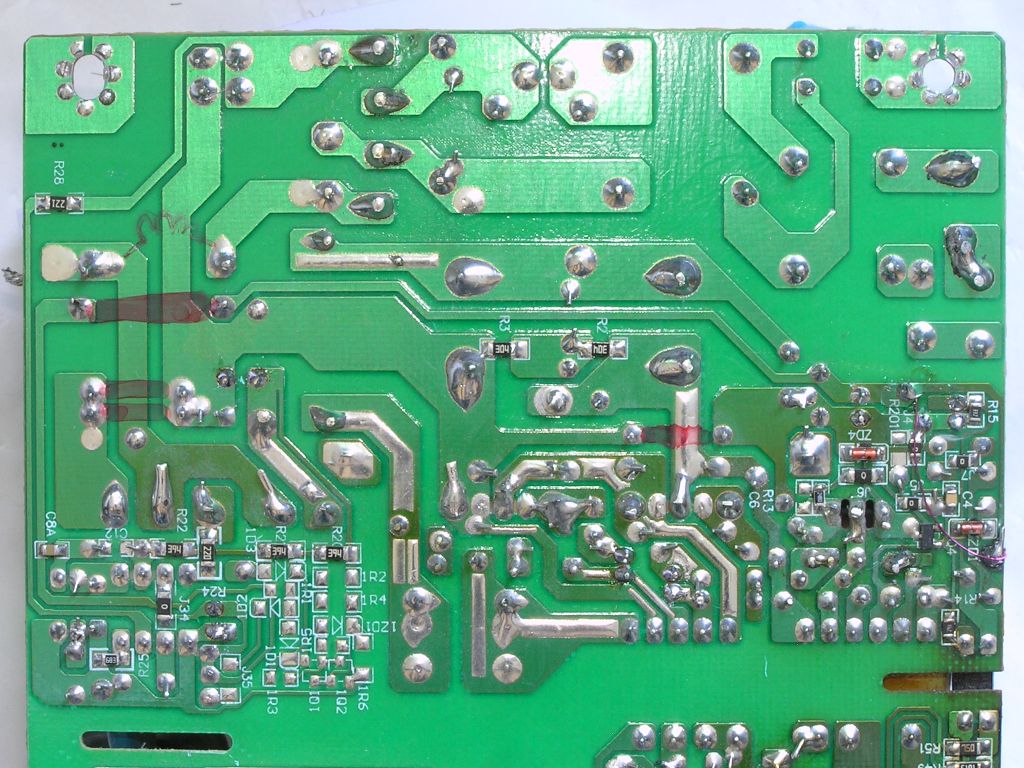

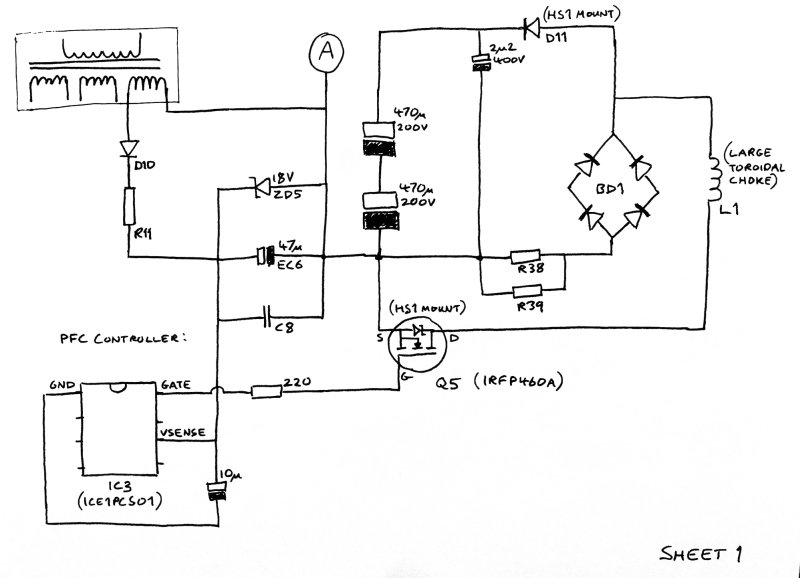

                Sorry to resurrect an old thread, but it seemed like the most appropriate place. I have a SP-450 from a Sonata II case that recently died. It is amazing it lasted so long - I got it 2nd hand and have been using it for over 5 years. There were obvious signs of electrolyte leakage on several of the fuhjyyus.
                Anyhow, in addition to some capacitors, a resistor and a zener diode on the primary side had failed. The resistor had burnt the PCB badly (see photo), and the zener was acting like a short. I was able to get a replacement zener (1N4746) but the resistor markings were gone. It measured over 600kOhms, but was obviously a much lower value originally or it would never have dissipated enough power to burn the PCB.
                Would anyone with this PSU be kind enough to tell me the value of R11? See attached picture (ignoring the blue temporary part). The same PCB was used for a few variations, and the photos of similar boards I have found on this forum do not have this part populated. For example:
                https://www.badcaps.net/forum/attach...6&d=1294553638
                https://www.badcaps.net/forum/attach...6&d=1260051418
                Thanks for any info you can offer, even it it just helps me guess a reasonable value

                  I have this supply but no resistor nor zener were ever attached to that area. Sorry.
                  What was the physical size of the burned resistor? That would give a clue as to wattage.
                  Are you sure that was a 1N4746 (18v, 1w)?
                  Is the board marked ZD# or just D#.
                  I ask because the setup looks wrong for a Zener regulator - there's no output/connection from the resistor-diode junction.
                  It looks like a diode with a resistor in line to limit current, coming off a feedback loop in the transformer...?
                  [EDIT]: It looks to be supplying power on the other side of the board to IC3 (8 pin DIP) or IC1. Neither of which are present on my supply, going by my photos.

                    It looks like my board has additional PFC circuitry. I have traced out some of the circuit and attached it. If you don't have IC1 and IC3, then I'm guessing you don't have the large choke L1 either (see attached photo). Also note on my diagram: R38 and R39 are sleeved with heat-shrink, so I can't read the values, but they measure less than the resistance of my meter probes.
                    As Toasty had guessed already, R11 looks like a current limiter. I'm guessing a lowish value which will not be critical. I have attached the datasheet for IC1, but the application example is a bit different to my schematic. I am currently thinking of going with maybe a couple of hundred ohms for R11?
                    The original resistor was about the same size as the blue one I have in there now - probably 0.5W. It is larger than most of the small ones along that edge of the board, but smaller than the large pink one (R48) by the 5VSB output caps.

                      Can you get a photo of the foil side. From above the slit for the opto all the way over to the PFC section. Well lighted so you can see the traces.
                      I am curious as to why the diode & resistor blew.
                      You have IC1 as the MOSFET and mounted to the heatsink? That looks odd...? It's not where IC1 is marked on my board. It's right next to the inboard end of IC3. Are you sure that's not Q5 you're talking about?
                      Top down with the mains caps to the right:
                      IC3 is the 8-pin DIP
                      IC1 sits directly above it
                      Q5 sits to the left on the heatsink
                      Your schematic needs adjustment of those designations.

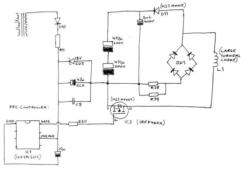

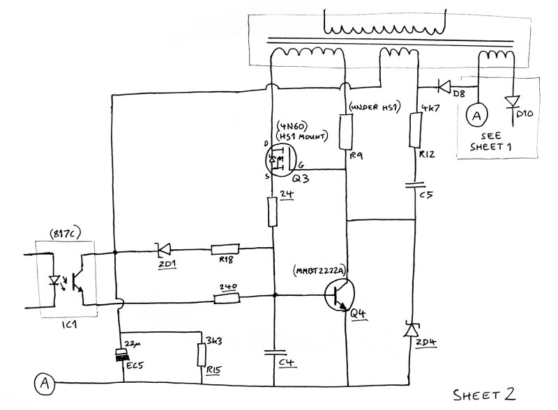

                        Toasty, you are right, those designations got a bit mixed up. An edited schematic is attached. IC1 was actually 1C1, and is presumably the capacitor next to IC3. The real IC1 is the opto.
                        Some more schematic attached: underlined means SMD
                        Trace side image attached: Marker pen and link wire are not original
                        EC5 had dried up and measured 0.04uF

                          Any expert insight into why the resistor and zener could have gone?
                          I didn't get much out of tracing the extra part of the circuit connected to the failed cap EC5. I have very little experience of this kind of circuit, so it is difficult for me to see what is going on. It is clear that if ZD5 were to go short circuit, then R11 could dissipate excessive power, but I don't know if failed capacitors in other parts of the circuit could cause ZD5 to fail.
                          @Toasty: if you have C4, would you be kind enough to measure its value? (In circuit should be fine). I have managed to destroy my C4

                                    So a couple of years have passed since I sorted out my SP450 (see my previous posts in this thread). I meant to wrap up back then, but better late than never. Unfortunately the motherboard in that system failed a couple of weeks after the PSU. A capacitor had clearly vented, but on closer inspection a number of capacitors on the board were badly bulging after it had been fed nasty power from the SP450. I replaced 8 capacitors on the board and it went back into service. Both the SP450 and the motherboard are still in service today!
                                    For the SP450 schematics that I started sketching out, I found I had made a mistake tracing the circuit in sheet 1. I'm afraid I'm not going to correct it now, as there may well be other mistakes (e.g. it seems like L1 should be inline with the supply, not across it). The transformer winding that feeds D10 and R11 actually supplies the power to the PFC IC, not the VSENSE input as pictured. VSENSE is then connected via a divider to the 325VDC as in the IC datasheet.
                                    Regarding R11, my burned out resistor, I found that 280 ohms was much too high for the PFC to work correctly and I ended up using 3.3ohm. For C4 I just guessed at a 10nF X7R ceramic. Most of the Fuhjjyus got replaced with Panasonic FRs.
                                    The PSU was working correctly without the PFC circuitry, as I suspect it had been for some time. After replacing the capacitors, the outputs looked clean on the scope, it just had a horrid power factor. With the PFC circuit working, PF was 0.99 with the system idling at ~100W. I don't know how accurate my power meter is, but interestingly the same system at idle with a Corsair CMPSU-400CX used 75W with a PF of 0.87.
