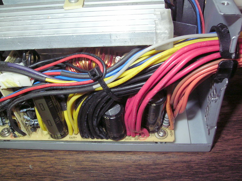

          11 caps
          Gentle coercion of some output coils and wire bundles may be necessary to fit the caps. A little soldering iron applied to allow them to move slightly in their holes either sideways or up a little. The 2200uF at the board edge is the toughest and to get the cover back on.

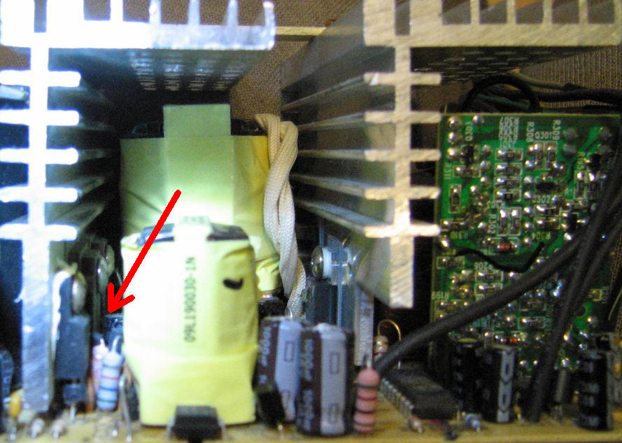

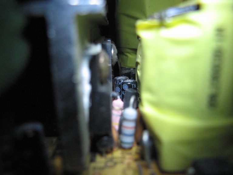

              Re: Replacement caps for Antec SP-450?
              I've met somewhat of a trifle in trying to get to two 4.7uF 50V "TN" caps underneath one of the heatsinks. (Thanks PCBONEZ... You say these should have been TM, I will replace them accordingly)
              As far as I can comprehend, I need to remove the heatsink to get to it. No problem... the heatsink is only held in the PCB by two pins. My problem is that the mofsets are screwed into the heatsink... The only way I can think of doing it is wicking away all the solder from the mofsets pins so that they make no contact with the PCB when I pull out the sink, or using some sort of extreme right-angle philips screwdriver to unscrew the mofsets from the sink...
              Here are some photos to illustrate what I'm speaking of.
                Ahhh....
                Curved or right-angle 6" Surgical Forceps.
                New caps have long leads so putting the new ones in should not be too difficult with those tools. Typically available everywhere. Get the Pakistan made ones not the China ones if you can.
                Time to build up your tool box!
                Also, a stick with chewing gum or similar sticky on the end works too.
                Toast
                EDIT: UCC KY or Pana FC works fine there.
                  De-soldering braid works too. I find that if you remove the solder with the PCB upside down, the cap just falls out.

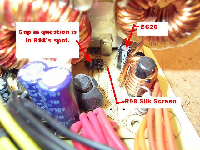

                    There's a cap behind EC26 which is 50V 0.22uF. As I was desoldering it, it fell out and I have no point of reference as to the polarity. Is the polarity the same as EC26 or is it the opposite?
                    EC26 is to the left of all the 3300 caps behind the big coil. It's one of only two 5x11mm caps.
                    If someone can check, I would be grateful. Thanks.
                      This is why we do cap-maps.... hehehehe
                      If this is still about a SP-450 I -might- have one out in the store room I can look at tomorrow.
                      What is the exact model number?

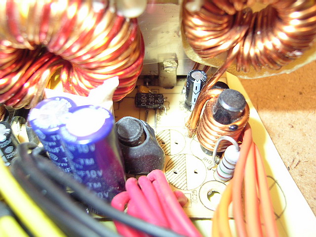

                        This happened *while* I was doing the cap map.
                        Thanks very much. Yes, the model is an exact "SP-450".
                        I've got a $50 gift card with Mouser's name written on it, and I'm gonna order caps for like 6 PSUs I've been meaning to recap for years now. Plus I will put those Samxon RS to use.
                        -Just a correction. It's not one of only two 5mm caps. There are more on the board. What I meant to say that it is one of the two 5mm caps there.
                          I *know* this question came up before somewhere in here. Damned if I can find it now....
                          NEG towards heatsink. This is the 0.22uF/50v cap that was lying on its side, yes?
                            Mine is an SP-450P but that side is the same.
                            The cap in question has negative lead towards heatsink..
                            .. IOW it's reversed from EC26.
                            Interesting that the silk screen for the cap in question looks like a resistor and is labeled R98.
                            Now I know why you didn't just look at the silk screen for polarity...
                                Okay.
                                I have no cap numbers. Just a map with values/sizes. Is it (EC26) the 10uF/50v, 5x11?
                                It doesn't have 3300uF's out there. 4700uF/6.3v are the originals.
                                The only 3300uF (original) is the 16v one next to the fan control board.
                                [EDIT]
                                I know I've done this one before as I have a pre-edited picture ready for it...
                                It is *NOT* a cap I replaced. There is no need.
                                [EDIT #2]
                                ah-HA!! Found it!
                                https://www.badcaps.net/forum/showthread.php?t=8403
                                The reason for not changing it is a few posts after the pic.
                                  Mine has the 4700uF like yours.
                                  Mine isn't laid over though.
                                  It's standing up all tall and perky like a, um, never mind.
                                  Pic should help with the rest.
