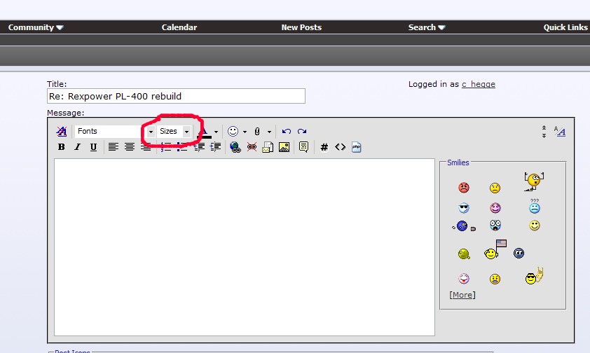

          cool. how did u make the big text are you gonna make a new label for the psu reflecting its awesomeness? like SUCCESSPOWER 700w PSU?
          Here is how you change the text size. I'll just stick with my "C H PC Power MOD-400" Label
