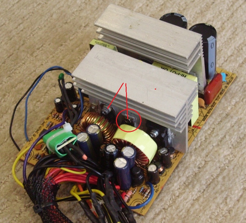

            OK. I powered it on. 5vsb came right up at 5.06v, however, I put it on a PSU tester and nothing happened, no power on, but thankfully, no explosions either.

              #46
              Re: Rexpower PL-400 rebuild
              Did the psu fan move for a second?
              • c_hegge
                • Sep 2009
                • 5219
                #47
                No. Absoloutley nothing happens on the tester. Fan doesn't twitch or anything.

                  #48
                  Since 5vsb is there, see if there is some voltage on the PS-ON signal. There should be close to 5v I think.
                  Check for short circuit on all of the rails to ground as well. If none, check for short circuit between the rails themselves.
                  Also, did you replace the original 12v fast rectifier with a schottky? That could certainly be it.
                  Lastly, the PSU tester may not be providing a big enough load. If you have an old computer you don't care about or any hardware you don't care about, attach it to the PSU to give it a better load.

                    #49
                    PS-on is 4.72v. I replaced the 12v fast recovery with an ultrafast recovery. It looks like the 5 and 12v rails are shorted both to ground and to each other. The 3.3v rail shows about 10 ohms to ground. Why would both be shorted??

                          #52
                          OK. I found a solder blod shorting the 5vsb with another trace. I removed that and my DMM no longer shews the 5v as being shorted to ground. I'll have to look at the 12v some more when I get home from work.

                                  #56
                                  I removed the main transfromer, but still the short on the 12v persists. What should I look for next? I can't find any evidence that the solder is shorting the rail.

                                    #57
                                    Take out the rectifier diode.

                                        #59
                                        +1
                                        Also, it looks like you used thermal compound between the diodes/pads and pads/heatsinks - this is unnecessary. Moreover if the thermal compound is conductive, this could be the problem as well.

                                          #60
                                          you should use either real non-conductive thermal pads or nothing at all - depends how the psu was designed.
