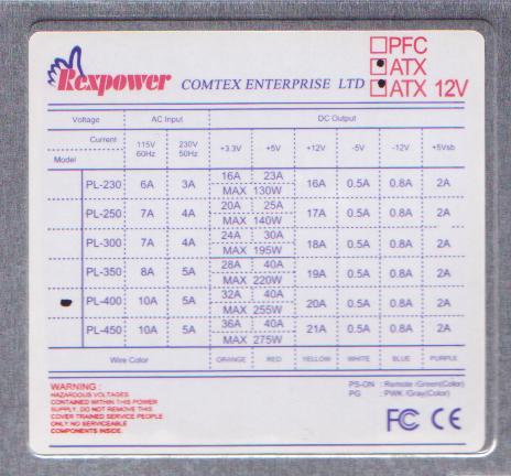

              This PSU has some similarities (most notably, Ever-power printed on the transformers).
              Here's the label in case that helps.

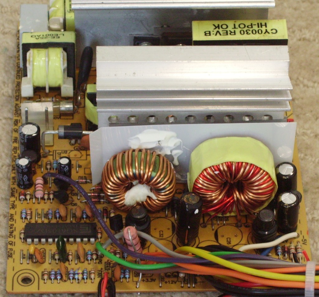

                Glad I changed the heatsinks. The original ones were so thin I can bend them into a U shape with my bare hands!
                PS. Did someone delete my post with the internal pictures? or did I just not post it in the first place?

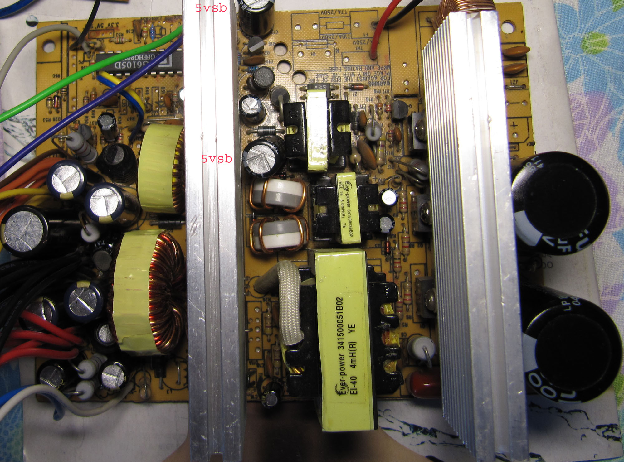

                            Please post some photos
                            • c_hegge
                              • Sep 2009
                              • 5219

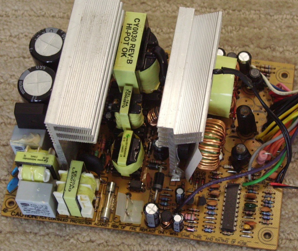

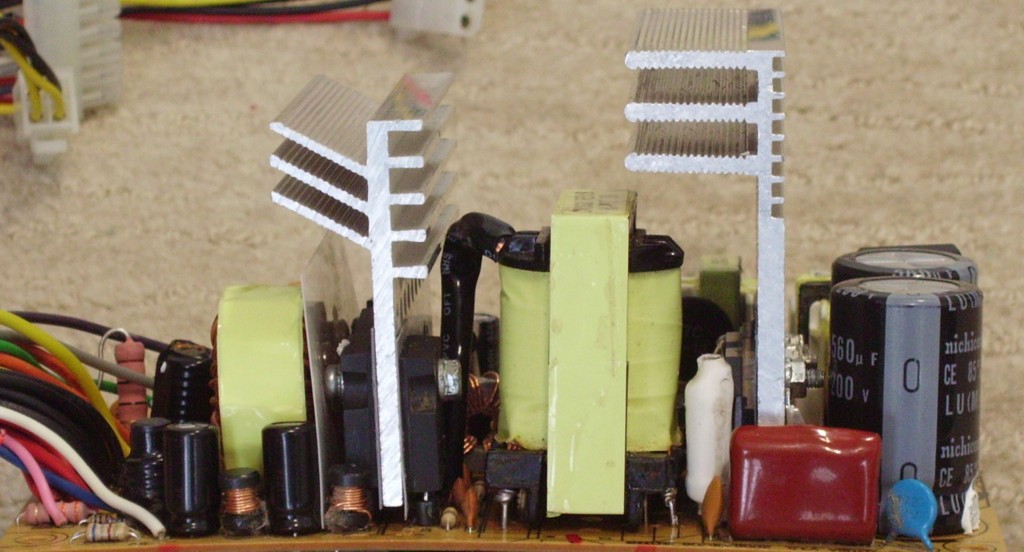

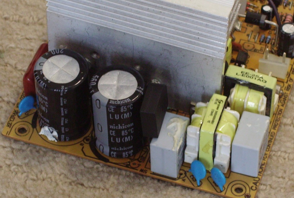

                              Re: Rexpower PL-400 rebuild
                              Here
                              • goodpsusearch
                                • Oct 2009
                                • 2848
                                • Greece
                                You can add metal oxide varistors for protection from power surges.
                                The switching transistors you used are capable of 450W.
                                The transformer looks to be El-35, good for 350 watt, maybe more. It depends of the switching frequency used.
                                Personally, I like to beef up the input capacity, so I would put 680uF or 820uF on a 350-400 watt psu.
                                You say you used STPS3045CW for the 12V line. VRRM is 45V, maybe too low for the 12V line. Some psus require fast recovery rectifiers for 12V or schottky rectifiers with 60VRRM or better. Look what happened when I tried to replace a 10A fast recovery rectifier with a schottky in a Maxpower PL-300 (same oem): https://www.badcaps.net/forum/showth...?t=8171&page=7
                                Last one, if it uses the same design with my maxpower, then there are 2 caps for the 5vsb (pic)
