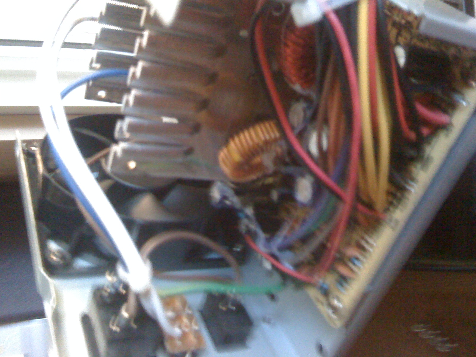

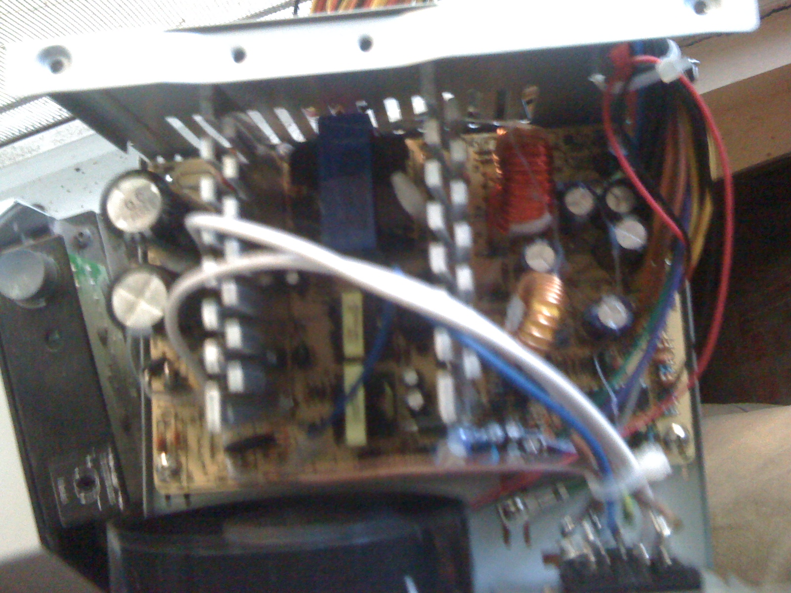

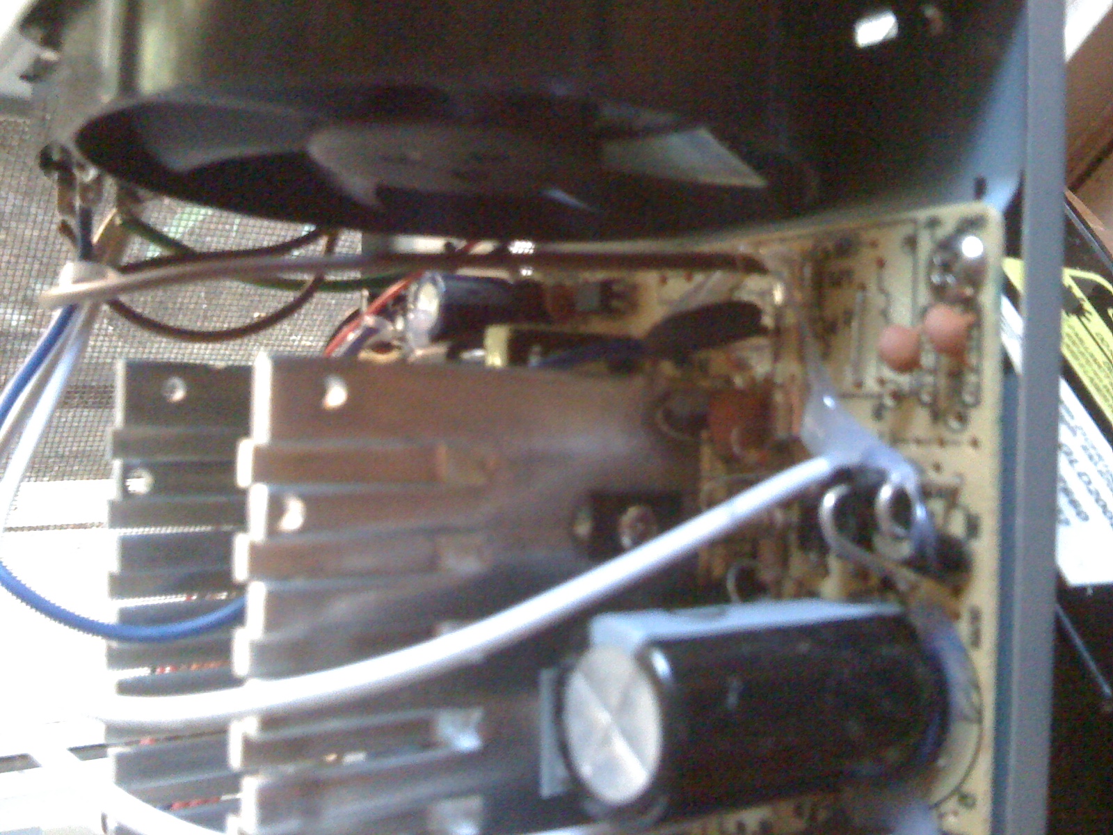

                              Re: improve cheapo psu
                              well um...
                              sorry for the bad pics. im moving so im not sure where my real cam is so i used my iphone 3g...
                              hope theyre good nuff.
                                It looks... bad enough. Just your average gutless wonder. First thing i'd do is install a proper transient filter (hint: it needs a coil, a couple X capacitors and proper safety rated blue Y class capacitors instead of those brown ceramic pieces of junk). Then add more/better caps to the secondary, and some coils if you have them, if not, it'll do without.
                                  heres what would be very helpful to me:
                                  take one of my pictures, and draw in with arrows/circles/etc what the pieces in need to replace are called and what do replace them with. because i dont know what a y cap looks like versus an x cap. tyvm!
                                        If you post some better photos it will be easier for us to help
