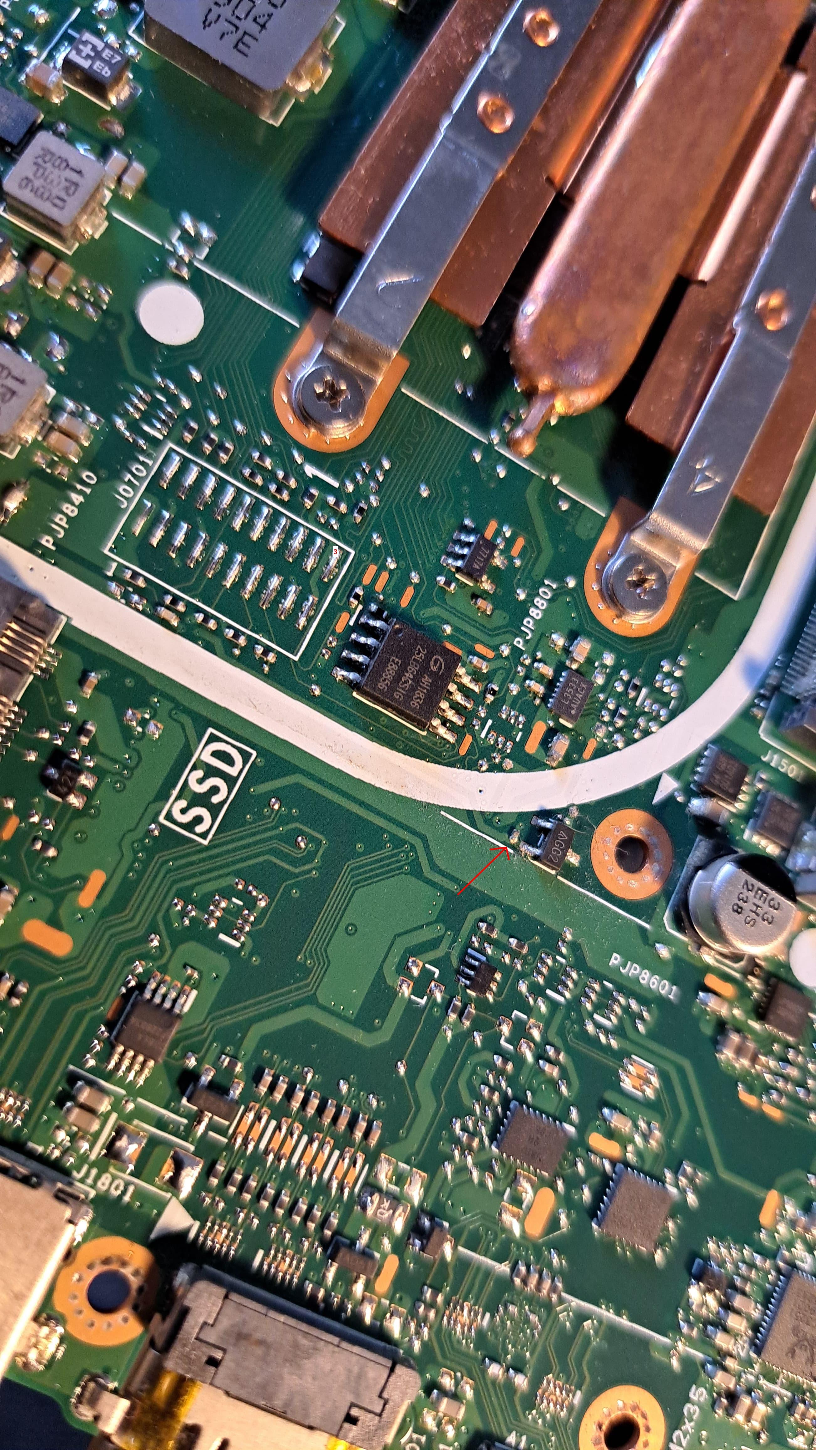

                      I have an Asus X512DK (board with only APU) that is powering right away on dc-in voltage from bench supply. CPU start to get hot very fast and then in about 1 minute the fan start to spin. All voltages seem to be good. Current not changing much (dont remember values but are around 500mA). I think this is a case from a corrupted BIOS chip (from Windows Update Mallware).
                      S/N: K3N0CV10R13613B
                      Attaching the needed images and file. Cannot upload .bin nor .jpg - created ZIP with all files (in the other thread i missed the internal QRCode and Board Version - it is V2.1).
                      Best regards.

                          Originally posted by boneco69
                          Posted wrong on X512DA thread, i am restarting here and kindly ask moderator to erase my post there.
                          Best regards.
                          X512DA

                            Firstly thank you for the BIOS file.
                            I can only flash the UEFI yesterday. It seems that is doing the same. I will try to reheat (from bottom) the cpu and see if the system boots to UEFI. Strangely if i remove the BIOS chip, the system will not power up - i could think this UEFI BIOS chip will not be needed to EC in case of BIOS reset (by not connecting battery nor AC adapter/power supply). So maybe the problem is somewere else in this motherboard. I will report when there is more time to see this.
                            • boneco69
                              • Jul 2010
                              • 7
                              #34
                              -- Ok. My bad. The problem was an shorted capacitor near BIOS chip, next to the litle IC or transistor (3 pin). The small capacitor was only detected faultry with infrared camera, because of head from the IC/transistor near it. Strangely all voltages, except in that line not related to any coil, are apparently ok. It is a case for a BadCap! This is easy to occur beacuse this motherboard zone is in the ventilation grid openings and moisture can give this results.
