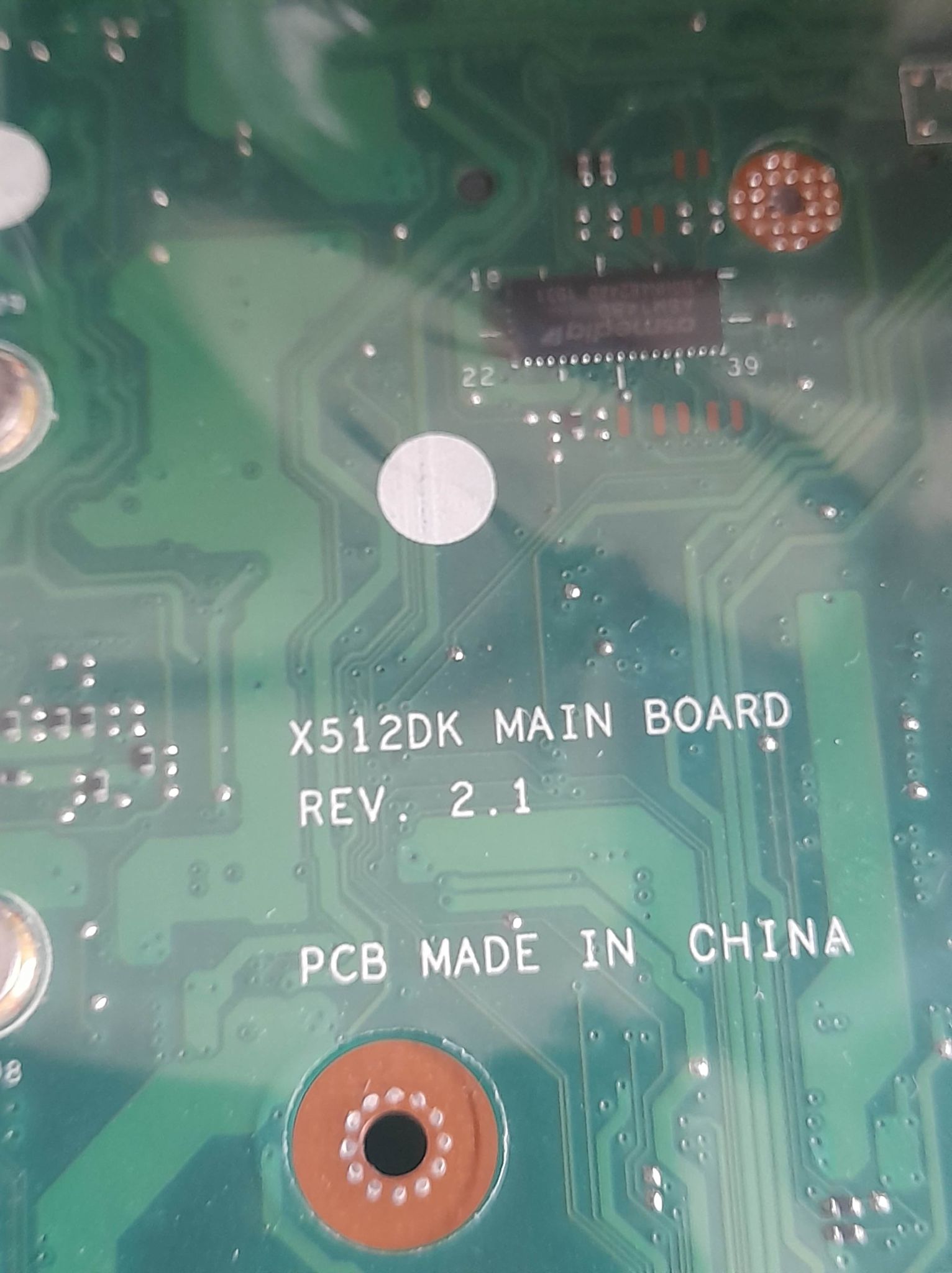

    I need a workng bios on this model Asus x512d , laptop suddendly not working check all voltages present, and theres is 1.8v on pin 3 7 8 of the bios chip anyone have a working dump please

    1v8 for a flash bios chip is normal these days. It is very possible that your flash device is truly designed to operate @ 1v8.
    What are the full markings on the flash device ? With this detail -> search for the datasheet and review the voltage range for the Vcc parameter = power rail. Respectively, the I/O pins will also toggle at the same max voltage value.

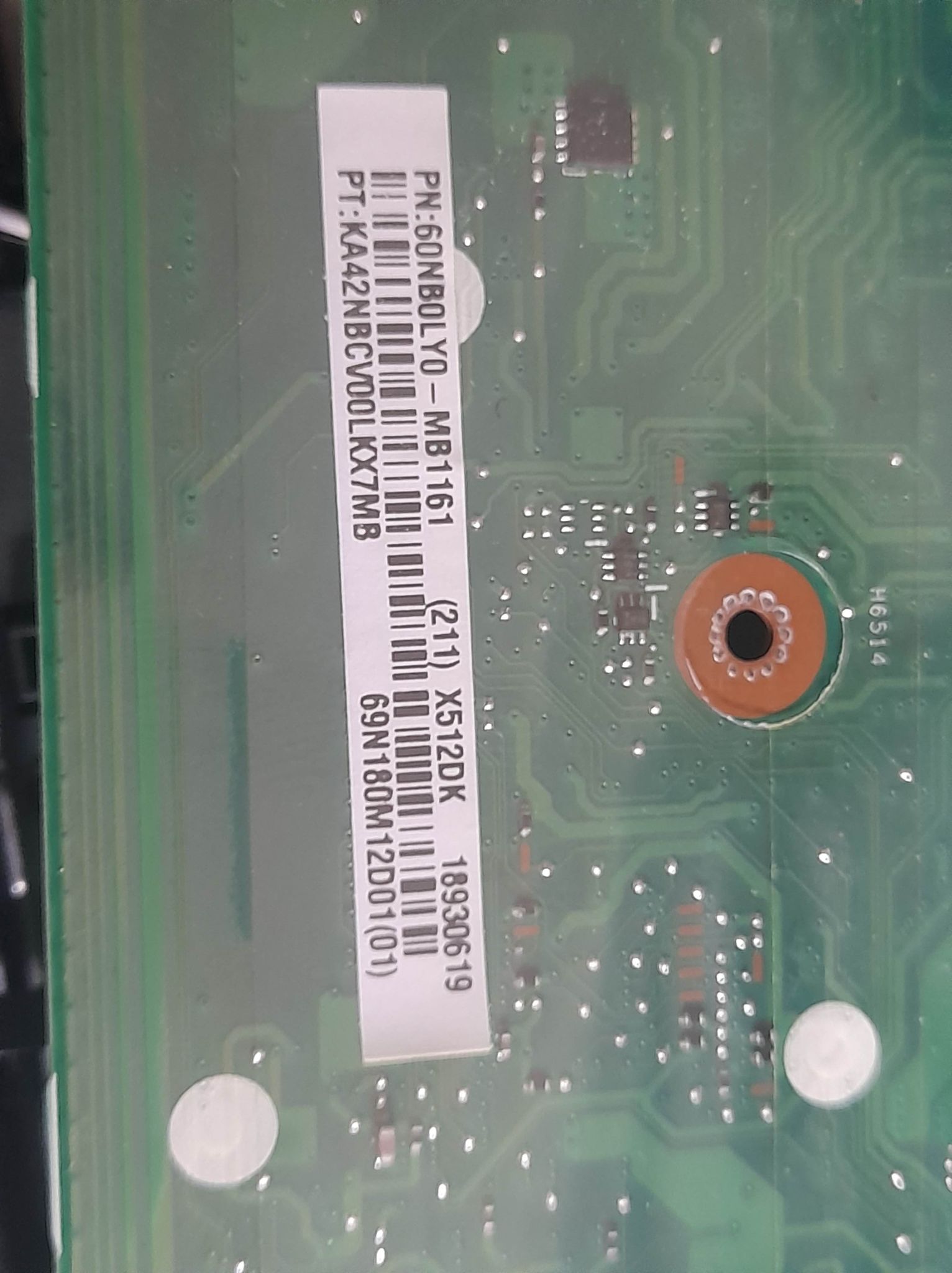

      That QR code is the heatsink part number. Is there a long white barcode sticker on the other side of the board near the soldered ram.
      If there are no stickers post the silkscreened part number, such as X512DK Rev

        Re: Asus x512d
        @smdflea here is the info sticker please thanks for the response

          ASUS Vivobook 15 X512DK

            You didnt post your bios backup.If you want to add your DMI use Asus Block Transmit tool (WBT.exe windows version) https://www.badcaps.net/forum/showpo...43&postcount=5 ,or you can add it with a hex editor from your backup. If there is a win key its best to add the dmi from your backup .
