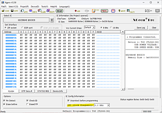

    I have spent the last hour on this and I guess this is just over my head, so here I am.
    I have an ASUS TUF GAMING Z790-PLUS WIFI motherboard here that needs to have the BIOS updated in order to accept the latest CPUs.
    The BIOS chips seem to come as a set of two: GD25B64ESIG and GD25B128ESIG. My guess is one of them is a fail-safe for the main BIOS? I really don't know. Or one of them is ME and other is BIOS? I don't know.
    Anyway, I took dumps of both chips and then downloaded the latest update for this motherboard from ASUS's website and this is basically where I am stuck. The downloaded .CAP file from ASUS's website is 24,580KB. The dump I took from GD25B64ESIG is 8,192KB and the dump from GD25B128ESIG is 16,384KB. If you were to add the file sizes of my two dumps, it would add up to roughly the size of the downloaded .CAP file from the ASUS website.
    The problem I am having is I have absolutely no idea how I can go about flashing this new BIOS to the chip when they are separated between two chips like this. It seems to me like the original dump will need to be edited in a HEX editor to have the .CAP update "merged in" or something and I am still not skilled enough in this area to do this. I have read over the guides here a million times and watched countless YouTube videos and I have still just been unable to figure out how to successfully edit a BIOS file and have it actually allow the computer to boot. I've tried it before on other systems and failed every time haha.
    I think I understand what needs to be done here, but I have absolutely no idea how to go about doing it, so I am here asking for help. Attached is the original dumps from both the 64MB and 128MB chips as well as a copy of the latest available BIOS update from ASUS's website. If someone could please take a look at this I would greatly appreciate it. Thank you.
    Also, as a follow-up question. Assuming someone here is able to help me and edit the original BIOS dump to "merge in" the updated BIOS region or whatever needs to be done, I am assuming I am going to end up with a single file. I would flash that single file to the 128MB chip, I assume, but what does that do to the 64MB chip? Does the updated BIOS from the 128MB somehow automatically update the 64MB chip or will I have two separate files to flash individually to their respective chips? I don't understand how that part works. Thank you so much!
    Also, in case I didn't make it obvious enough:
    TUF-GAMING-Z790-PLUS-WIFI-ASUS-1820.zip = Downloaded ASUS Update file for this motherboard
    GD25B64E@SOIC8.zip = Original dump for 64MB chip
    GD25B128E@SOIC8.zip = Original dump for 128MB chip

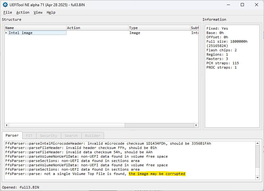

    i tried joining the 2 files from your dumps: first the 8MB+16MB, and UEFITool showed an Intel image, with a Descriptor, ME, and BIOS regions, but it's corrupt

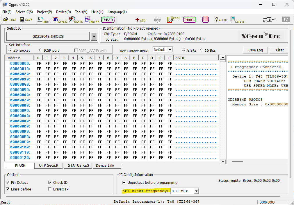

    If using a clip, try changing the SPI clock frequency in your programmer to lower frequency to try to get a good read, then read the chips 3 times each and compare the dumps with a hex editor; if exactly the same, it's very likely you got a good read
    Example: I have the T48, look for a setting similar to this, and lower the value (I set it to 8MHz when using a clip):
    Click image for larger version  Name:	spiclk t48.png Views:	0 Size:	58.6 KB ID:	3679692

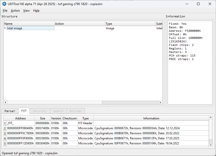

    How your dump looks, vs how should it be:
Name:	corrupt full dump.png
ID:	3679697 Click image for larger version

      Thank you for the help. I also use the T48 and I indeed used a clip on both dumps. I'll try again with a lower frequency as you suggested and see if the dumps are the same after 3 reads.

              Your original BIOS is version 1402, it should work with 14th gen Intel CPUs out of the box
              TUF GAMING Z790-PLUS WIFI BIOS 1402
              Versión 1402
              11.25 MB
              2023/09/19
              "1. Update Microcode for Intel® Core™ 14th gen processors
              2. Update ME to version 16.1.30.2264v2 for Intel® Core™ 14th gen processors
              3. Improve system stability
              Updating this BIOS will simultaneously update the corresponding Intel ME to version16.1.30.2264v2. Please note after you update this BIOS, the ME version remains the updated one even if you roll back to an older BIOS later."
              The issue may be somewhere else
              The way you split the files is correct, just small differences in how the serial etc. are stored (using FD44Editor, vs doing it by hand copying from the original dump), nothing that affects POST
              Even without serial, MAC address, UUID the board should POST
              S/N, MAC, UUID are stored in those offsets, I copied manually to the new BIOS (those offsets are from the full image)
              864000-86415F
              A90090-A900CF
              Attached the split files for BIOS 1820, now with your S/N, MAC address, UUID
              As i said before, test only motherboard, CPU + heatsink, 1 stick of RAM in slot DIMM_A2, GPU if using a "F" CPU(without integrated graphics), nothing else connected to the board except keyboard/mouse/monitor (connected to GPU, or the onboard HDMI port if no GPU installed); it will take some time, give it 5 minutes for the 1st boot
