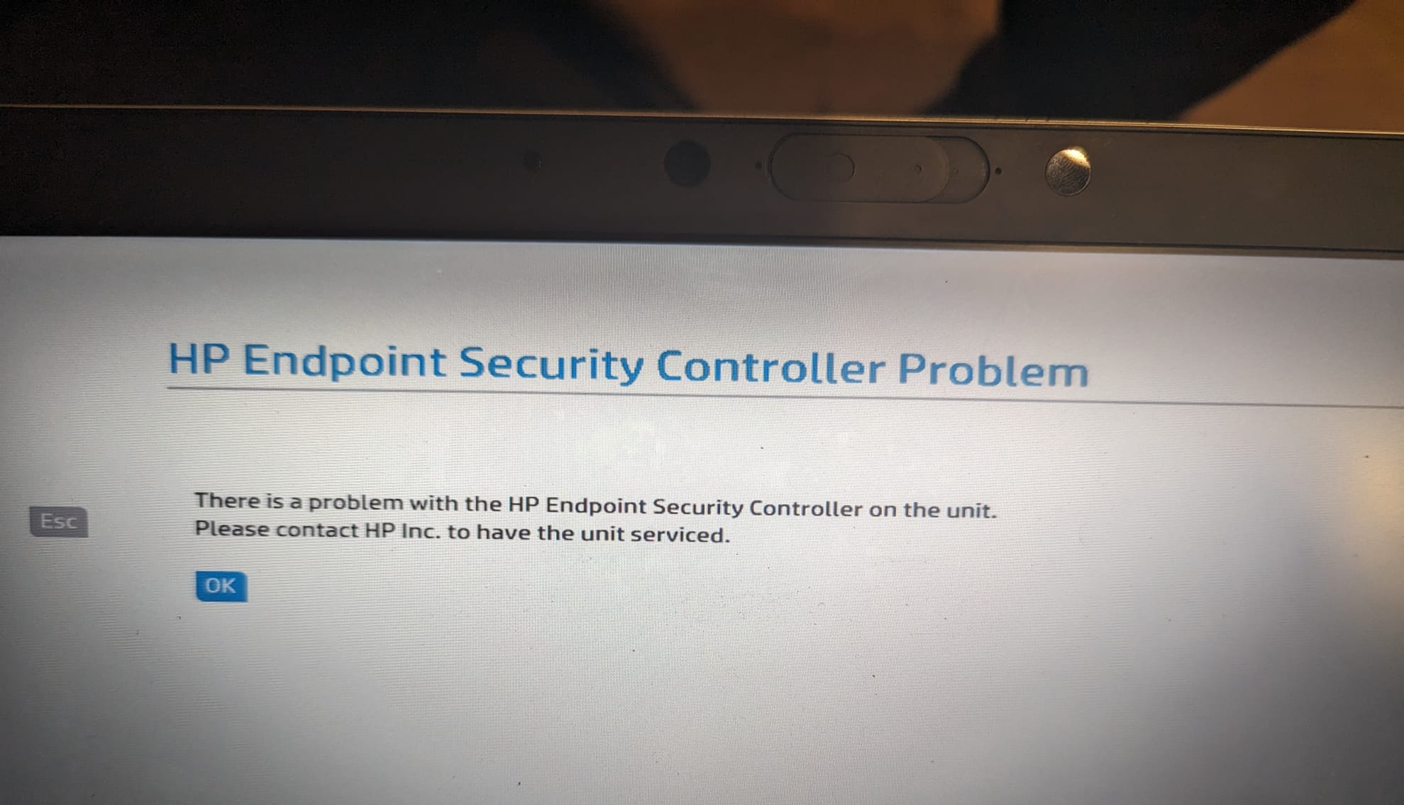

              hp 840 G6 i7 endpoint security controller problem
              hi i try to unlock the bios on HP 840 Genration 6 i7
              i modifid the 16mb CHIIP but after is coming always the Eror hp endpoint security controller problem
              i try to install clean dump for 32MB too but still same can anybody help me
              i post the original Dump file down .

                Re: hp 840 G6 i7 endpoint security controller problem
                Read post #103 .

                  #108
                  Re: HP Elitebook 840 G6 bios password
                  https://www.badcaps.net/forum/showpo...&postcount=346
                  if you have problem with hp endpoint security controller and password lock use this main and ec it works tested.

                          #112
                          hi everyone , after removing bios password im confronted with a "endpoint security controller problem"
                          can anyone help me with a good unlocked flash
                          thanks
                          6050A3022501-MB-A01 - 5CG0360FPX

                              #114
                              no still the same error

                                #115
                                thanks
                                Serial number ?
