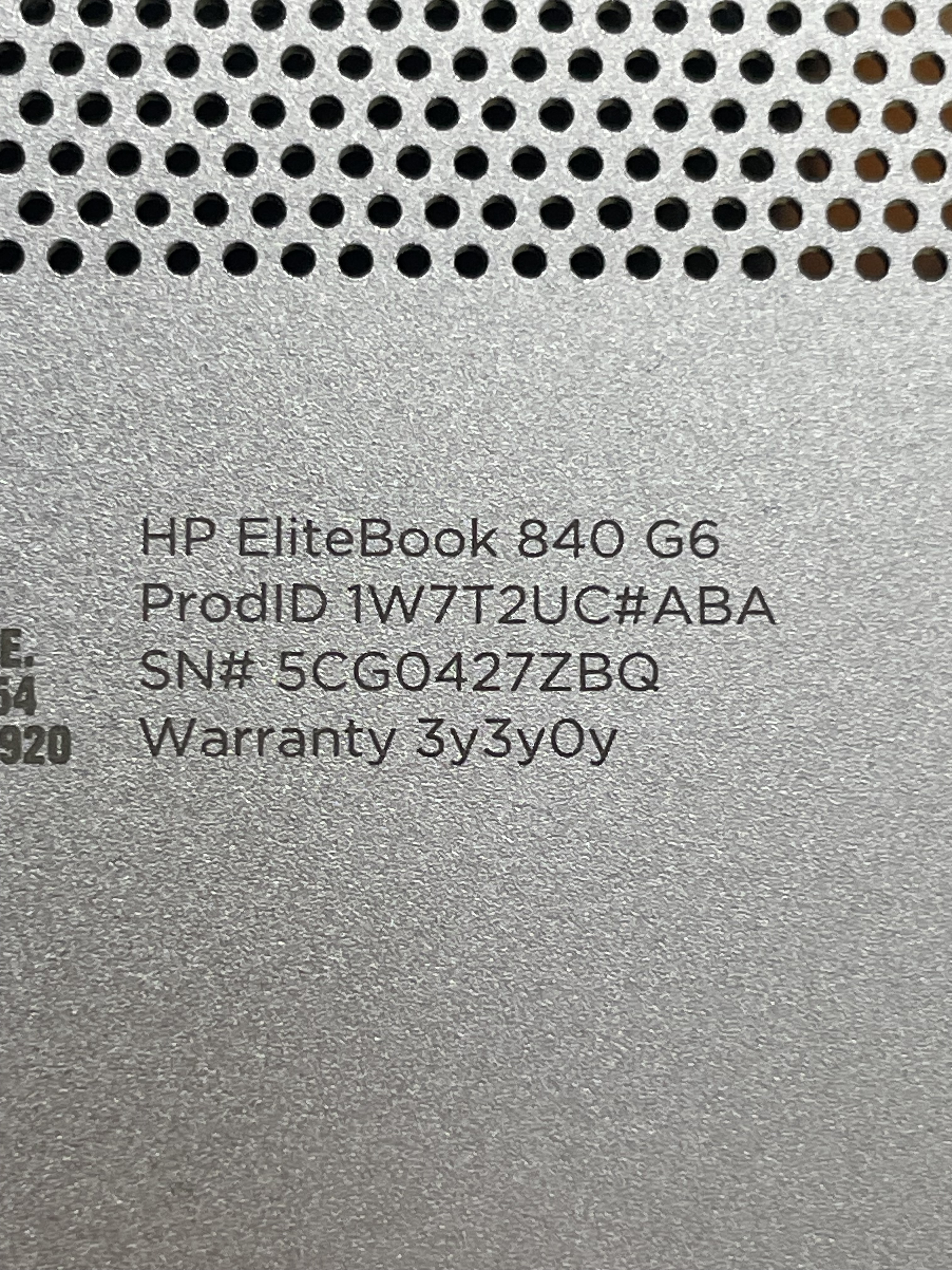

                    unit now posts however top left corner says system is "booting in manufacturing program mode". I set the machine unique data however SMBIOS UUID is unknown. can anyone help? thanks

                      #131
                      You fill in this information in "program mod"

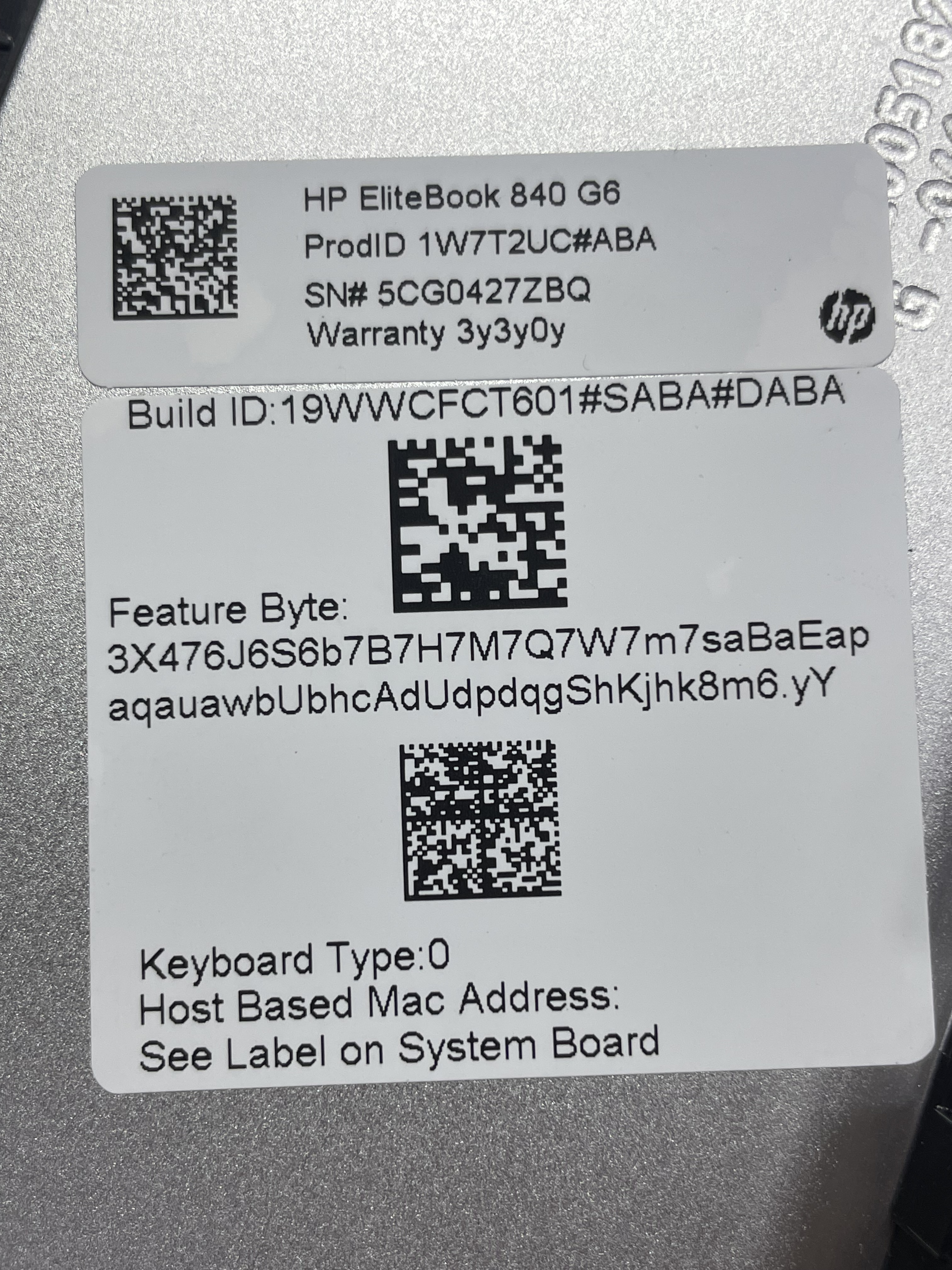

                        • ub6ib969
                          • Jul 2010
                          • 198
                          #134
                          Thank you, however i entered the data from F10 bios > set machine unique data > however the sku number and smbios uuid are unknown. i am still receiving "booting in manufacturing program mode" any thoughts ?

                              #136
                              The sku number is located on the bottom cover and is signed as “ProdID”. After that, you need to download the "HP DMI Tool" program in the Windows OS, where the UUID will be specified. Enter the UUID in the bios and save the data. Open dmi tool and lock MPM to remove "booting in manufacturing program mode" text. You may have an incomplete “Mac Address Pass Through” field in bios (located on the CT board sticker). Check and save the changes
                              Later I can attach the dmi tool that I used for this
