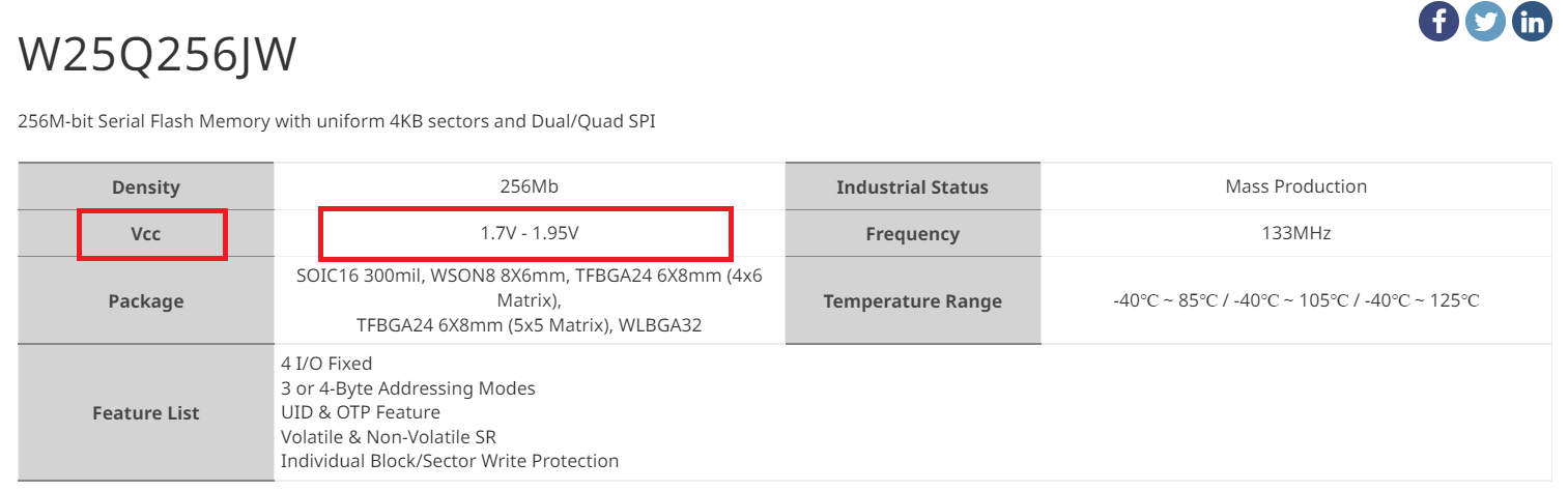

                        Is it possible that I corrupted the bios because the wson8 probe pin keeps on moving while the programmer (ch341a) is connected to the pc?
                        I volt-modded the ch341a to 3.3v and checked using a multimeter before doing any wson8 probing to the board.

                            Did I short something while using the wson8 probe pin or I corrupted the bios because of it? (note that I didn't read nor flash anything on the chip)
                            is my chip W25Q256JVEN compatible with ch341a?

                              If you have a CH341A with a black board then voltage might be the problem, it has a default of 5 vol. Maybe it broke something.

                                  My chip is "JV" and I saw on datasheet that it requires 2.7v to 3.6v. So I think it is supported.
                                  Yes, I have a black ch341a and I volt-modded it (watched youtube videos many times) immediately after buying before trying. It reads 3.3v now on multimeter.
                                  Do you think I damaged something on the board or I just corrupted the bios because of the probe pins?
