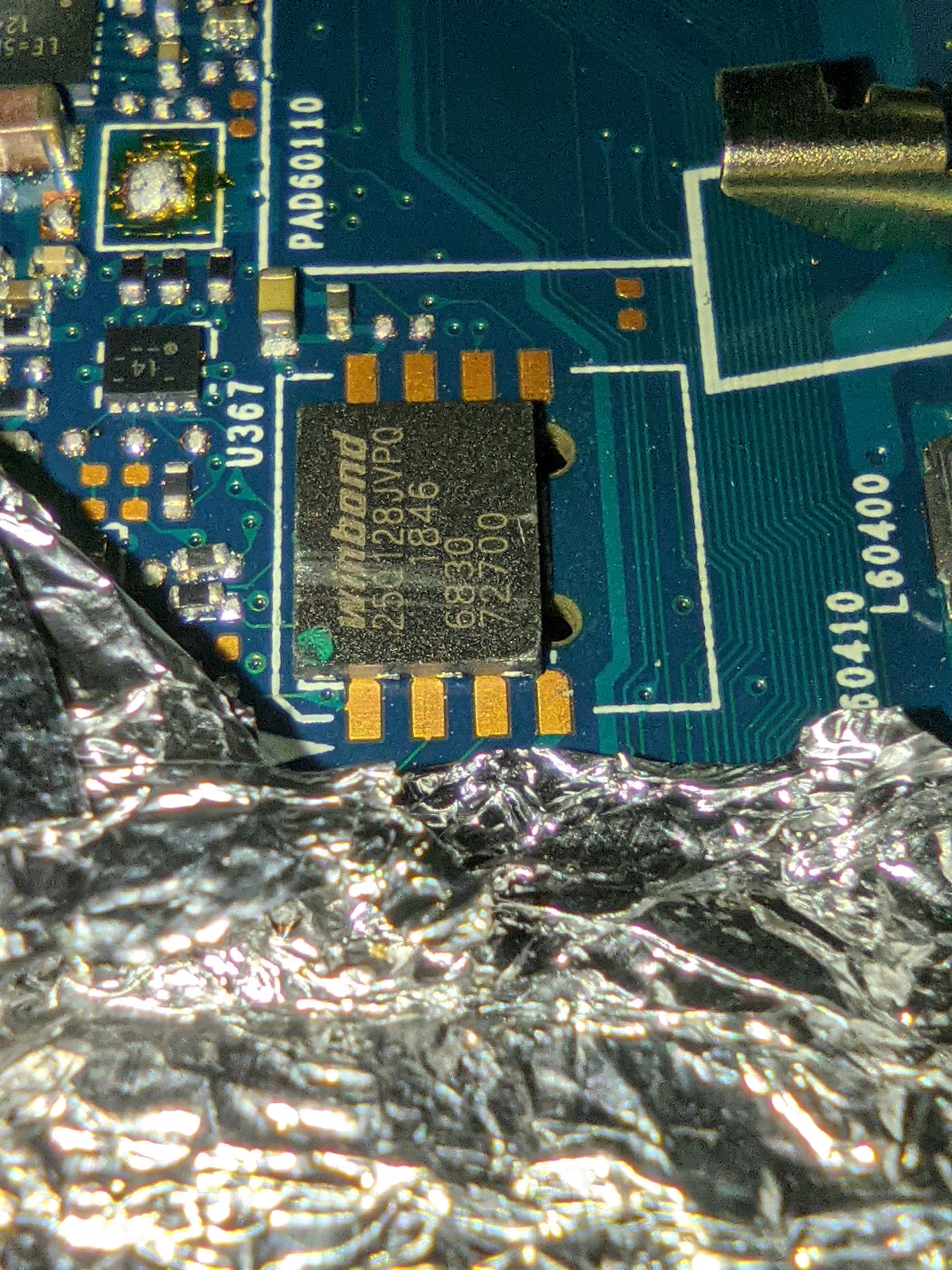

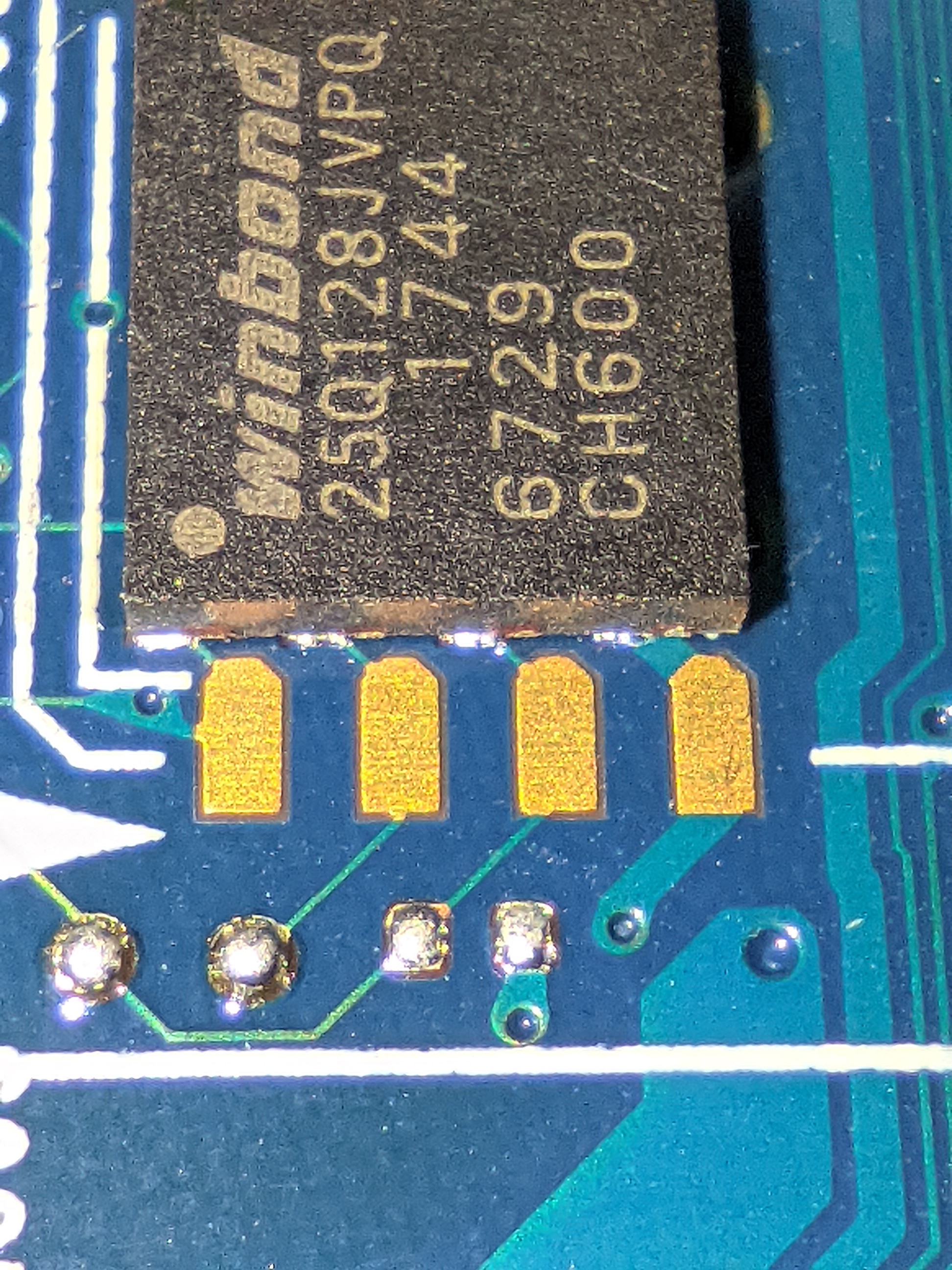

        The chip with no scratches is not original, bought on ebay, and caps lock blinks 7 times with it. Is it because the numbers arent the same? The scratched one has a password and boots fine
          The chip is exactly the same, so if you have problems, check the soldering (try to resolder the chip), or simply the chip is not programmed correctly.
            Compare the picture on the left where the chip is on the pads, and lined up with the white silkscreen line on the left. Now compare to the second picture,the chip is too far to the right and too far up, by over a milimetre or two

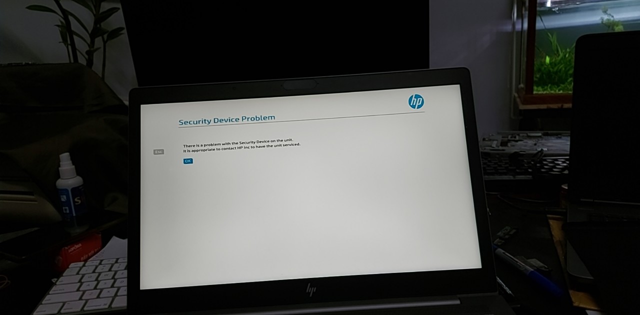

                              hi guys!
                              i have laptop hp zbook 15
                              display showing "security device problem "
                              every body can help me fix?
                              thank you so much!

                                          #1100
                                          Re: HP BIOS unlock tool
                                          Originally posted by clrscr
                                          hi guys!
                                          thank you so much!
                                          please help me !!!!!
