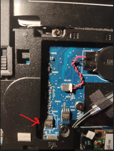

                    Good evening,
                    I'm the owner of a HP ProBook 4730s. The bios is locked by a lost password.
                    I've dumped the bios with a CH341A Programmer. I've tryed unlocker on post 1 but it's not working despite change inside the unlocked file. On the HP website the Bios is 2.5Mb but the chip (MX25L512C) is only 512kb.. I've tryed some to like UEFITool to make is smaller with no luck.
                    Can you help me to find a way to remove it ? Attached, the original bios file I dumped, the modified (non working file from Unlocker).
                    Thanks a lot.
                    • RethoricalCheese
                      • Mar 2013
                      • 1519
                      • Estonia
                      #1150
                      Re: HP BIOS unlock tool
                      Obviously you have the wrong chip. Find the correct one. It might be in a socket on that model.
                          Hello RethoricalCheese,
                          Thanks for your time and reply. I dont understand where this chip can be. I've looked around everywhere. I've found some powerchip but nothing programmable or look like a BIOS chip

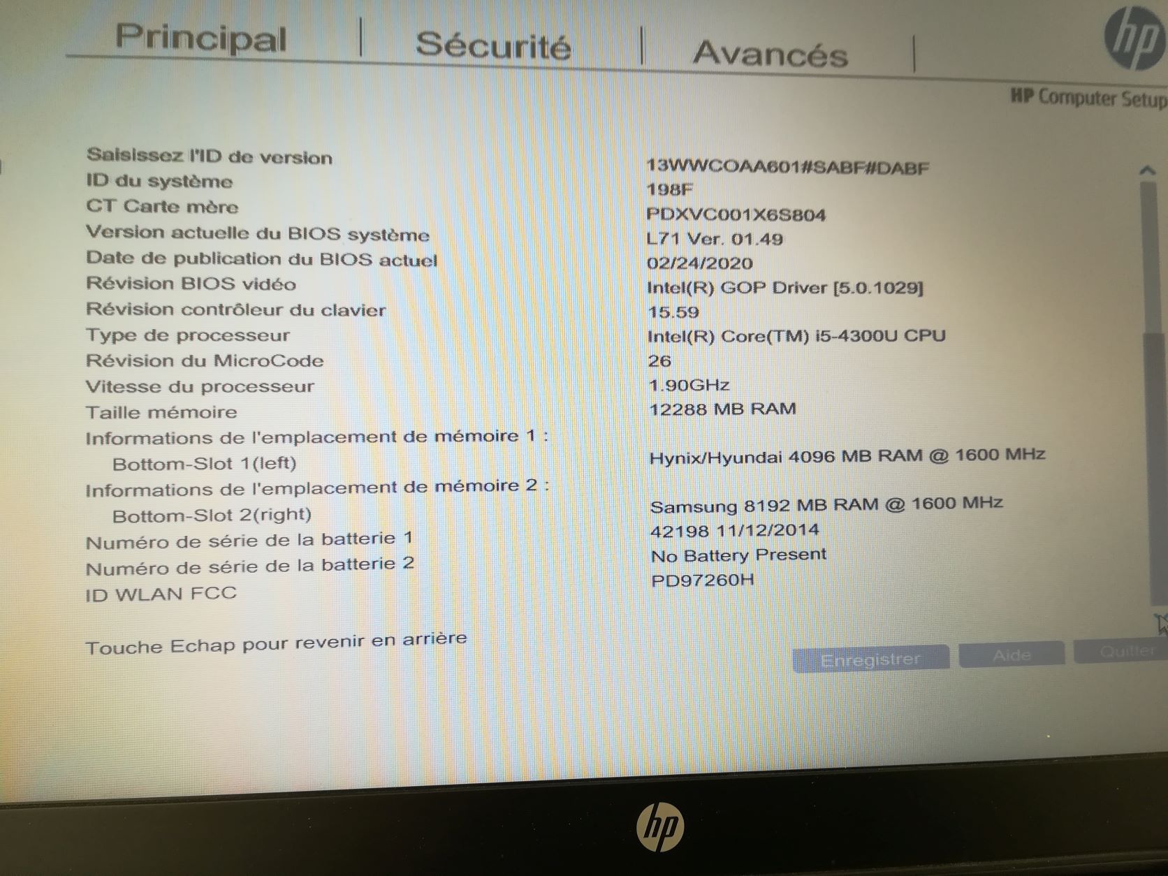

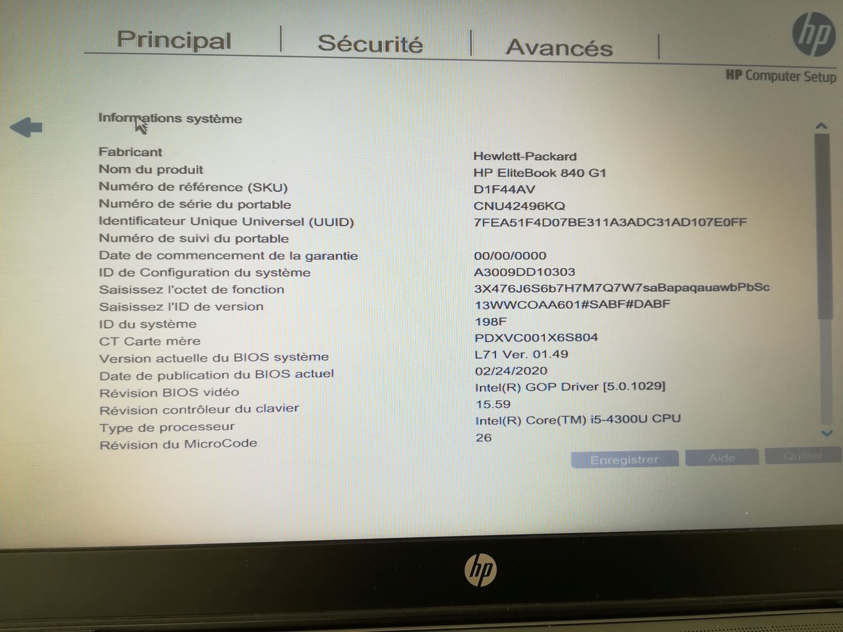

                              first of all thank you for this forum and the tools you have developed it is very helpful.
                              I have an HP 840 G1 with the bios locked by a password.
                              I successfully dump the bios (via a CH341a programmer) and unlock the bios via RCunlocker and it is working.
                              But now I have the following message at startup : "Warning!! Machine is not in committed state!"
                              I tried to use wndmifit but it seem the mpm mode is locked too.. and I cannot succeed to unlock with windows touch + up + down
                              Does somebody have a tips or a suggestion to remove this message ?
                              (I do not understand very well why I have this message ..)
                              thank you very much

                                  #1156
                                  I would like but the laptop is in mpm LOCKED mode :/
                                  and when I tried to go in unlocked mode with windows touch + arrow down + arrow up + power the laptop start, display HP logo and stop
