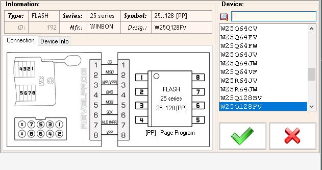

      Hello everyone. I have a problem with HP EliteBOOK 840 G3 ProID W8F16UP.
      The customer had a damaged M2 hard drive, purchased a new one and tried
      to install the system. However, booting cannot be changed because
      the Administrator's BIOS password has been forgotten.
      I used HPUnlocker v1. I reprogrammed the flash memory, but
      the computer does not start after the change. From what I can see
      this model has two flash memories (MX25L6473FZNI and Winbond 25Q128FVPQ).
      I tested two flash drives but the effect is the same, the computer does not start.
      Attached I am sending both copies of the original flash content and the HPUnlocker file.
      Maybe someone will be able to solve this problem or tell you which offset contains the BIOS Administrator password.
      Thanks for all the hints and help.

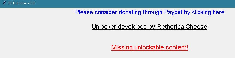

        Try RCUnlocker, there is a link to it at post #1

          You must have done something wrong - 25Q128FVPQ is 16MB, but the dump you've uploaded is 8MB, so (I just checked) it's a half of the dump, most probably you didn't select the right chip in the flash program menu.

            I was also surprised that the dump is only 8MB. I checked the latest BIOS version for this model and it is about 9MB.

              9MB is an update,not the full bios image.As vesko said ,select the right chip in the flash program menu.Don`t use auto detect.What model is your programmer

                Of course, I checked at the very beginning, but I have a mistake.

                    I do not use the "auto detect" function because there are errors in flash memory recognition.
                    I chose the flash chip by hand.

                        Hello. Yes, you were right the program did not change the selected memory but loaded the previous one.
                        Now I am not sure if the 16MB BIOS content read is damaged after saving 8MB with changes.
                        The computer does not start.
                        Could you please send me a full new BIOS batch for comparison. I wonder if I could have damaged the KBC.
