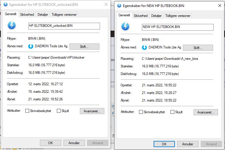

                        Hi All, i'm getting this error message.. "HP Endpoint Security Controller Problem
                        There is a problem with the HP Endpoint Security Controller on the unit
                        Please contact HP Inc. to have the unit serviced ".. after trying to program HP 850 G6 bios chip. Could someone help me remove it (by new bin file), that actually works?? :-)
                        Have attached my original bios file :-)
                          New file
                          ​https://www.badcaps.net/donate
                          • Jesperb
                            • Jul 2016
                            • 6
                            • Denmark
                            #1253
                            Re: HP BIOS unlock tool
                            Originally posted by hoaca388
                            New file
                            Thanks hoaca388, the file you posted is exactly the same as the file i have written to the bios already. Did you alter any code in the file ? OR did you just unlock it with HP-Unlocker tool ?....Because it is identical to the file that's currently in the BIOS chip, see picture
                            Br
                            jesper
                              No, i was build a new file from your file. Of course it should be 16MB.
                                OK, i will flash your file, see if it solves the problem
