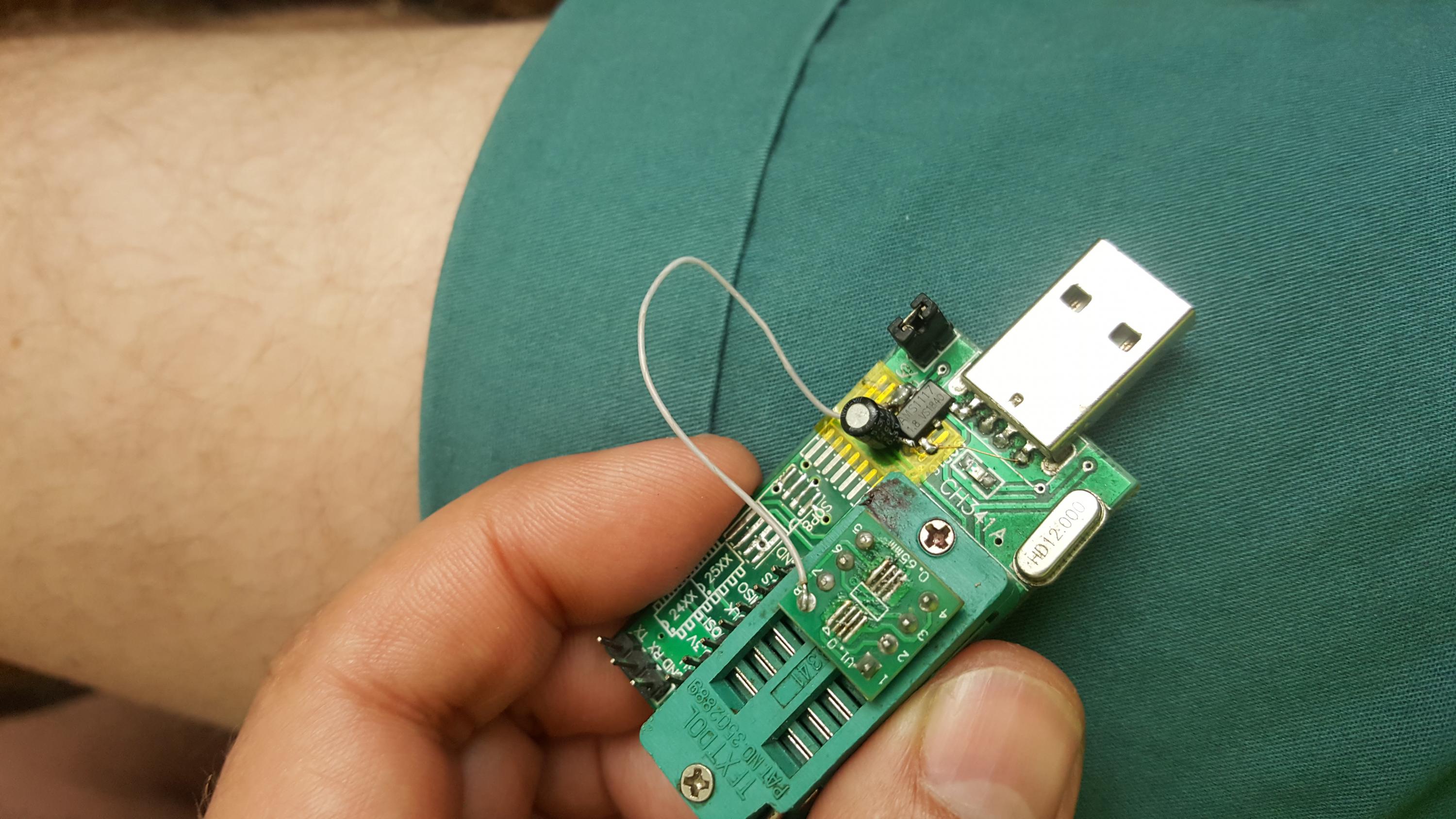

                              #174
                              Re: Macbook M1 bypass FMM / EFI Unlock
                              Originally posted by betonel
                              Winbond chip is located on the back side of the board similar with T2 models. Attached you can find some pictures of what I've done. Be careful, it's 1.8V chip, so you need to use appropriate programmer adapter.
                              If you wonder what kind of wires I've used.. it's old pc IDE cable
                              Instead of wasting money on T203 (~$200) and get stuck with uson4*3 or DS809SE (~$200) which is exactly an R809F i use this:
                              64$ RT809F + 15 adapters ( 1.8V adapter required!)
                              https://s.click.aliexpress.com/e/_A6uAnD
                              Programmer ( same as DS809SE )
                              25$ MacBook Apple Notebook Maintenance Serial Number Modification Tool T2 Chip Unlock BIOS Read Adapter Board
                              https://s.click.aliexpress.com/e/_ApVJfz
                              Let us program USON2*3 U3750+U3710 Wifi+BT ROM, XSON4*4, Apple T2 ROM USON 4*3 and Macbook M1 SOC, WSON6*5, WSON**6 and WLCSP 16 ball used on A1534 bios or SSD rom.
                              $52 Sam Connector with Seat Socket Serial Line for DS809SE
                              https://s.click.aliexpress.com/e/_A0aPKx
                              Small mod is required to work with RT809F: undo all pins from connector and put it reverse way -> red will be on opposite side , and run a wire from PIN 8 (+) to pin 8 on the board , which you can hold it by hand, without needing to power on MB machine.
                              in this image, i can see you use apdapter "DIP8 to SOP8 0.65mm" to read Uson8 4*3 T2 chip, does it fit?
                              sorry for dumb question because im a newbie and I'm a knowledge seeker
                              Sr english not my main language,
                              Hope you reply me soon

                                #175
                                A DIP8 to SOP8 won't work.
                                You need a board from AliExpress called "serial number modification tool T2 chip unlocking BIOS reading adapter board" as posted by betonel.
                                This has USON8 and other types of useful pinouts.

                                  #176

                                      #178
                                      over 20$ in my country very expensive, what do you think when I use copper jump wire to connect T2 Rom chip in Adapter "DIP8 to SOP8"

                                          #180
                                          oh, really? i see in this picture, you are using "DIP8-SOP8 0.65mm". does it fit for "uson8 4*3 "???
                                          and why you add capacitor to transistor and jump to 8 pin adapter? ( I think it convert 3v3 vol to 1.8V to use with t2 chip )
                                          sorry for dumb question, i am a newbie D
