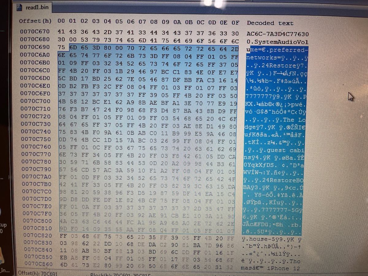

    Originally posted by radicalsolutions
    really?
    your device is activation? i can't find this data on my erased device
    • radicalsolutions
      • May 2020
      • 14
      • www
      #222
      Re: Macbook M1 bypass FMM / EFI Unlock
      yes, tried this on several devices
        unfortunately the email address is not contained in the erased devices
        • radicalsolutions
          • May 2020
          • 14
          • www
          #224
          did you read dump after connecting to wifi? I tested on erased devices too

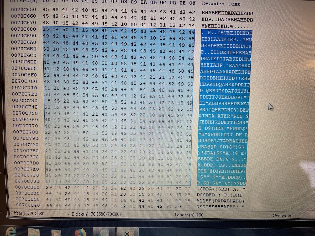

            #225
            I've checked 20+ devices, no email addresses or names found. There's no way you confirmed this on multiple erased/activated devices. All boards/dumps I checked had been connected to WiFi, etc. None show emails in the dumps at area you highlighted, or otherwise (searched for yahoo, gmail, iCloud, mail, email, name, etc), and none have names or emails.
            Gotta call BS on this unfortunately.

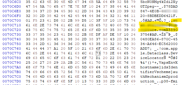

              this is from a pro, just a random one choosed from a stash, for you
              There is no way you read 20+ devices and no data in them, or mabe you are reading something else

                #227
                I'll pull some more files and show you what I see in that block; give me a few hours. But I didn't find an email in a single one at that spot in the dump.
                • ugamazing
                  • Jun 2013
                  • 171
                  • usa
                  #228
                  Just pulled 3 more files--one A2337, one A2338 and one A2442; no emails in that block on any of them. Photo attached of the A2337 & A2442 (didn't photo the A2338--it was similar to these).
                  So now 23 files pulled and no emails. Your files are apparently different for some reason.

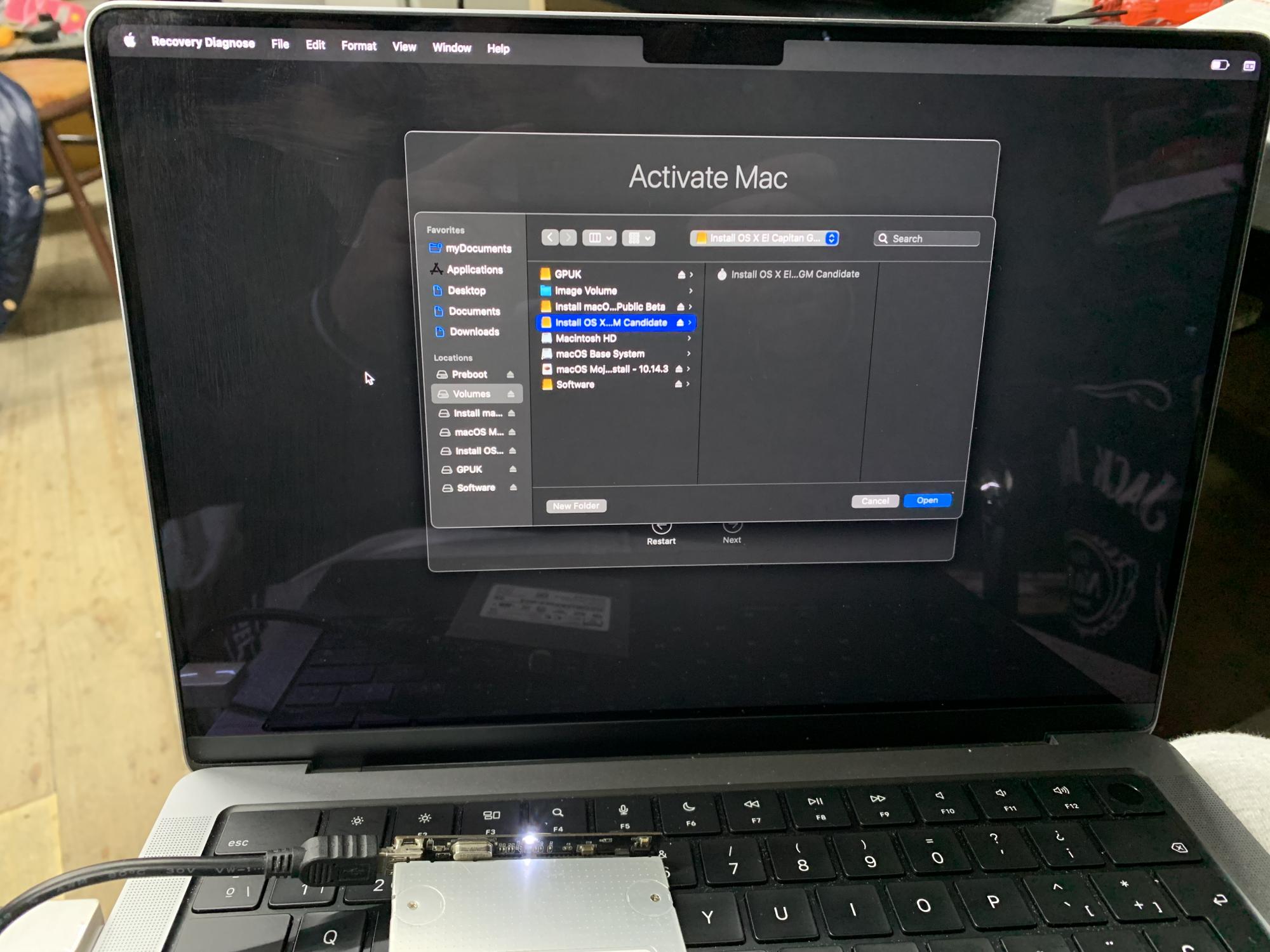

                                    I'm trying this on a 820-01987
                                    Can't find any email address either.
                                    • venturaisr
                                      • Nov 2016
                                      • 4
                                      • Portugal
                                      #238
                                      I was able to access finder in a locked m1.I can browse and even attach usb but unfortunately can't open any app or terminal since it is greyed out…
                                      Any suggestion?
                                        Is that through Safari via the diagnostics?
                                        If so, you can access a little more if you attach a mouse and use right click to access some menu items. However, I couldn't open items like you say.
                                        I could rename some files, but don't know which ones could be renamed to bypass activation.

                                          #240
                                          I share a way to see this menu, watch this video, I could not do more.https://www.youtube.com/watch?v=I9QOZLY1WHA
