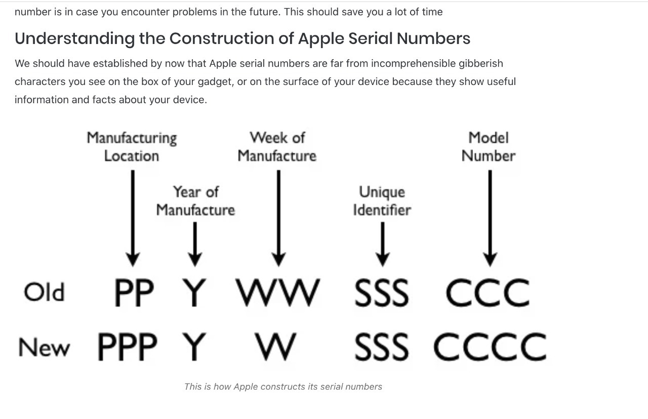

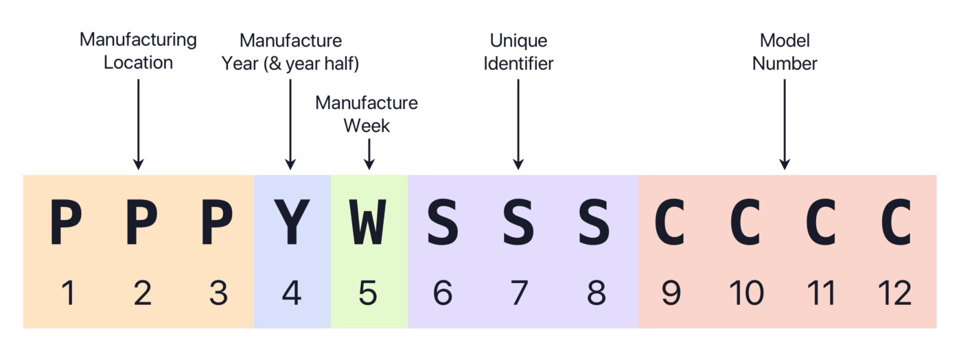

      In case you didn't see a remark I made in another post:
      C02Z5205G8WN -- If this were a real SN...
      C02 = location made
      Z5205 = Date Code + SN
      G8WN = Model Info
      As in ... people talking about willie-nillie changing the last 4 to edit the SN are changing the model info.
      There IS a file inside the OS which decodes those last 4 digits to define the unit. I'll see if it's still in Monterey and convert my i9 into an M1, etc., (on the initial about this mac; it'll do nothing for the Profiler details which are from the HW info).
        C02 = location made
        G8WN = Model Info

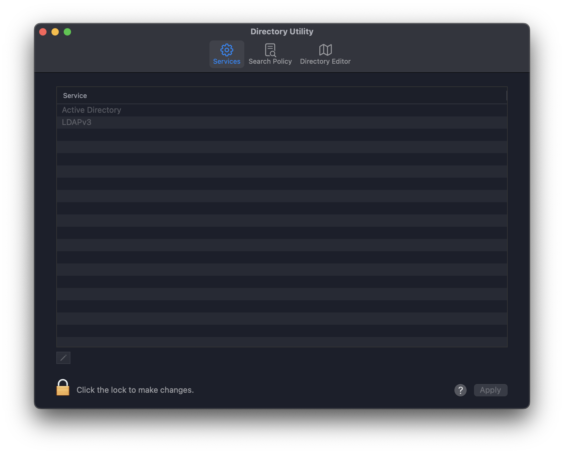

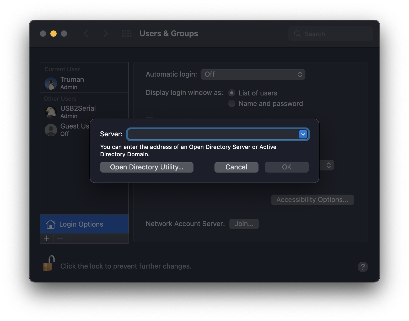

                      Do you know what apple uses to recognize that the Mac is linked to an Apple Id? I know it's not only the Serial Number.
                      And I managed to get an Apple Business account, what can I do to MDM my MacBook?

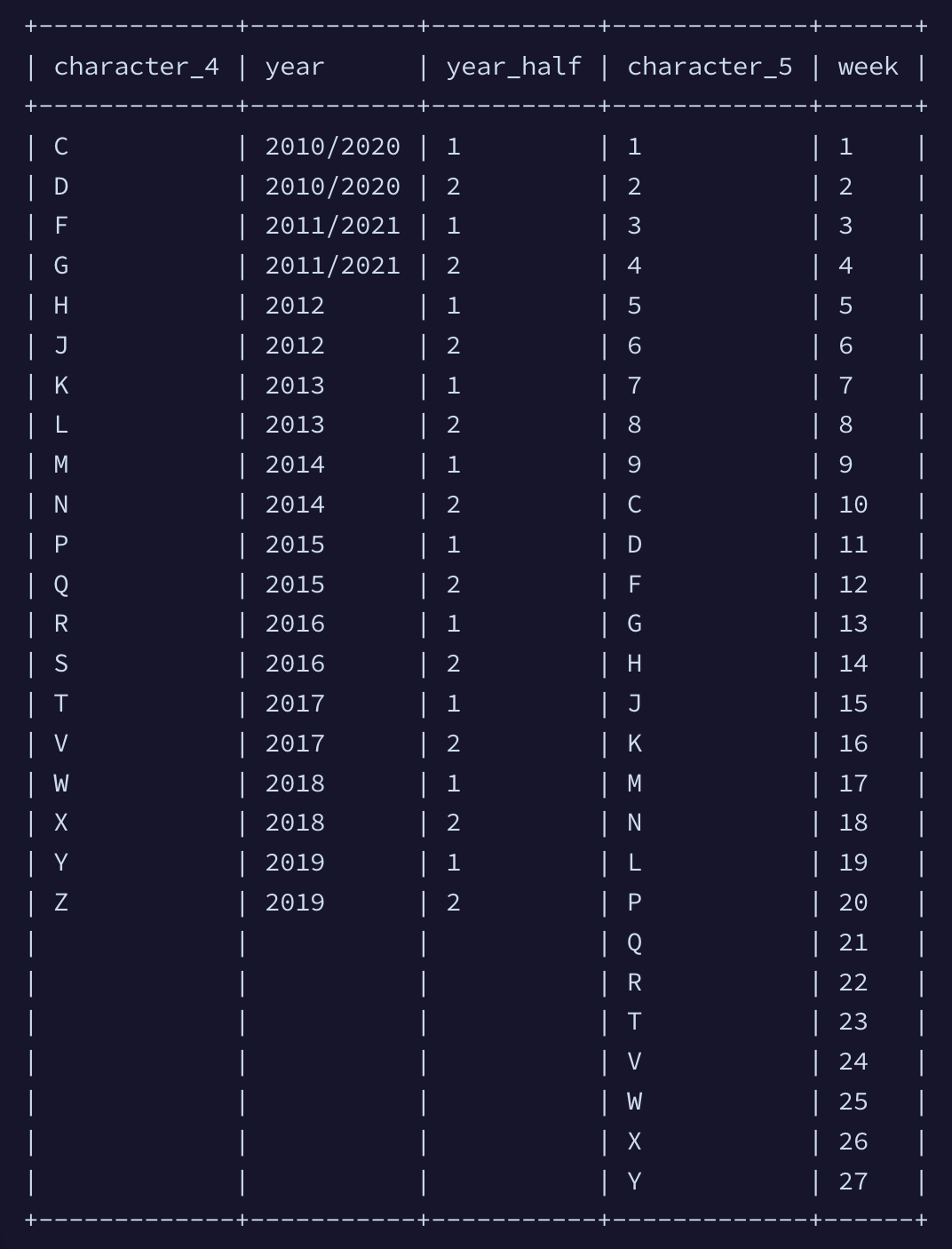

                          NOTE: The "image" titled
                          SN_Decoder.txt file with the code from
                          https://www.kolide.com/blog/how-to-f...-using-osquery
                          The page seems very informative to me, but I lack the programming bg to follow the recipe.
                          As I'm uniquely UNqualified, I'd be grateful if someone were to follow the recipe of said code & provide a script an ignoramus like myself can use?
                          I realize this just provides a database of mfr dates ... but, I believe I have about 5-10k units in my old database which I could sort by the last four SN to define each model and provide another database (if someone else doesn't already have it) in order to have a program which decodes the Date Codes and model without needing to use a website with captchas, etc.
                          Even if future SN are truly random (difficult to do & I'm skeptical they'd try to), the script is useful if only for ≥2021 or ≥2022 units.
                          As you can see, changing anything but digits 6, 7, & 8 cannot correspond to a real unit, and thus, I will only ever modify those (personally) if required.
                            I used the Information from that Website to create a simple tool that doesn't use any server communication with the serial to calculate the results.
                            Website: https://tobidi0410.github.io/applesndecoder/
                            Source: https://github.com/ToBiDi0410/ToBiDi...applesndecoder
                            If you want to, I could also add the information from your Database for the Models etc.

                                You really might try making a management account with AWS for a non-profit (501c3 gets free AWS I think) ... then, ask an agent to just "transfer a device from your 'other' account" ... I've heard the odds are pretty decent.

                                      Too bad more units don't have this enabled:
                                      I'm not sure if this does anything ... but it might ?
