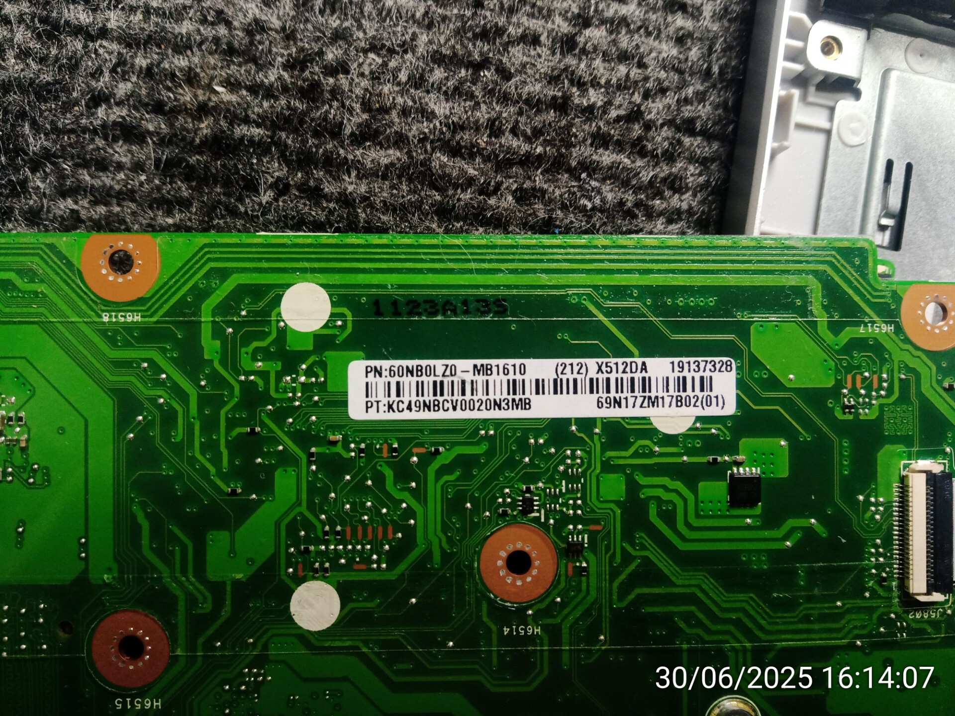

      Please, could someone explain how to edit the UEFI/BIOS image? I wll go read the BIOS guides and resources but i see too many posts asking to fix theyr bios and then they need to post serial number sticker.
      I have an Asus X512DK that i think is bootlooping after the bios itself can show something. If i connect the power charger the system goes right away to powerup all voltages (all seem ok) and the CPU is heating a lot (executing the bios code i think) and the LCD screen is power-cycling (darkens). By the symtoms i think this is a BIOS corruption.
      Best regards.

        If you post your current backup, laptop serial number (it must be typed) and a picture of the long white barcode sticker on the motherboard then someone will help.

        Escuse me because of delay (work in school and the time flyes away... by the way this is from a student laptop that i am trying to help).
        So the sticker and the original BIOS dump is attached.
        In the previous post i tought that the model was DK and then scanning the QRCode (attached) i saw that this is in fact DA model. I was wrong because of the thermal design : there are two metal plaques screewed at the mainboard - one for CPU and one for, apparent, GPU. Now i see closely that this board uses integrated GPU in CPU package. Sorry for that misinformation.
        S/N: K3N0CV10R13613B
        Best regards.

          try post #28...
          https://www.badcaps.net/forum/troubl...2d#post3626972

            please correct dump...with attached dump no picture and cpu gets hot, tested other dumps but no detect nvme. thanks

              post S/N, full name and model, motherboard model, etc.

                sn KCN0CV04Y132504, board X512DK rev 2.1, model F512D

                  X512DA

                    thanks but not detect nvme

                      Check hardware again, here is the new bios file from ASUS Homepage.

                        You were right, hardware problem, on the board, the primary power supply +12vsus was missing, caused by a failure of the BAT54SDW component in position PD8701, resolved by replacing it. Thank you
