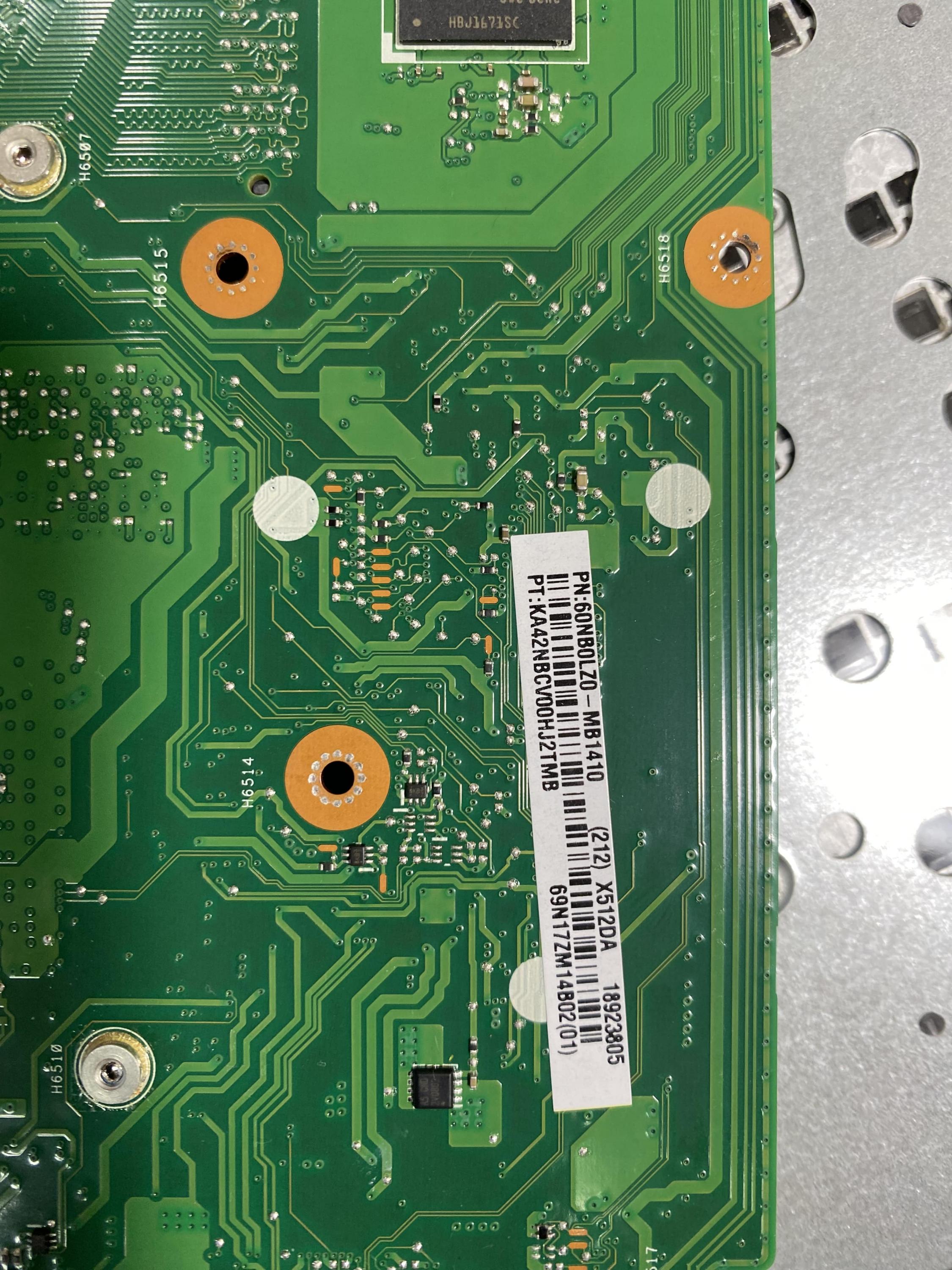

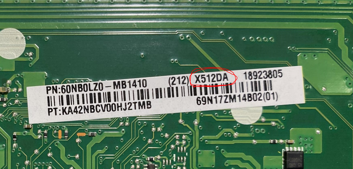

              Re: bios x512dk
              Bios From Asus Site
              mainboard code X512DK rev 2.1
              paper stamps code X512DA

                Hi all., can anyone do a cleanup for this Original BIOS dump file. With this original file, I see the White LED on the LHS glow up but still when I press the ON/OFF button on the keyboard, it does not turn on the motherboard, no increase of amp on the amp meter. I tried other BIOS dumps on this thread & other related threads, but believe it or not, NONE of them worked, the LED does not even glow in all other dumps. Mine is an ASUS AMD RYZEN 5., & on the keyboard connector pin 30 (Assuming this is the ON/OFF pin) I get 2.9v, is this ok??? Motherboard Part # X512DX Rev: 2.1 ... Thank you
                  Look for stickers and QR codes on the motherboard to accurately identify your model.
                    Here's your New Bios, it's a Virgin Bios from ASUS with your DMI and Windows Key.
                    As @hoaca388 said before, see if you have any sticker on the motherboard contains (X512DA) or something else.
                    Also see if that Serial Number matching your Serial on the Laptop cover.
                    Serial Number: KAN0CV119744437.

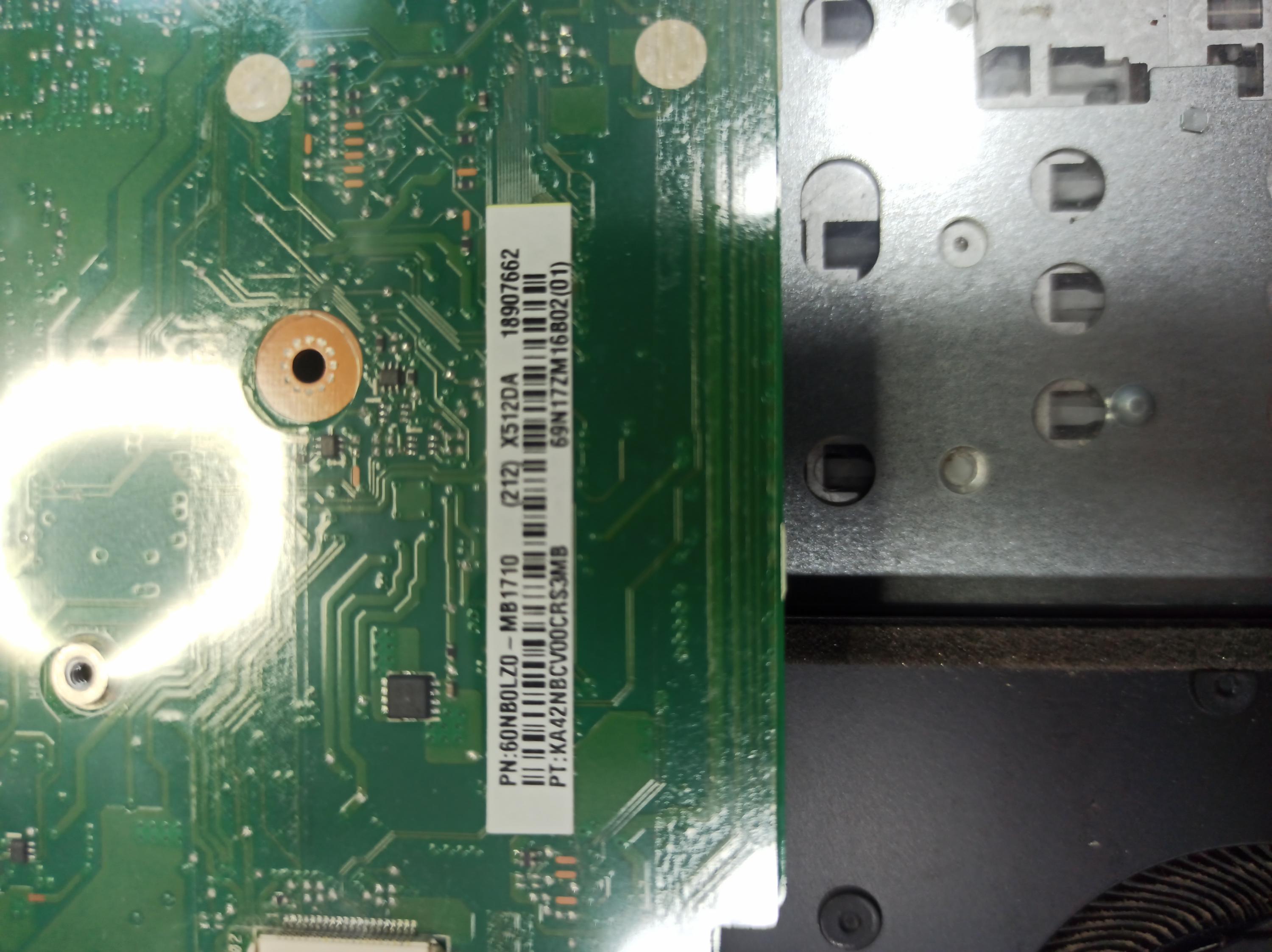

                      Re: bios x512dk
                      Thank you so much @hoaca388 @hardware1... attached are the photos of the only sticker at the back of the motherboard for you'll to review. Kindly view them.

                        Re: bios x512dk
                        Try the file in post #10 it should works fine, otherwise we can try an older version to be more precise.

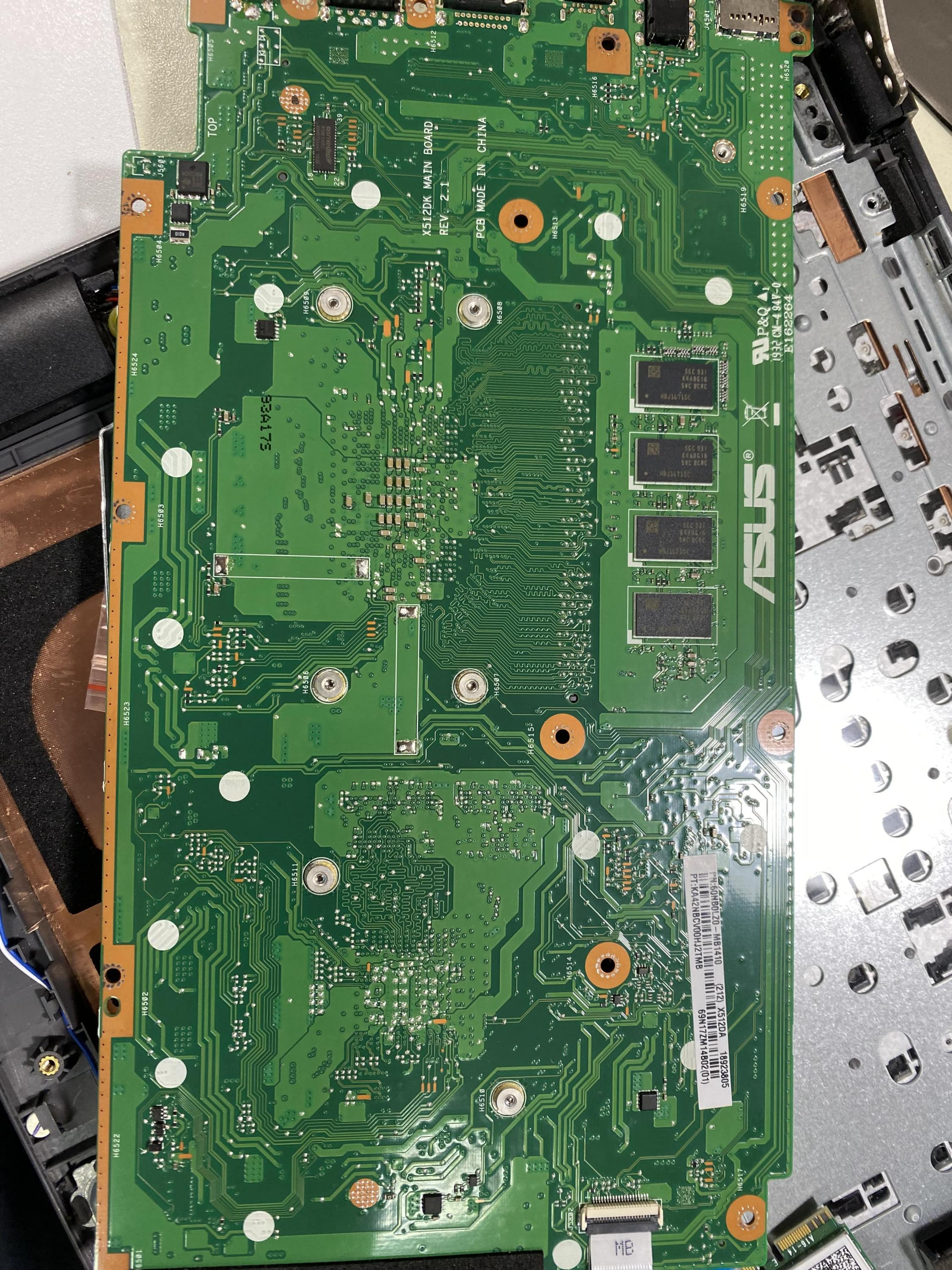

                          Re: bios x512dk
                          Just now I programmed the new BIOS on post #10, It did not work. With this BIOS version I do not get the 3.3V & 5v, all gone. But with the Original one which I posted in #8, I do get 3.3V & 5V, the LED glow WHITE but still when I press the ON/OFF button on the keyboard, the motherboard does not turn on. Where is the Older Version please inform me, I will surely try that one. Thanks for the help.

                              Re: bios x512dk
                              Thanks., I will try right now & inform you, & now I found out that I have to program the dump on a 1.8V BIOS. help appreciated @hardware1

                                Re: bios x512dk
                                @hardware1 thanks for the help, post #10 worked fine. Only my fault, I was programming on a 3v BIOS chip whereas I had to use a 1.8V chip. Once I got this chip, programmed the Bin Dump & all worked fine without any problem, really appreciate your help.

                                      Post a picture of the barcode sticker,like the one at posts ##11 and #12
                                      • Patriarxis
                                        • Jan 2013
                                        • 19
                                        • Greece
                                        Re: bios x512dk
                                        Here is it.
