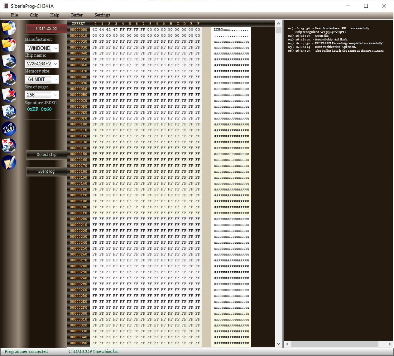

    V15-ADA 82C7 power on, charging, fan spinning but remain on blank screen (the same on HDMI out). The original dump attached, but i can't extract de Windows key with BIOSdump2license.exe (serial encrypted mesage for a short time).
    So... can anyone patch the latest BIOS: https://download.lenovo.com/consumer...s/e8cn39ww.exe for Serial: PF328XV4 and MTM: 82C7008TIX?
    Thank you in advance!

          I have patched it by myself, write it into the bios chip but still into the black screen... Can anyone verify it the patched BIOS it's should be ok with the data posted above? Thank you!
            • 21690
            #105
            Re: IdeaPad 3 14ADA5/15ADA05/17ADA05 Lenovo V14-ADA/V15-ADA Bios
            Its verified OK, you did a good job. Its worth trying an older version as well,and if that doesn`t work start looking for a hardware problem.

                Unfortunately the same, also with a a BIOS from august 2022 . So it must be a hw problem.

                  Hello all, can somebody help me for a supposed bios issue (black screen)
                  Model : lenovo ideapad 15ada05 /
                  Lenovo new Bios url : https://pcsupport.lenovo.com/fr/fr/p...loads/ds543481
                  Chip is a Winbond 64n the new bios is too big
                  1. here is the backup chip desoldered from board (no clip ^^) :
                  2. The new one, downloaded from lenovo, and extracted :
                  When i try reprogramming (ch341blackedition), he say too big
                  What did i can do ? Thank for your time

                      Ok I extracted and modified the bios like post number 1, good size now. Programming was ok, I tried multiple bios file but always black screen, not a bios issue for me.
                      Thank for your time, we can't fix them all
                      Info : for this model chip Winbond 25Q64FWSIG 1.8v i used an adapter 1.8v 25xx flash for ch341.
