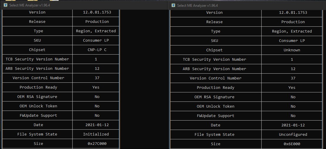

        Salam need rebuild bios lenovo thnkpad e590 i try many not working kindly build bios this i attached

                thank you dear i didn't check but in ME analyzer i got unconfigured your bios build is it work?

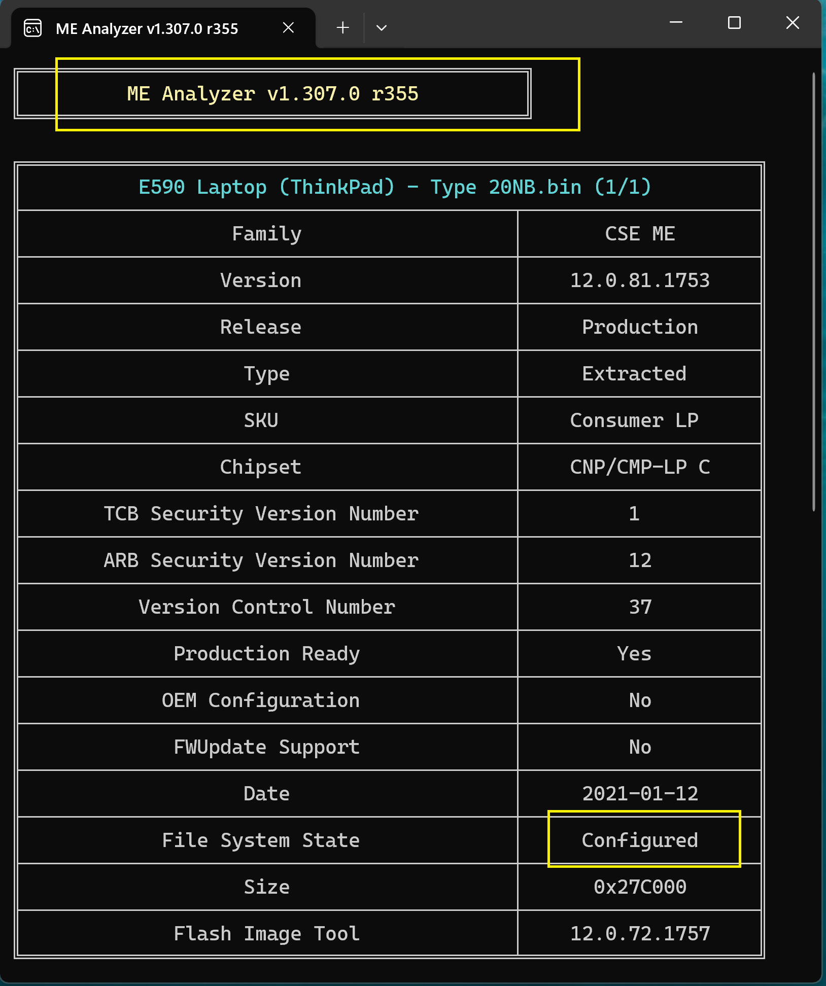

                  #88
                  ????? Click image for larger version
Name:	2024-11-26 08_16_48-Settings.png

                    #89
                    ok bro ME analyzer not up to date that's why thank you for build bios but still same issue I checked all volts are present's while pressing power btn only 1 scorned load ok then off any idea what kinda fault?
