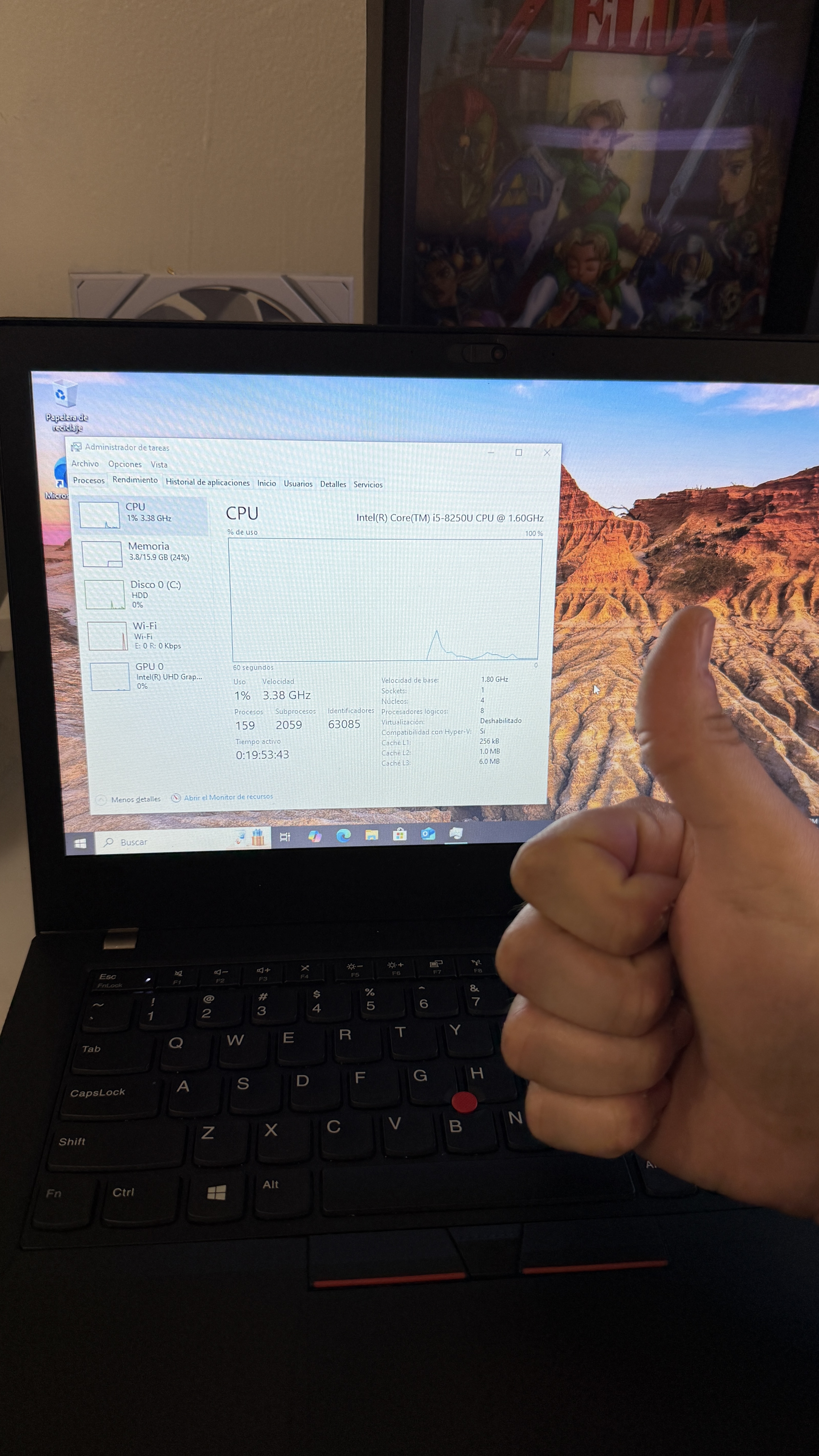

      #162
      Originally posted by SMDFlea
      Extract the attached zip folder, make a USB recovery drive with mkusbkey.bat ,boot from the USB drive and it will or should update the bios and EC.
      Thanks!, it works. IDK what the EC (Embedded Control) was, but I do a quick search on Chat-GPT explained very good even teach me how to modify hex data using hex editor programs.
ID:	3655880 Click image for larger version
        SMDFlea commented
        Editing a comment
        You`re welcome :-)

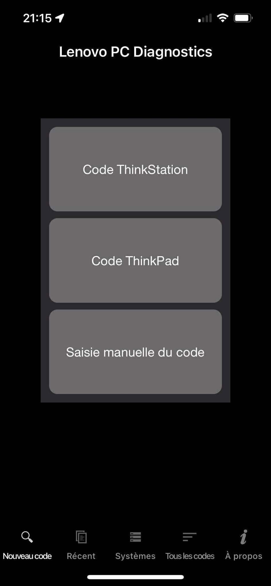

                  #169
                  Originally posted by zlo13666
                  Same issue. Possible its not bios issue
                  the keyboard responds (caps lock indicator light).
                  if yes, start by disconnecting the battery and then disconnecting the screen from the motherboard.
                  test on an external screen
                  or use lenovo diagnostic for melody

                    #170
                    error 0001. Connected to board only wlan module and ram stick. Using original charger from T15 gen2.

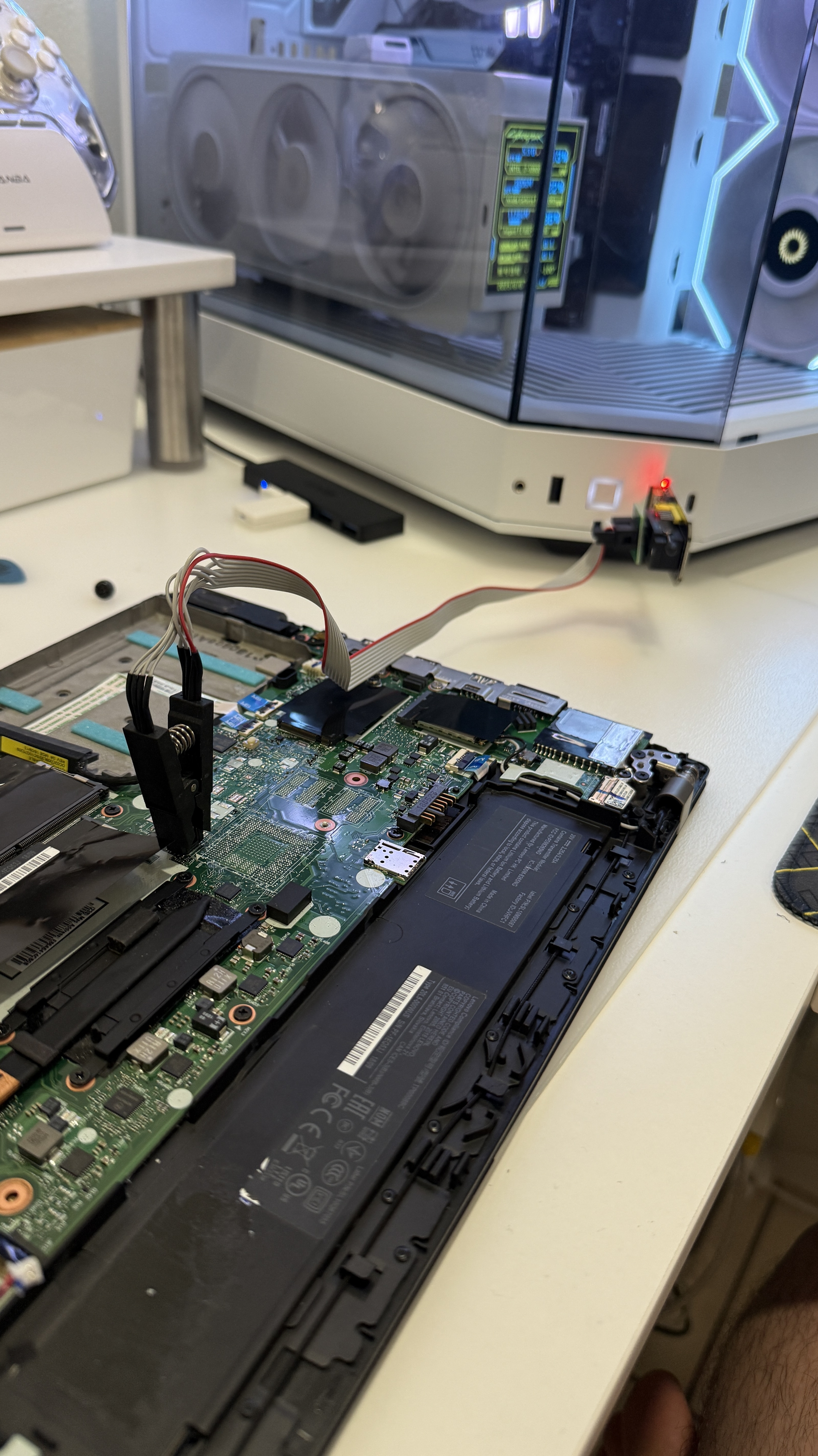

                          • JoshaintPosh
                            • Jul 2025
                            • 2
                            • England
                            #174
                            T480
                            info from bios
                            M 20L6S38300
                            S/N PF-159HEV
                            M/B L1HF88t003h
                            intel i7 8th gen
                            please Help
                            i got a bricked T480 and got my self a ch341a and flash the bios that I have attached this did not work and after trying different .bin files I tried to flash heads this work and then after re-flashing with the attached bios it worked and have done a USB bios utility update which worked since then have done a full Lenovo Diagnostics which found nothing wrong. Though, I think the PCIe cable is broken. So I have tied to boot form USB and two things have happened when I used balenaetcher is says error file '/boot/' not found and when using Ventoy and using normal boot it most often it is just blank with a _ in the top left of the screen when using grub2 and don't select anything after a few seconds it goes to Ubuntu loading screen but nothing happens if you actively select you get a load of text that according to Google Lens means something about security_inode_alloc I have also had xz corrupted data come up once have i flashed the bios wrong or is it the TB 3 flashing that is coursing it. After pressing the ESC key when Ubuntu is stuck loading, this comes up ​
                            Thanks in advance

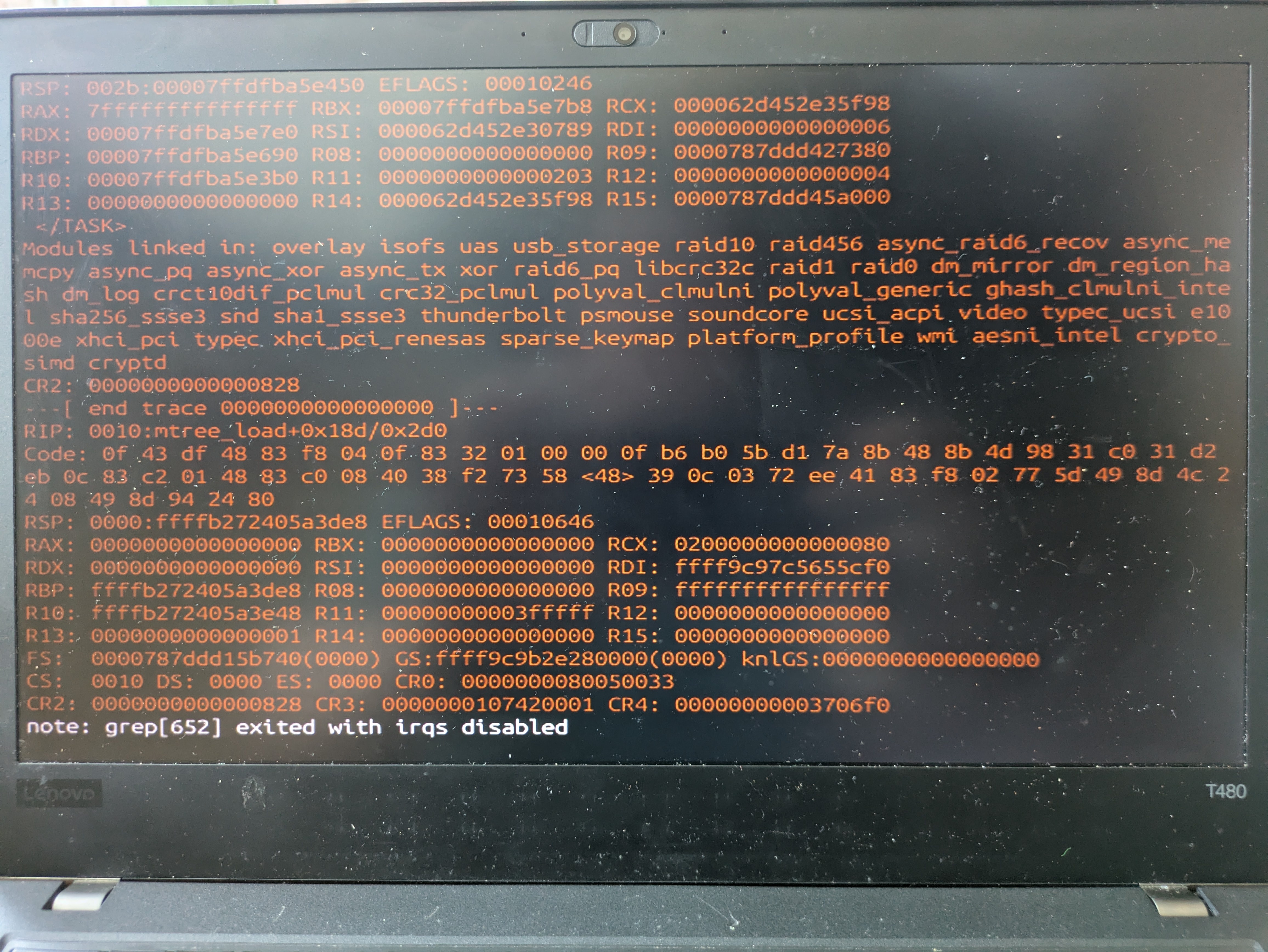

                              #175
                              S-L-O-W boot times.
                              I recently acquired a ThinkPad T480 - Type 20L6-S0HG00, Build date: 18/05, S/N: PF17SPX4, Intel i7 - 8th generation with a locked / supervisor password protected BIOS. I successfully patched the BIOS using the autopatch instructions I found on here. BIG thanks to Knucklegrumble!
                              After patching and flashing, per the instructions I set BIOS settings to their default and then updated the old BIOS that it came installed with (dated 2018) to the newest 03.2025 BIOS from Lenovo's official site. I now experience unusually long boot times that take 19 seconds just to get to the red LENOVO logo and 68 seconds to get to the Linux Mint logon screen. This is with a NVMe SSD and 32GB RAM. I have read about cleaning the ME Region. Could this be the answer to the horribly long boot times?
                              • Bunkee
                                • Jul 2025
                                • 3
                                #176
                                [ADDED INFO]
                                systemd-analyze
                                Startup finished in 31.776s (firmware) + 6.613s (loader) + 12.448s (kernel) + 14.378s (userspace) = 1min 5.217s
