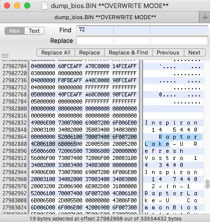

ME Firmware Cleaning Guide
  • volinakis
    replied
    Originally posted by TiagoNecer
    It worked, thank you very much!!!
    you are welcome
    Leave a comment:
  • TiagoNecer
    replied
    replace Me Region using UEFITool with ME Region extracted from another identical laptop then run MFIT, it worked for me.
    It worked, thank you very much!!!
    Leave a comment:
  • adamgouadma
    replied
    Thank you very much, it is very good
    Leave a comment:
  • volinakis
    replied
    Originally posted by testinglaptops
    Modular Flash Image Tool 16V ERROR
    I'm facing same problem.
    Decompose image
    Decomposing image C:/Users/WorkShop/Desktop/HP WORKSHOP/hp840 g9 br sn.bin ...
    Exception: Decompose 'C:/Users/WorkShop/Desktop/HP WORKSHOP/hp840 g9 br sn.bin' image failed.
    Details: 'Error occurred while trying to create container CseRegion. Reason: StorageLib error. Function "meMfsMfitInit" execution failed. Error details: Failed to initialize MFS.'
    Source: 'CsePlugin'.
    Senior's any one have solution. Please Help
    replace Me Region using UEFITool with ME Region extracted from another identical laptop then run MFIT, it worked for me.
    Leave a comment:
  • testinglaptops
    replied
    Originally posted by provcoin1999tc
    How to fix this error cseplugin CLEAR Failed ???????????????????????????
    Modular Flash Image Tool 16V ERROR
    I'm facing same problem.
    Decompose image
    Decomposing image C:/Users/WorkShop/Desktop/HP WORKSHOP/hp840 g9 br sn.bin ...
    Exception: Decompose 'C:/Users/WorkShop/Desktop/HP WORKSHOP/hp840 g9 br sn.bin' image failed.
    Details: 'Error occurred while trying to create container CseRegion. Reason: StorageLib error. Function "meMfsMfitInit" execution failed. Error details: Failed to initialize MFS.'
    Source: 'CsePlugin'.
    Senior's any one have solution. Please Help
    Leave a comment:
  • _Margo_
    replied
    Originally posted by danito
    here
    Thanks!
    Leave a comment:
  • danito
    replied
    Originally posted by _Margo_
    Hello!
    I need FIT ver 15.0.30.1776
    here
    Leave a comment:
  • _Margo_
    replied
    Hello!
    I need FIT ver 15.0.30.1776
    Leave a comment:
  • MAREBELE
    replied
    who told you is "meteor lake"? post service tag
Name:	Screen Shot 2024-10-25 at 22.55.32.png
Views:	1143
Size:	45.5 KB
ID:	3492361
    I read the spec wrong, yes it was raptor lake
    Here the model Inspiron 14 7440 2-in-1
    ST : 3QRFC24
    Leave a comment:
  • volinakis
    replied
    Originally posted by MAREBELE
    Sorry for the misunderstanding, previously is ask,
    "Is there a way to manualy or other way to edit the me without using MFIT to rebuildthe image?, my prosecor is from meteor lake which i think not yet supported by csme 16.1"
    I've read the guide by SMDFlea but csme is not yet supported my prosesor generation. If anyone know how to manually rebuild the bios image without Mfit plese let me know
    who told you is "meteor lake"? post service tag
Name:	Screen Shot 2024-10-25 at 22.55.32.png
Views:	1143
Size:	45.5 KB
ID:	3492361
    Leave a comment:
  • MAREBELE
    replied
    you CAN'T just replace ME Region with hDx and expect to work, that's why I told you to read guide made by SMDFlea how to clean ME.
    Sorry for the misunderstanding, previously is ask,
    "Is there a way to manualy or other way to edit the me without using MFIT to rebuildthe image?, my prosecor is from meteor lake which i think not yet supported by csme 16.1"
    I've read the guide by SMDFlea but csme is not yet supported my prosesor generation. If anyone know how to manually rebuild the bios image without Mfit plese let me know
    Leave a comment:
  • volinakis
    replied
    Originally posted by MAREBELE
    it seem when i edit the message the attachment got remove ive attach it again,
    and when i try to write the me to the bios dump using hdx but it gave me eror is there any exra step to take?
    you CAN'T just replace ME Region with hDx and expect to work, that's why I told you to read guide made by SMDFlea how to clean ME.
    Leave a comment:
  • MAREBELE
    replied
    well, you don't need to use MFIT to extract ME firmware from DELL update package, use DELL_PFS_Extractor and you'll have all modules for bios. You said you attached bios dump but it's nothing to attachements.
    Click image for larger version Name:	Screen Shot 2024-10-25 at 19.40.03.png Views:	0 Size:	74.4 KB ID:	3492278
    it seem when i edit the message the attachment got remove ive attach it again,
    and when i try to write the me to the bios dump using hdx but it gave me eror is there any exra step to take?
    Leave a comment:
  • volinakis
    replied
    Originally posted by MAREBELE
    Is there a way to manualy or other way to edit the me without using MFIT to rebuildthe image?, my prosecor is from meteor lake which i think not yet supported by csme 16.1,
    ive also attach the bios dump and extracted bios from dell
    well, you don't need to use MFIT to extract ME firmware from DELL update package, use DELL_PFS_Extractor and you'll have all modules for bios. You said you attached bios dump but it's nothing to attachements.
    Click image for larger version  Name:	Screen Shot 2024-10-25 at 19.40.03.png Views:	0 Size:	74.4 KB ID:	3492278
    Leave a comment:
  • MAREBELE
    replied
    With MFIT but this time you decompose your bios backup, save it, replace ME Subpartition with extracted ME Fw from update, upload saved .xml file and hit "Build" tab. Read this thread from the beginning, it's very useful.
    Is there a way to manualy or other way to edit the me without using MFIT to rebuildthe image?, my prosecor is from meteor lake which i think not yet supported by csme 16.1,
    ive also attach the bios dump and extracted bios from dell
    Leave a comment:
  • volinakis
    replied
    Originally posted by MAREBELE
    iam new at bios, ive got the FWupdate form extacted bios how can i put it back to my dump bios?. because i have no clue how to do it
    With MFIT but this time you decompose your bios backup, save it, replace ME Subpartition with extracted ME Fw from update, upload saved .xml file and hit "Build" tab. Read this thread from the beginning, it's very useful.
    Leave a comment:
  • MAREBELE
    replied
    I was struggling to find on internet ME Fw 16.1 27.2225 Corporate LP ADP A for HP 640 G10 and I had the idea to use MFIT 16.1 to extract ME Firmware from update package and ... it works!
    What I did:
    1. Downloaded bios update from HP that corresponds with my bios version (V75 01.02.03)
    2. unpack bios update and there is a bin file , in my case V75_01020300.bin
    3. Decompose V75_01020300.bin with MFIT 16.1
    4. Hit "Build" tab. MFIT will create image "FWUpdate.bin"
    Click image for larger version  Name:	IMG_1151.jpg Views:	361 Size:	4.11 MB ID:	3463742
    Click image for larger version  Name:	IMG_1152.jpg Views:	305 Size:	4.00 MB ID:	3463743
    Click image for larger version  Name:	IMG_1153.jpg Views:	306 Size:	6.63 MB ID:	3463744
    Click image for larger version  Name:	IMG_1154.jpg Views:	305 Size:	2.71 MB ID:	3463745
    iam new at bios, ive got the FWupdate form extacted bios how can i put it back to my dump bios?. because i have no clue how to do it
Name:	image.png
Views:	833
Size:	14.8 KB
ID:	3492015
    Leave a comment:
  • bondminer009
    replied
    well, you said " once want to check MEA , freeze, not appear (Blank)" , so I thought that's the problem. Use MFIT 16.1 it's obvious you are using wrong MFIT (16.0)
    my mistaken, this case happened with my post about precision 5570, freeze cant check through MEA.
    All was clear here, thank you so much
    Leave a comment:
  • volinakis
    replied
    Originally posted by bondminer009
    yes, all you're described is good enough and can understand it. after got the FWUpdate.bin, MEA can check the file but once put back into FIT got issue CSE region issue.
    in my case : ME 16.1.30.2330 and FIT 16.0.15.1545
    and try to edit using HXD also didnt work.
    Need guidance please , thank you
    well, you said " once want to check MEA , freeze, not appear (Blank)" , so I thought that's the problem. Use MFIT 16.1 it's obvious you are using wrong MFIT (16.0)
    Leave a comment:
  • bondminer009
    replied
    Steps I described were enough to extract ME firmware from update package, as you can see in photos I had no trouble to open it with MEA. Tell me what update package you used, I will try myself and see what happens.
    yes, all you're described is good enough and can understand it. after got the FWUpdate.bin, MEA can check the file but once put back into FIT got issue CSE region issue.
    in my case : ME 16.1.30.2330 and FIT 16.0.15.1545
    and try to edit using HXD also didnt work.
    Need guidance please , thank you
    Leave a comment:
