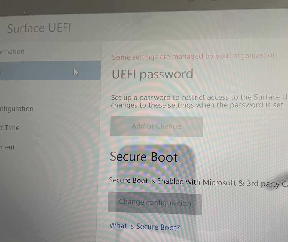

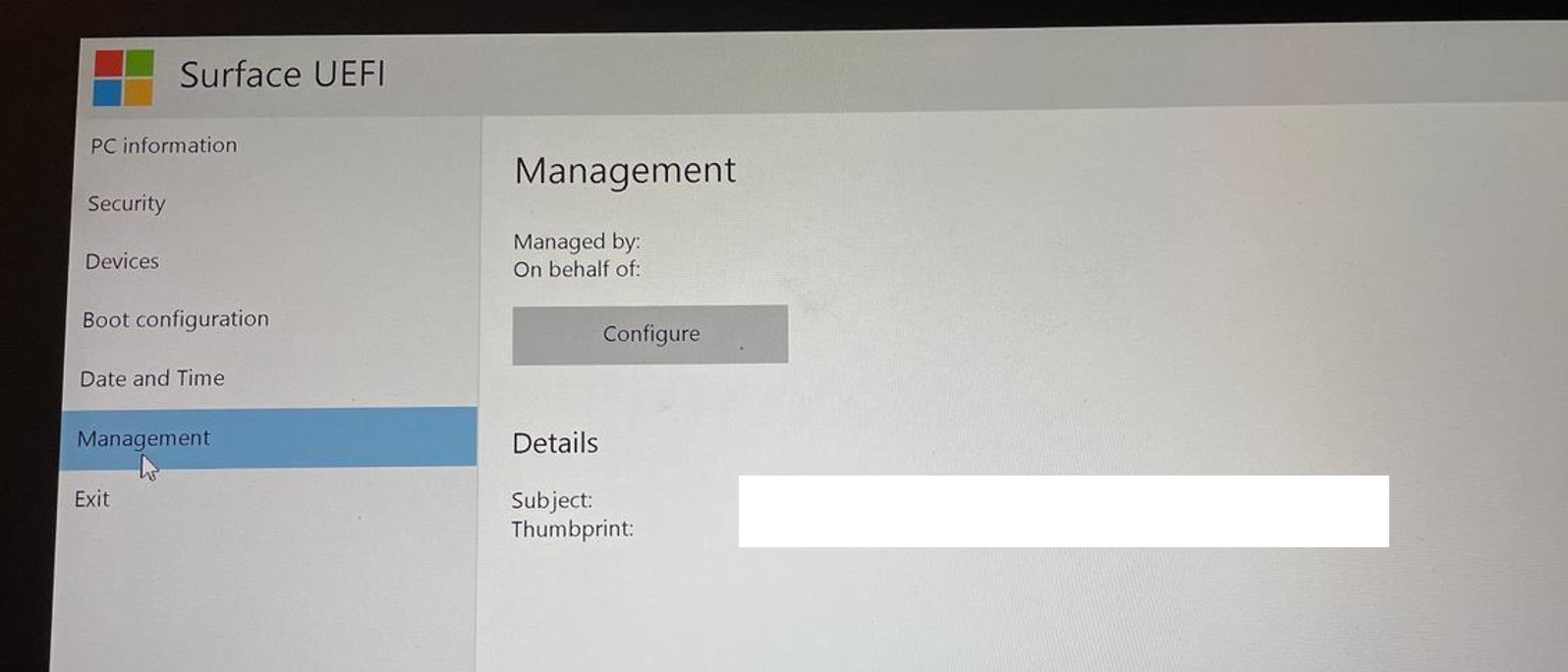

      Surface Pro 1796
      Hi
      I have a Surface Pro 1796 (Gen.5). A bios password is set. I know the password but I can't change it. I can't change all the other options either, such as Security, Secure Boot, m TPM SMT etc..
      It also says "some settings are managed by your organization"
      Is it possible to flash the bios again so that I can use all options? Are there other solutions so that I can use the device to its full extent?
      note the attachments.

        #103
        Re: Surface Pro 1796
        Originally posted by t000
        Hi
        Regards
        post the original bios ..

            #105
            Where can I find instructions on how to save the bios?
            Regards
            you need an SPI programmer ...
            you can find more videos on the internet >>
            https://www.youtube.com/watch?v=DWWigscuQDY
