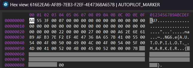

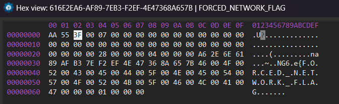

                  For MDM/Autopilot lock, this is how to remove...
                  In the NVRAM, there are two NVARS we want to invalidate, these are FORCED_NETWORK_FLAG, and AUTOPILOT_MARKER. We do this by changing the NVAR valid flag to invalid.
                  FORCED_NETWORK_FLAG for me was at 0x604D7Ch, 3Fh changed to 3Ch.
                  Click image for larger version  Name:	fnf.png Views:	0 Size:	48.1 KB ID:	3490241
                  AUTOPILOT_MARKER for me was at 0x605EA4h, 3Fh changed to 3Ch.
                  Click image for larger version  Name:	am.png Views:	0 Size:	48.5 KB ID:	3490242
                  I also invalidated AName, and SetOEMStrings, but i'm unaware if this is absolutely necessary. Maybe someone can give me feedback.
