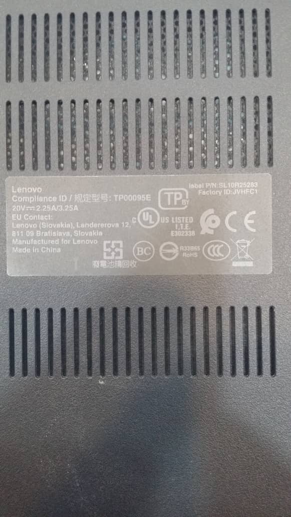

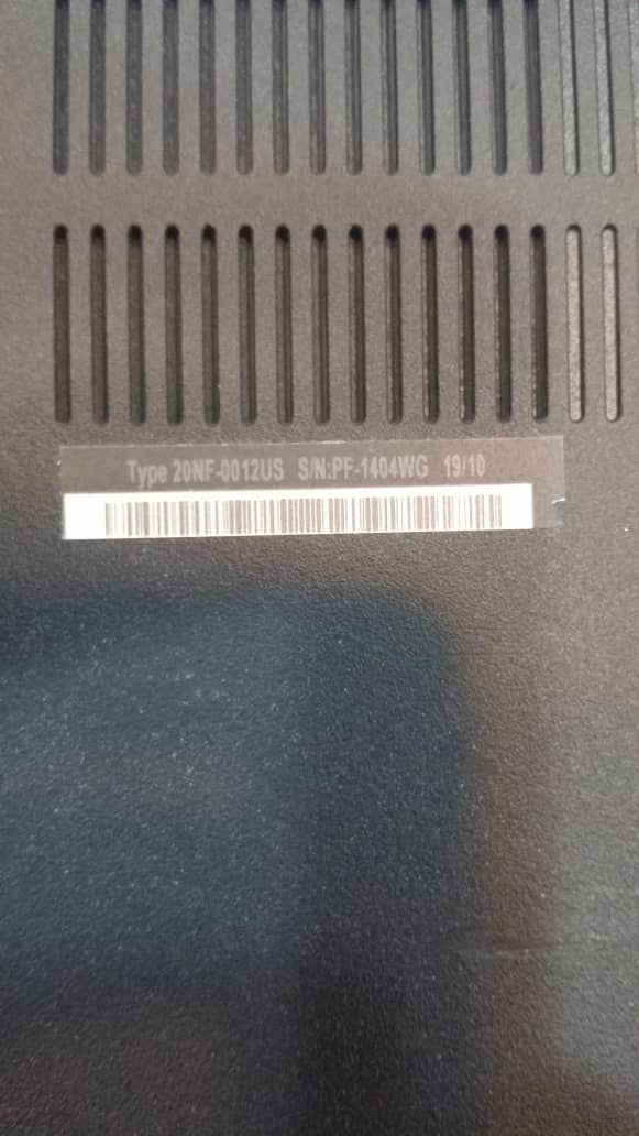

                                  • onizzbox
                                    Banned
                                    • Nov 2018
                                    • 604
                                    • Brazil
                                    #1137
                                    Re: LENOVO BIOS AUTO-PATCHER for Supervisor Password Removal
                                    Originally posted by ak1_2004
                                    when use this , laptop dont bootup ! dont show anythings !
                                    thanks for anwer
                                    @ak1_2004
                                    Inform more details of this model, a photo of the cover would be ideal
                                    • ak1_2004
                                      • Oct 2017
                                      • 42
                                      • Iran
                                      #1138
                                      Originally posted by onizzbox
                                      @ak1_2004
                                      attached
