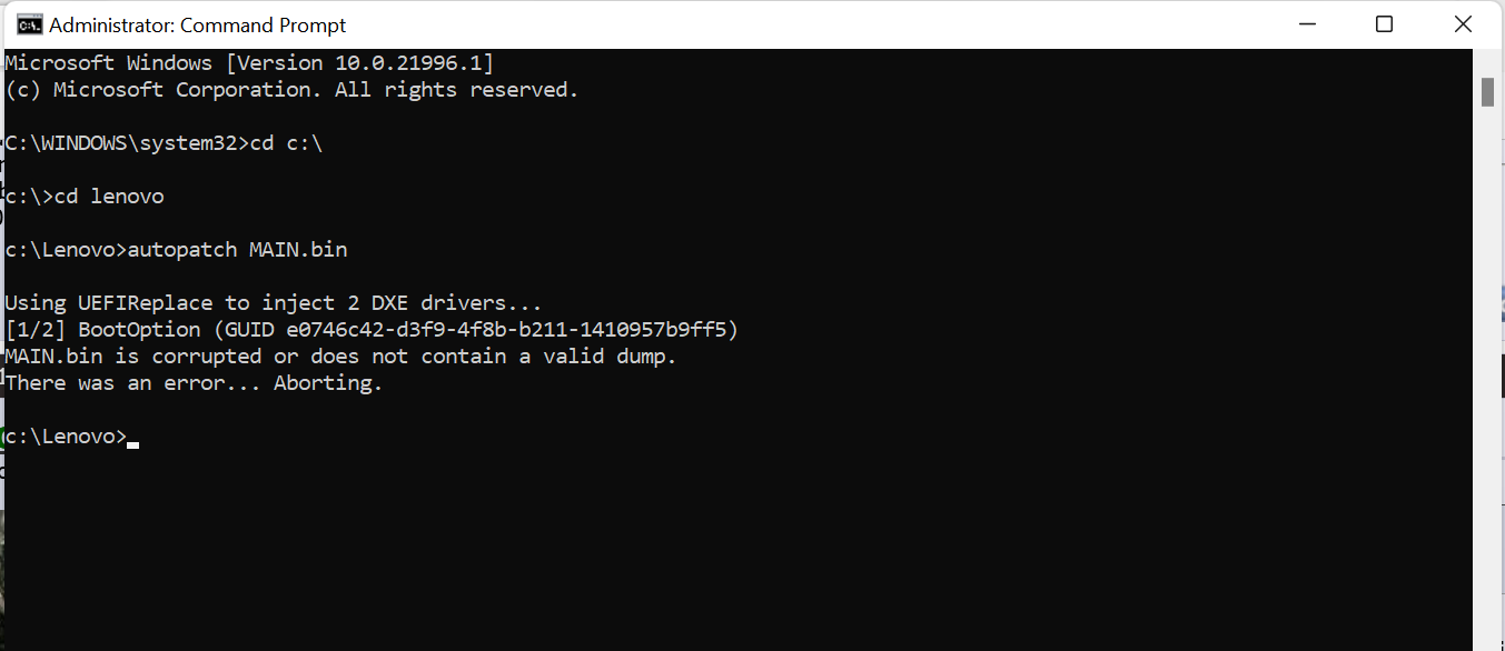

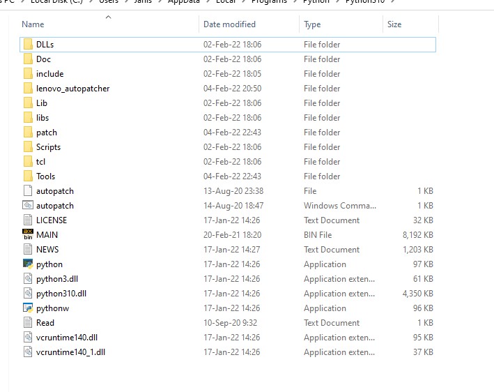

                      #1290
                      Re: LENOVO BIOS AUTO-PATCHER for Supervisor Password Removal
                      Originally posted by CornholioGSM
                      ...put all files from autopatcher folder into root of python folder, then drag and drop origbios.bin to autopatch.cmd
                      Still no luck. Everything in Python310 folder, including the .bin file, but same problem
                        • 22161

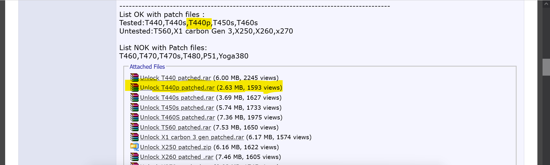

                        • stars-n-dust
                          • Apr 2019
                          • 59
                          #1292
                          Originally posted by SMDFlea
                          What model is it you`re trying to patch.
                          T440p, dump attached

                          • Vesko356
                            VIP Moderator
                            • Aug 2018
                            • 4386
                            • Bulgaria 🇧🇬
                            #1293
                            https://www.badcaps.net/forum/showthread.php?t=81573

                            • Vesko356
                              VIP Moderator
                              • Aug 2018
                              • 4386
                              • Bulgaria 🇧🇬
                              #1294
                              BTW your dump doesn't look good, so I'll suggest to read your bios chip again, and this time use verification, or you'll have a big problems (at step 8)!

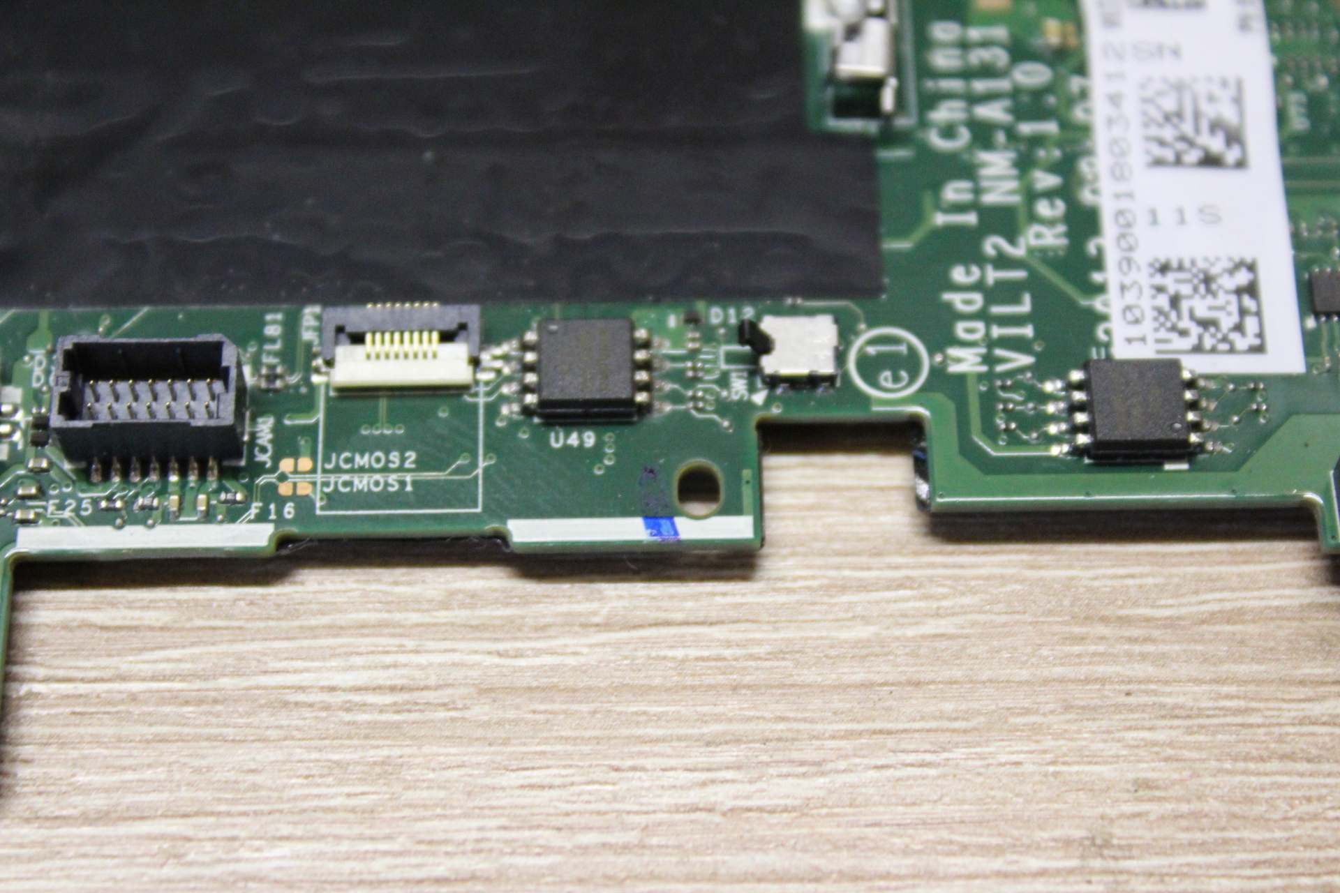

                                #1295
                                Hello, nobody noticed that this is the wrong BIOS file. (8MB)
                                On a Lenovo T440p there are two BIOS chips one 8MB and one 4MB.
                                Only the 4MB can be patched.
                                The left Chip U49 is the right one.
                                It's a Winbond 25Q32FVSI0 Chip
                                Believe me I've unlocked four Lenovo T440p already.
                                Good luck ...
