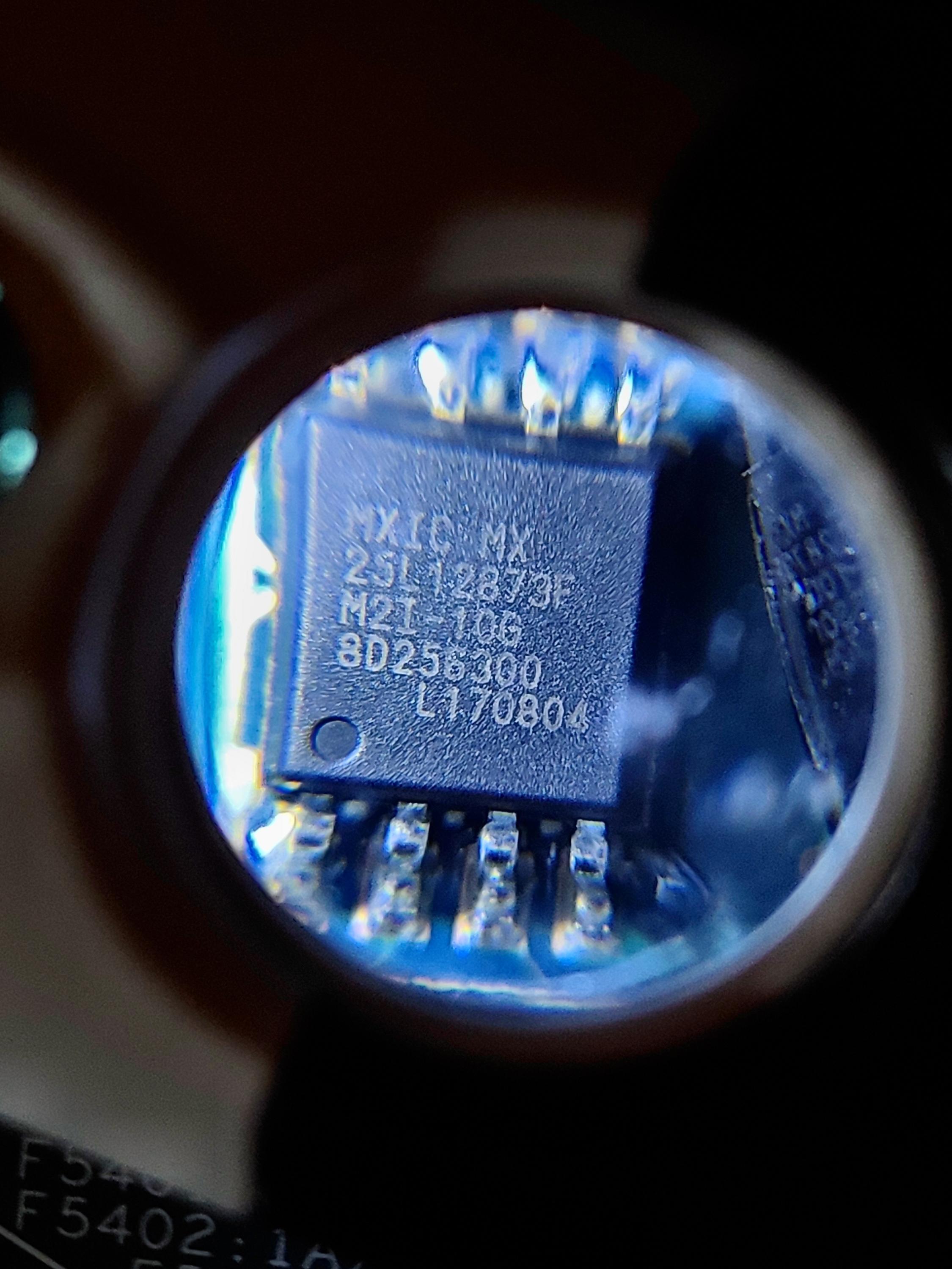

      • malakas1
        • Oct 2021
        • 6
        #943
        Re: LENOVO BIOS AUTO-PATCHER for Supervisor Password Removal
        Is this my Bios Chip?

          #944
          @malakas1
          That’s your ThinkPad BIOS chip, made by Macronix (MX), it’s a CMOS type chip which is susceptible to Electro Static Discharges (ESD).
