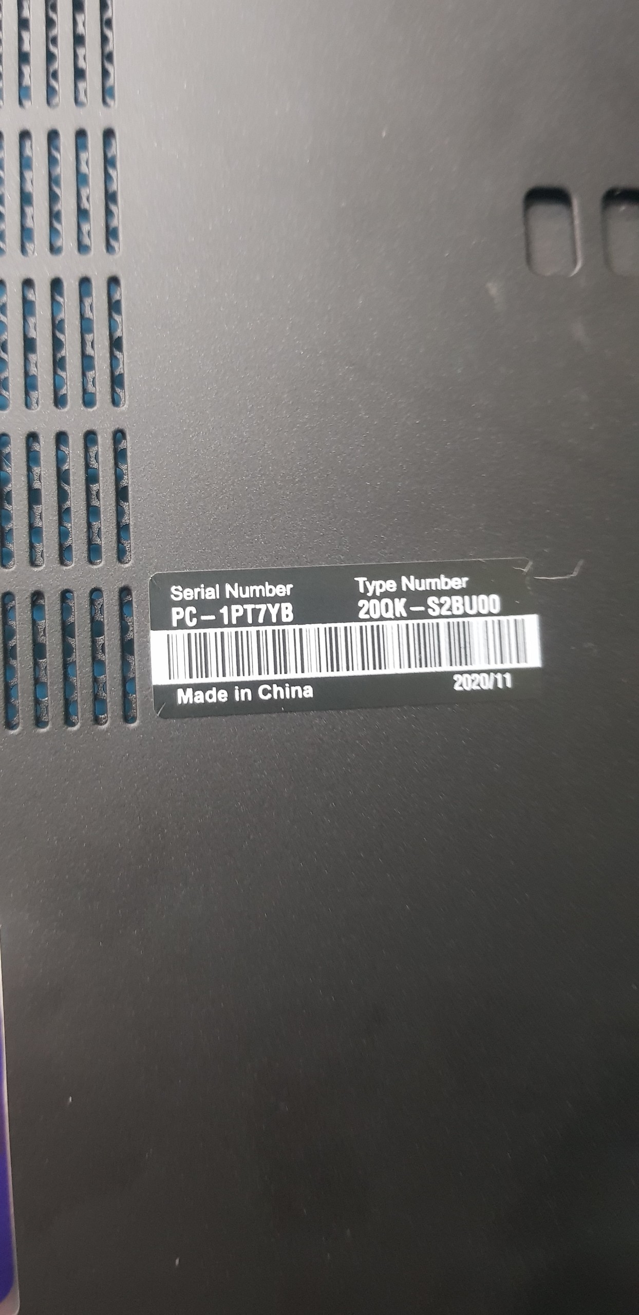

                                        • minhduc18
                                          • Mar 2021
                                          • 32
                                          • viet nam
                                          #1100
                                          Re: LENOVO BIOS AUTO-PATCHER for Supervisor Password Removal
                                          Originally posted by onizzbox
                                          @minhduc18
                                          What is the prefix after the model?
                                          A.g (20NJ, 20NK)
                                          it is: 20QK
