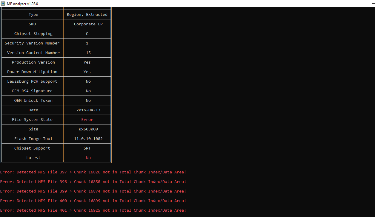

          hi i try patch this t460 file after turn on laptop 5 beeps and not video.
          can one help to patch plz ?

              I'm afraid your original BIOS file was corrupted.
              I tried to clean the ME region.
              There's no harm in trying.
              Good luck ...

                markus1741 also try the file you upload
                thanks
