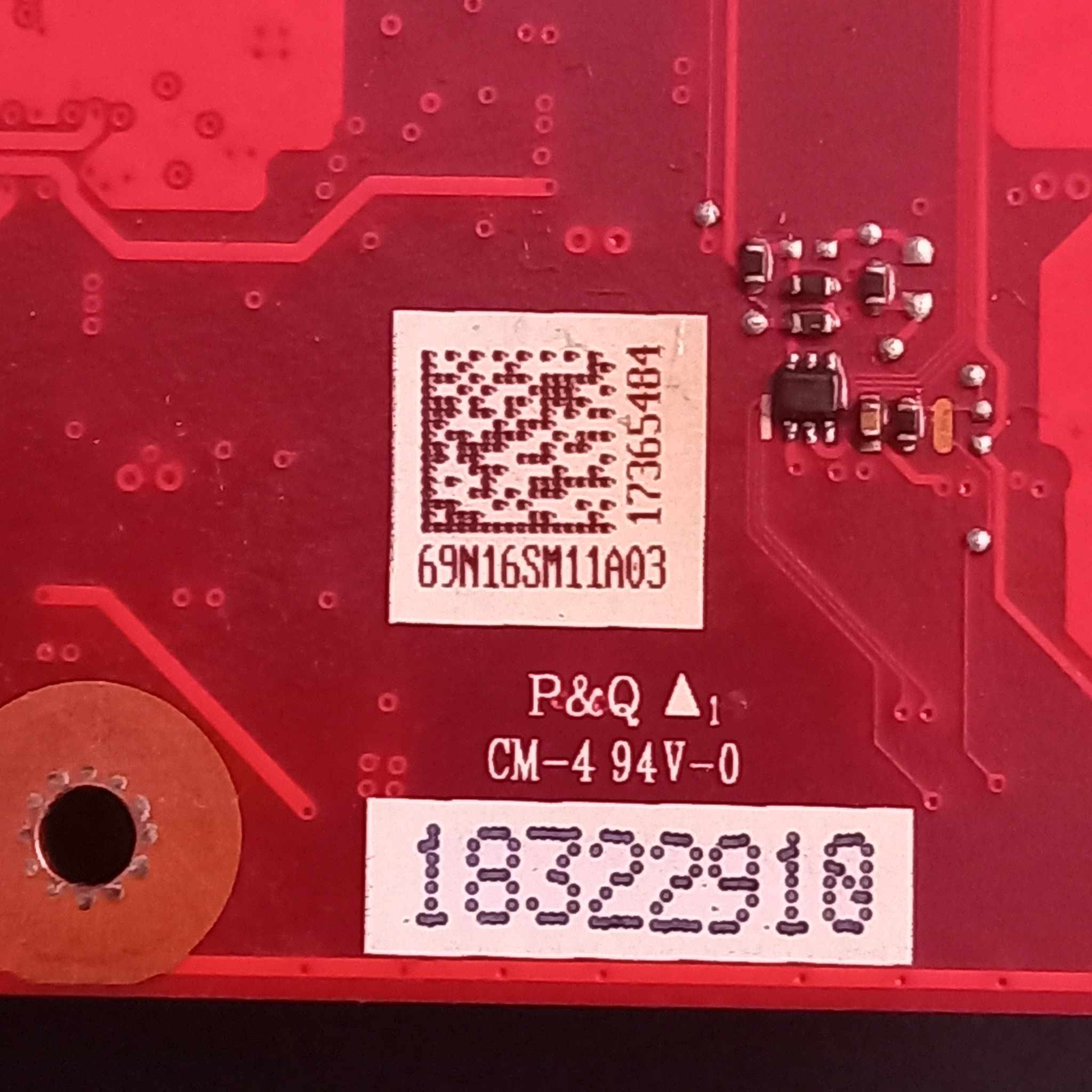

          Re: ASUS ROG GX531GW BIOS Request
          Perhaps this BIOS will help you, try it.
          If it doesn't work, take an image for any QR code/Bar code sticker on the motherboard and post it here.
          thankyou so much for your effort , and , but its similar to above GX531-F1 image which i have already tried, but still it does not hurt to try again. . .. will try and let you know . . till then here are the QR image and also MEanalyzer error for that bios , could be the reason for not working . . . thankyou again.

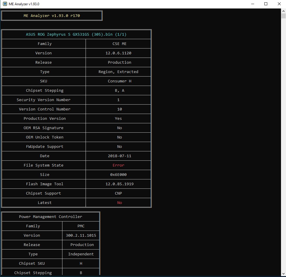

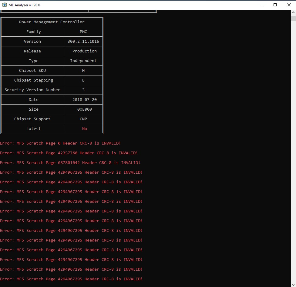

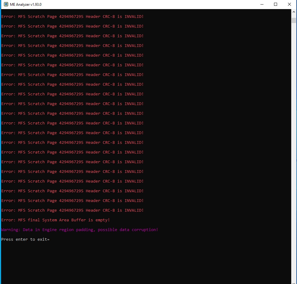

            Just try my file and see what will happen. You got errors by ME Analyzer because you are using an old version. This isn't the correct QR code, search for another one, it could be on a sticker or printed on the board.
              OMG , my life was a lie, i thought i was using the latest , didnt check. and luckily version r329 just been arrived, so that means you too now using old version. . . .
              .. and thanks alot. .. . . . i will give it a try. . . . abd about QR, i dont see anywhere else, just many barcodes. .which i share here . . .
