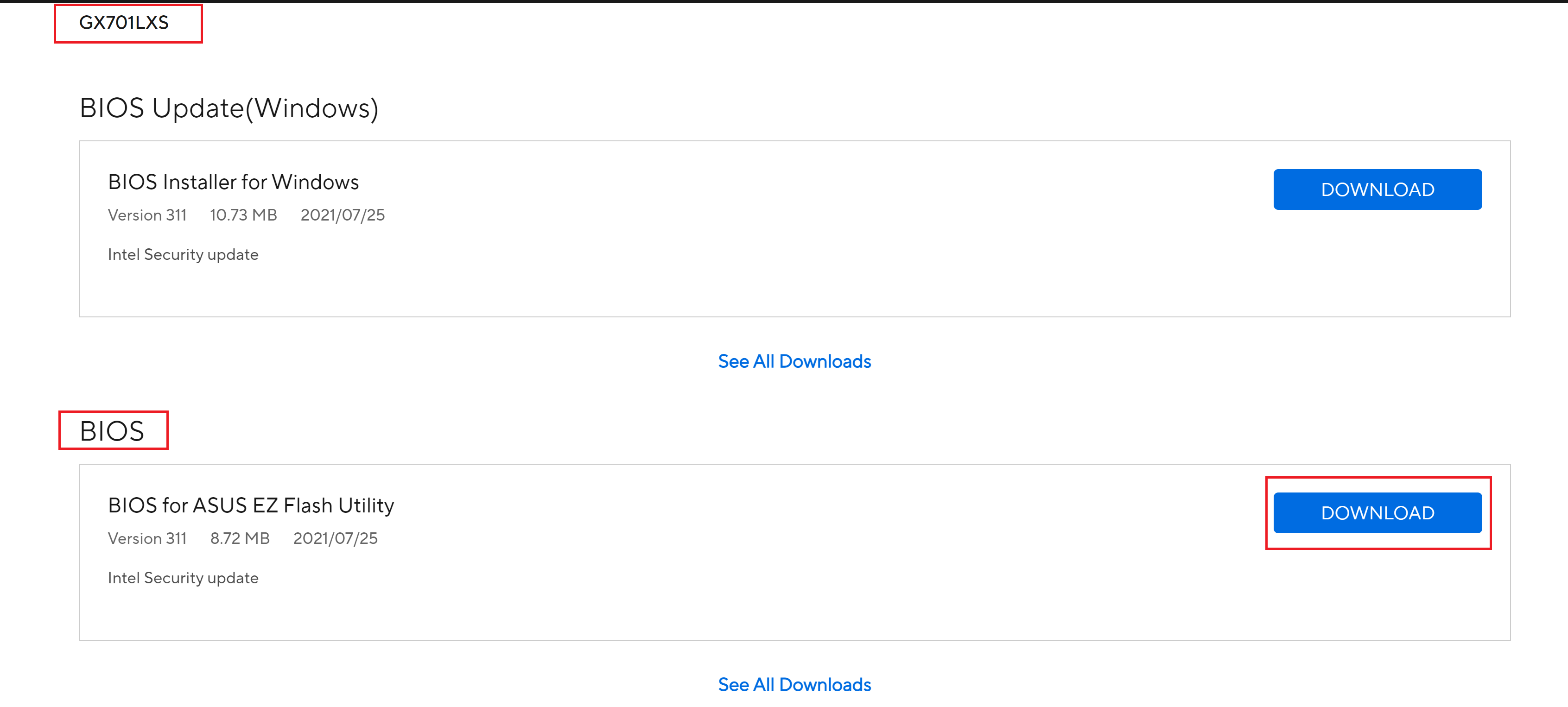

    I've downloaded the latest BIOS version, "GX701LXS-AS.311" (v.311), from the ASUS website.
    However, there's a challenge – the file size exceeds the capacity of the BIOS chip, making it impractical for writing.

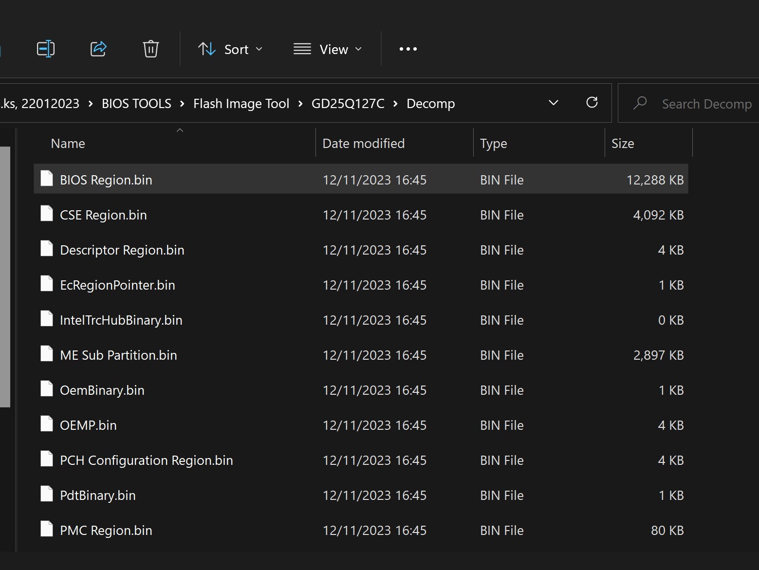

    The current BIOS dump ("GX701LXS.307 bios-dump.bin" find attached), is of version 307.

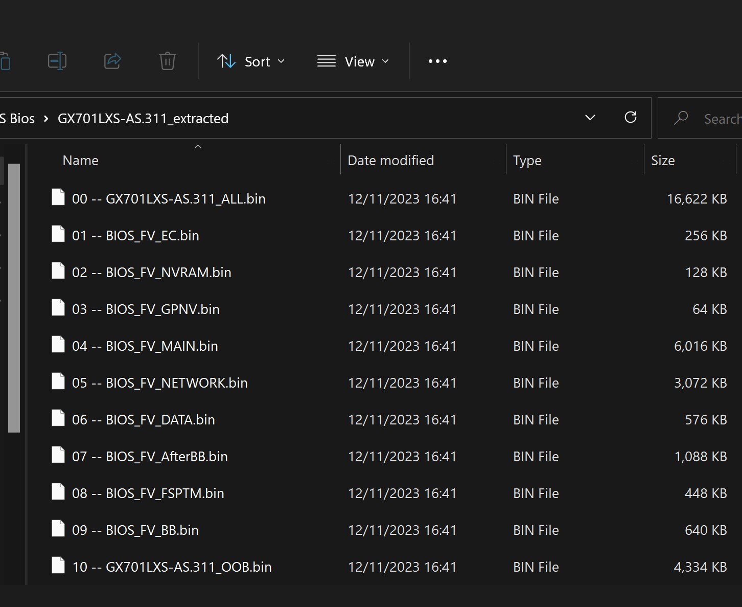

    My attempt to extract "GX701LXS-AS.311" using the "AMI_BIOS_GUARD_Extractor" was aimed at combining the dump with the updated 311.
    Unfortunately, I've encountered an obstacle: the "BIOS Region.bin" in the dump is 12.288 KB, while the main BIOS on the updated version is only 6.016 KB.

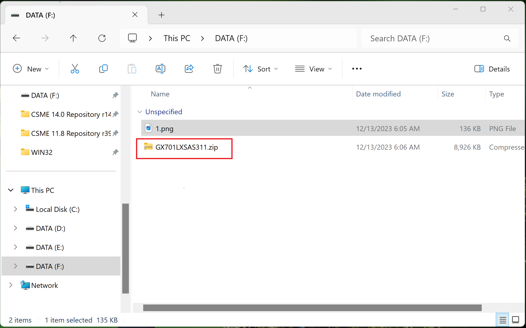

      Attached, you'll find a zip files containing the original BIOS dump and the latest BIOS from ASUS website and the extracted/decomposed files.

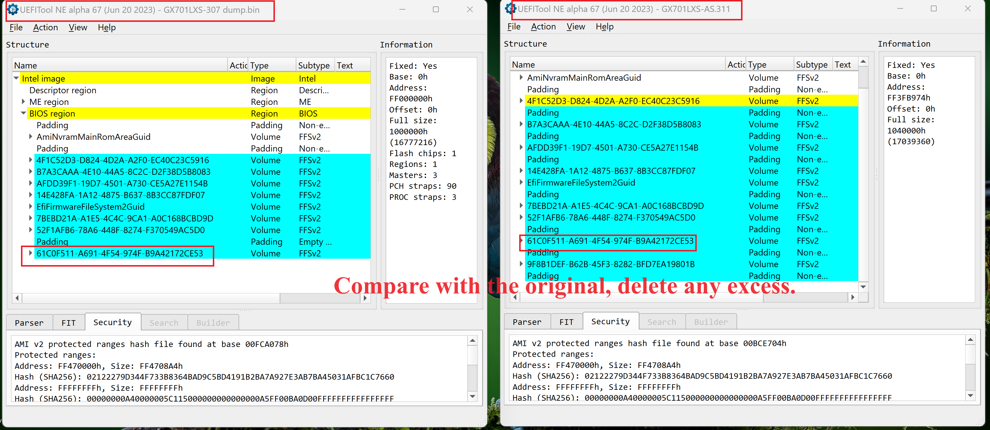

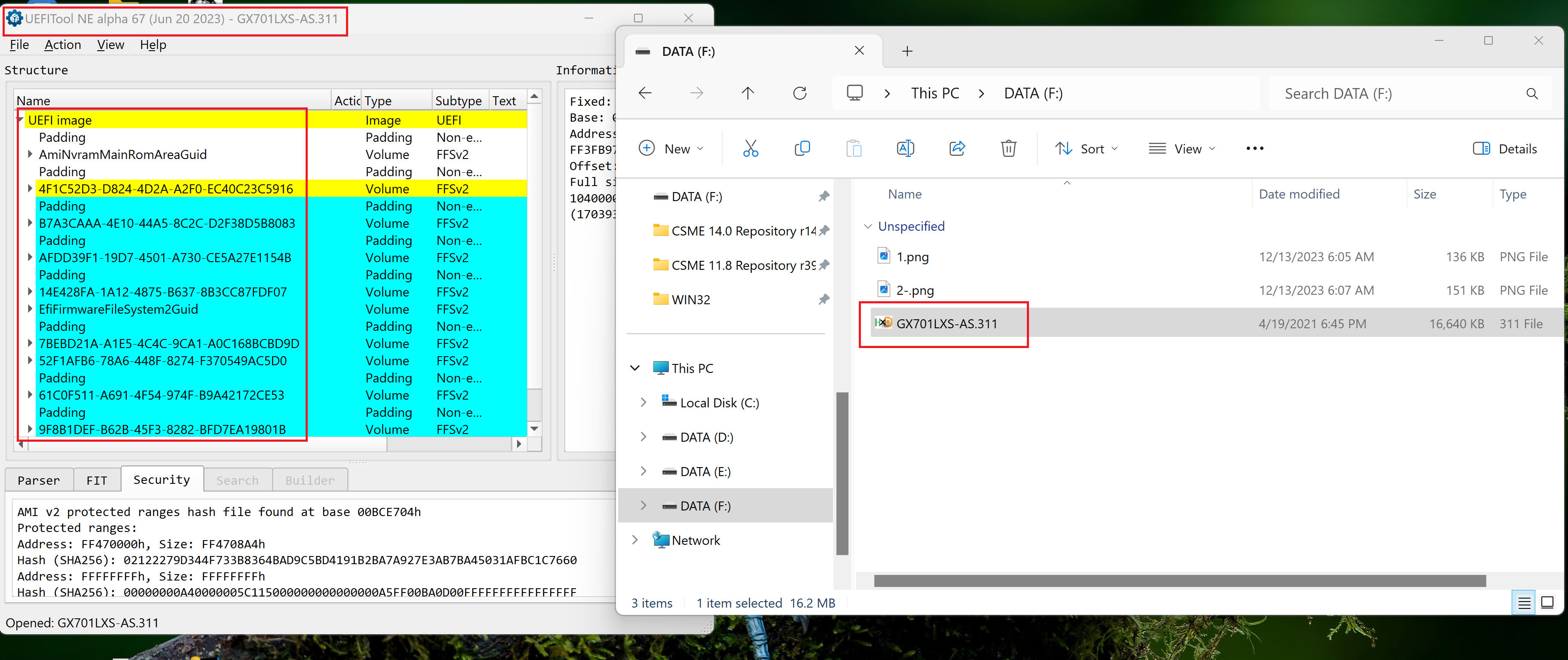

              Ok, look at the pictures, pic 2 , extract by winrar.

                Amazing! @hoaca388​ thank you for sharing this info.
                I downloaded the latest ASUS BIOS update, v311, which I believe is 256K larger than the existing dump.
                Using the appropriate FIT, I extracted the dump and utilized AMI BIOS Guard to break down the v311.
                The objective was to get the BIOS region from it, in order to replace and rebuilding the dump.
                However, the file from v311 turned out to be smaller than the BIOS region in the original dump.
                With the original BIOS the laptop powers on, but doesn't post. With the new BIOS, it's stuck on bootloop.
                Do you have any idea on whether the issue lies with the new BIOS or if there might be something else causing this behavior?
