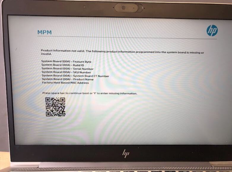

          • magneh
            • Apr 2014
            • 627
            • Portugal
            #665
            Originally posted by Stefan Steff
            Try this new BIOS with cleared ME Region.
            Leave the EC (16MB) as is.
            Here is your DMI info based on EC chip info (the BIOS content is corrupted)
            Description: HP EliteBook 840 G6
            Serial Number: 5CG93325H3
            Product Number: 4WG26AV
            Board CT Number: PHWHN00WBCM389
            BuildId(BID): 19WWCFAT603#SABB#DAB9
            Feature Byte: 3X476J6S6b7B7H7M7Q7W7m7saBaEapaqauawbUbhcAdUdpdqfAfPhKhkjhk8.BQ
            MAC Address: F8-B4-6A-EE-86-99
            Hello Stefan Steff!
            Thanks for the help and the file!
            I've flashed it, but as soon as plugged in , it does a weird blinking sequence and does not power on at all.
            With the original it turns on but shuts off after HP logo...

              • magneh
                • Apr 2014
                • 627
                • Portugal
                #667
                Give some time...yes there are "weird" blinking sequence (orange-white) but it will start after a time...sometimes even 3 - 5 minutes...if there are no other issues.
                Hi Stefan Steff
                Its only a weird blinking in white, and no boot at all.
                There is no other issues besided that with original bios, only HP logo and off.
                Does not seems to be a working dump but Ill leave the machine 1h turned on to be sure

                                • magneh
                                  • Apr 2014
                                  • 627
                                  • Portugal
                                  #677
                                  Hello Stefan Steff!
                                  I had a bit of time today to come back to this machine, and my bad, the machine is booting with your dump.
                                  It happears as in MPM mode, and after it rebooted many times I got the screen to enter the DMI info.
                                  Would you be able to help/guide me to do so?
                                  Appreciate your time, if you have it.
                                  best
                                  • Stefan Steff
                                    • Mar 2024
                                    • 399
                                    • Romania
                                    #678
                                    Originally posted by magneh
                                    Hello Stefan Steff!
                                    best
                                    OK, so here is your DMI info, It has all info you need:
                                    Description(Product Name): HP EliteBook 840 G6
                                    Product Number(SKU): 4WG26AV
                                    Take a look to this video and you will do it 100%.
                                    https://youtu.be/BQZfKxjwYU0?si=6oJ9OzkvVyegwY-7
                                    Good Luck.
