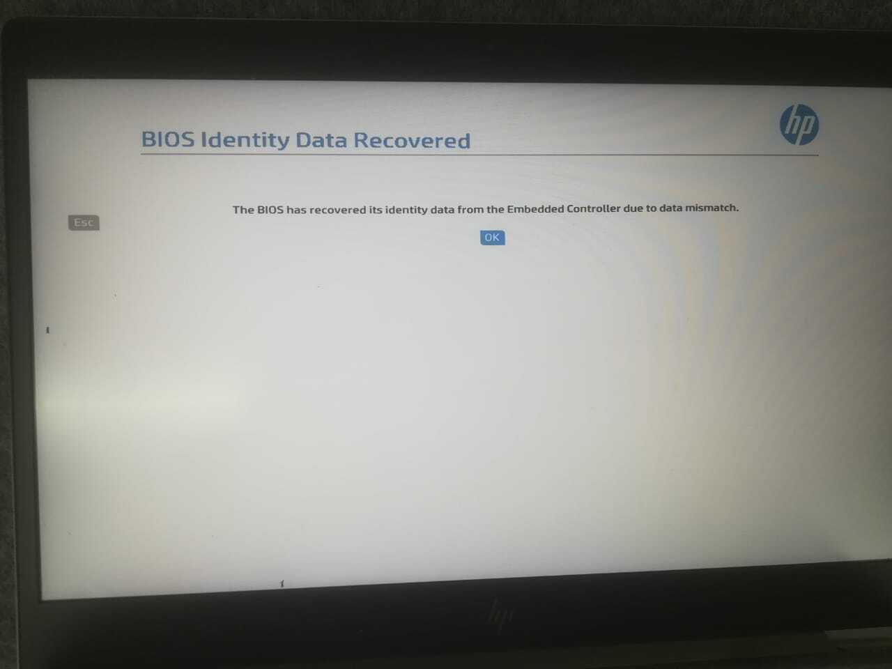

                        #611
                        Originally posted by hoaca388
                        HP EliteBook 840 G6 Notebook PC IDS Base Model
                        please help sir,
                        my laptop problem no power & no display
                        when i write another 32mb bios 1st time display come then error message and restart again no display problem.
                        i attched orginal file and image
                        s/n: 5CG9275DNL

                          #612
                          Originally posted by faisalhabib
                          please help sir,
                          s/n: 5CG9275DNL
