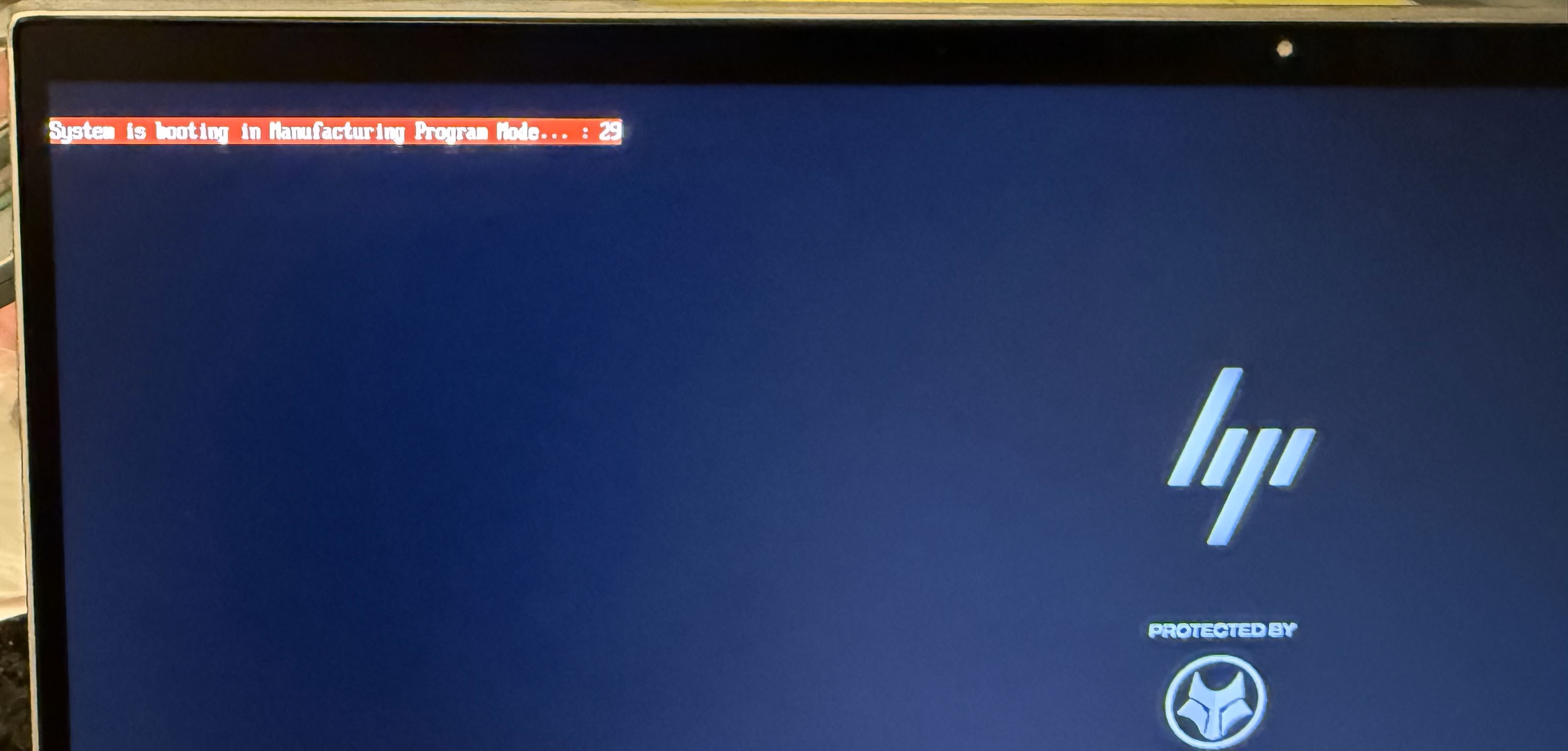

                        I have an HP x360 1040 G8 laptop and I am having issues with my endpoint security.
                        I ran the script and reprogrammed the BIOS but without success
                        After turning on my laptop this message was shown on the screen.
                        Every time the laptop was turned on, the counter decreased by one.
                        Initially, the counter showed the number 34. After turning it on and off 34 times, the message changed to show this new message and the counter remained at the number 1.

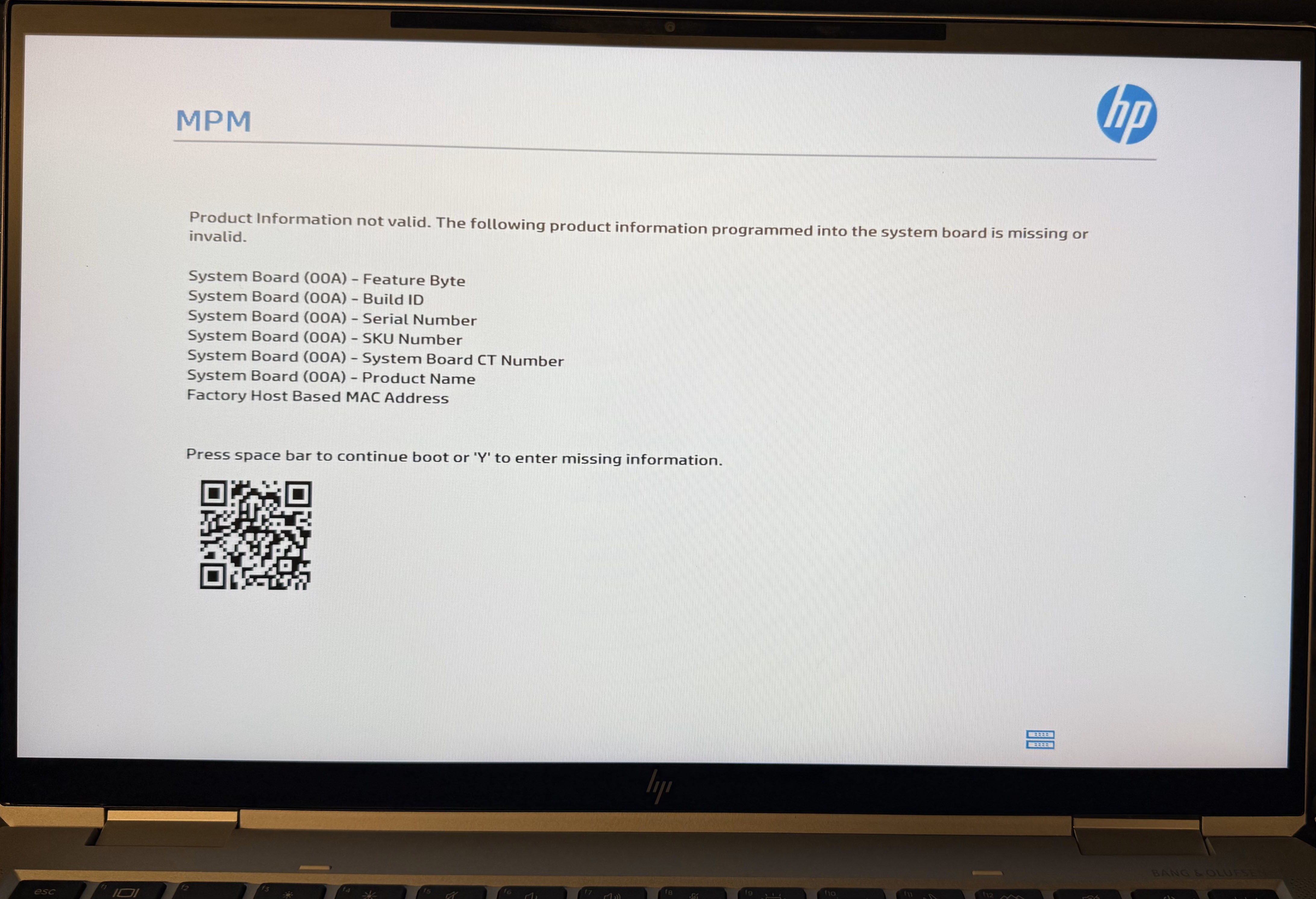

                        Now Windows will not boot and the laptop will only enter the BIOS program.
                        Can anyone help with this problem?
                        I have attached my script file and my BIOS backup file for further review
                        The endpoint.bin file is the BIOS file after running the script and the endpoint.bin.bak file is the original BIOS version of my laptop.​
                          SMDFlea commented
                          Editing a comment
                          Flash the endpoint.bin bios again, then use HP Bios Config Utility to enter all DMI ,and then lock MPM.
