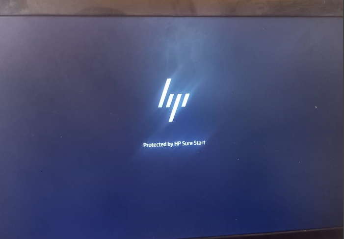

          my laptop no display:hp 840 g6 6050A3022501-MB-A01
          SN# 5CG014CJ3G​ ,i used your bios posted her it's working but just with this picture please help.
            Check hardware.

              #486
              Originally posted by hoaca388
              Check hardware.
              no probléme with hardware.because before i didn't get display.If you have a good dump i
              appréciate it.thanks.

                #487
                Thanks bro, your bios works for a few seconds and the laptop shuts down. It does this for some bios that I have tried. Does anyone have a solution. Thanks.
                I told you to be patient.
                Rremove battery , disconnect even the 3V cell , write my version of BIOS, plug in the charger and go for a walk for 30 minutes, or take a nap. Do not touch any buttons not even the power button ...
                If your hardware is OK as you say the laptop must start in MPM mode.

                  #488
                  PLZ,send me EC bios you have used.

                    #489
                    Here it is

                      • SI3MAR2000
                        • Apr 2018
                        • 52
                        • MOROCCO
                        #491
                        I solve display issue with this dump.thanks for help.
