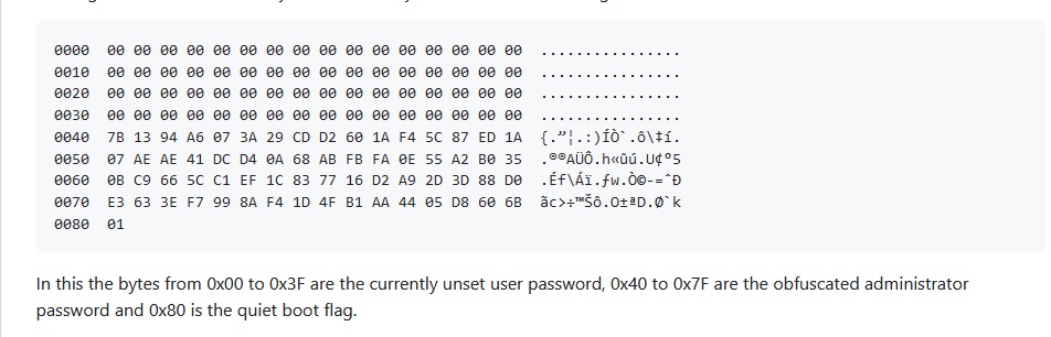

                            • Maxpower3
                              Bad Veteran
                              • Feb 2018
                              • 1312
                              • France
                              #354
                              Re: Panasonic CF-54 Bios Password
                              Originally posted by imran421
                              Powers on blank screen. Can you please recheck?
                              try

                                  • imran421
                                    • Apr 2020
                                    • 80
                                    #357
                                    try
                                    this one worked
                                    • Maxpower3
                                      Bad Veteran
                                      • Feb 2018
                                      • 1312
                                      • France
                                      #358
                                      this one worked
                                      normal, I know that the 01 at the end must remain. It is useful for boot logo
                                      • Vesko356
                                        VIP Moderator
                                        • Aug 2018
                                        • 4386
                                        • Bulgaria 🇧🇬
                                        #359
                                        No, I know what you mean but it's not the case here, imran421 just failed to program the chip properly in its first attempt. The bios should work just fine even without "the 01 at the end".

                                        • Maxpower3
                                          Bad Veteran
                                          • Feb 2018
                                          • 1312
                                          • France
                                          #360
                                          you're probably right, just a silent start indicator.
                                          The main thing is that it is successful
