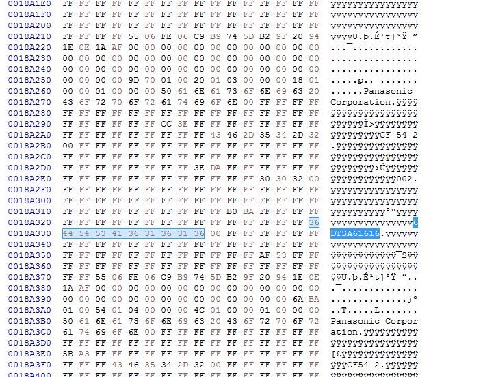

            Hey Bro I’m not sure if this is the right place to ask, but can anyone change the model and serial number on a CF-54 for me? I’m a bit stuck and really need this device.
              • 21830
              #666

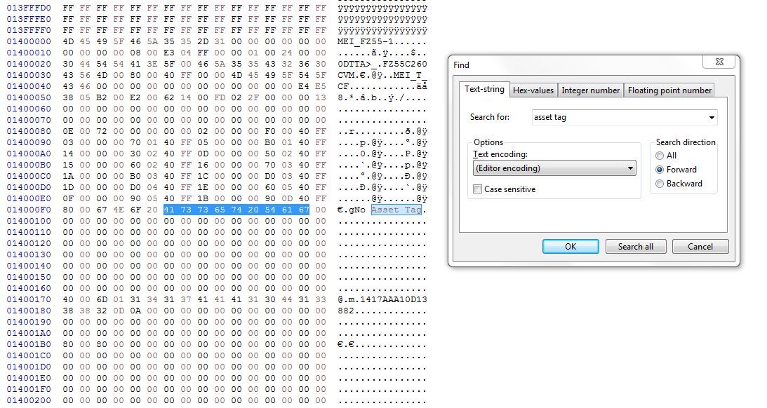

              Open the bios with a hex editor, such as HxD ,do a text search for the serial number or the word asset tag .In that block is the DMI with the model number, serial number. Change text in the right hand side column. The DMI block is usually at the start of the bios region, open the bios with UEFITool ,the region starts after the ME firmware/Gbe firmware

                #667
                Hi bro, I give up. I’ve tried several times, but I just can’t do it. Can you save me?
                I took a photo of the original label and included it in the RAR file. Thanks in advance for your help.

                  #668
                  replace CF54FC090KC by CF54DY024NG
                  not sure for asset tag try
                  or SMDFlea please verify
