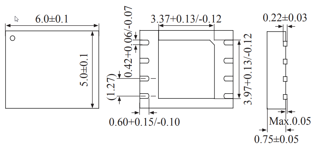

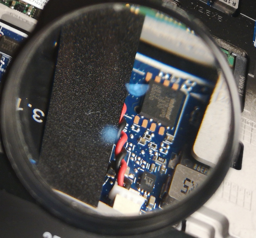

                          • Buck Rogers
                            • Jan 2020
                            • 2
                            • Earth
                            #313
                            Re: Bios dump elitebook 840 g3
                            They've been changed the pins of eeprom. I think now nobody can't reach with a clip.
                            Any idea for dumping BIOS?
                            • RethoricalCheese
                              • Mar 2013
                              • 1519
                              • Estonia
                              #314
                              Re: bios dump elitebook 840 g3
                              Solder wires to gold pads or unsolder chip with hot air and then use the clip.

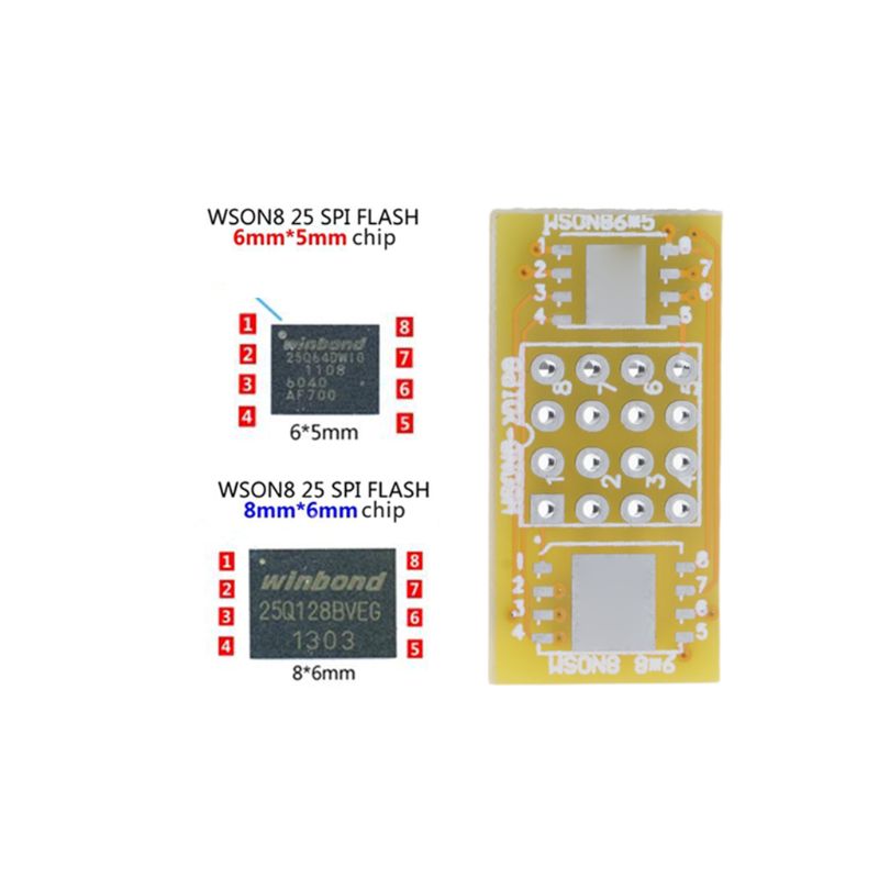

                              • piernov
                                • Jan 2016
                                • 4439
                                • France
                                #315
                                WSON 8 package. You can also desolder and solder to WSON8 adapter board. There are 2 package sizes for WSON8, 8x6 and 6x5, you need the correct one.

                                  • Buck Rogers
                                    • Jan 2020
                                    • 2
                                    • Earth
                                    #317
                                    RethoricalCheese: Thanks, I'll try in a couple days.
                                    piernov: yes that is a WSON 8 and dimensions are 6mmx5mm. Clamshell adapter prices is crazy (about from $55 to $400)
