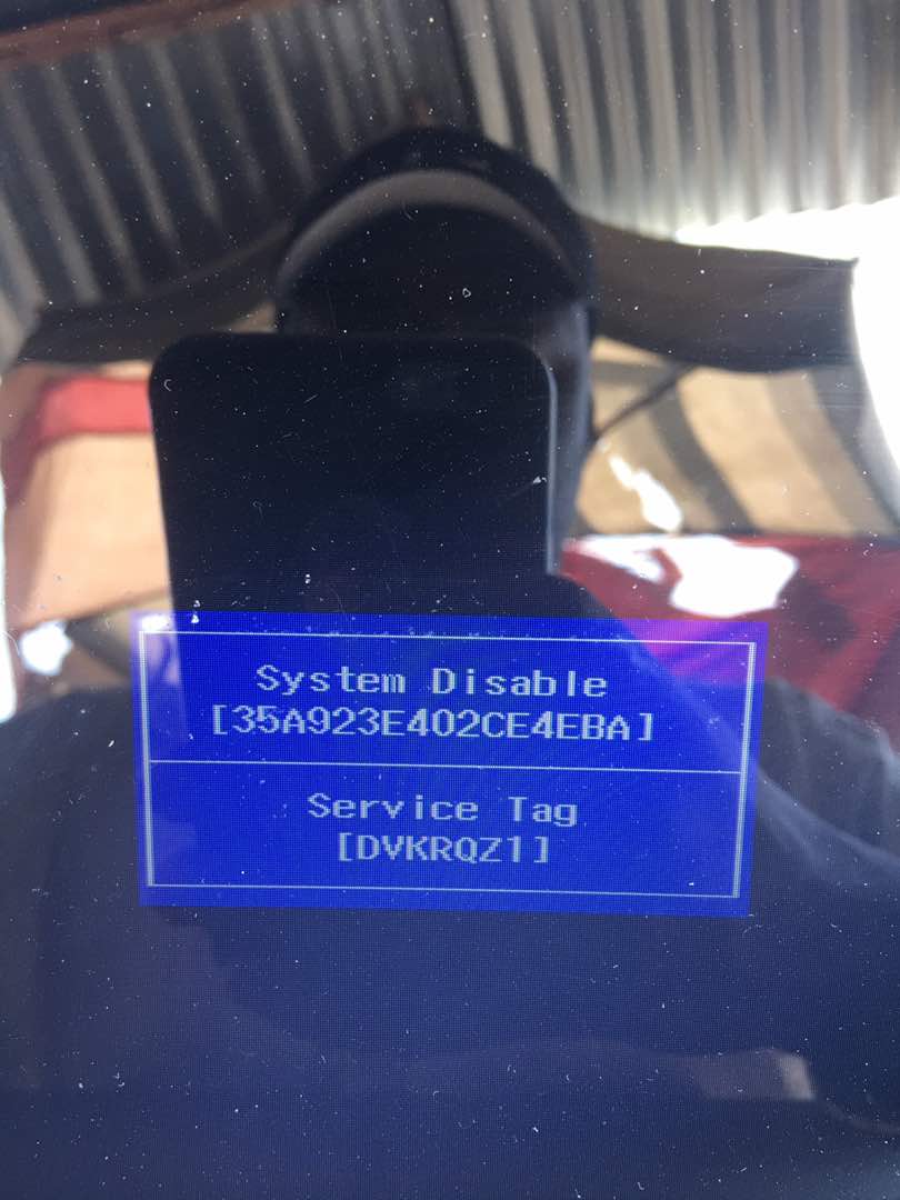

                Re: Dell p28f 3537 LA-9982P bios need
                please someone can help me remove bios password from dell p28f
                  Senior Pascal,give us the picture of your dell code you are talking about

                    #29
                    okay

                      #30
                      The password is store ene kb9012 a3.

                        #31
                        Okay somebody can give me the dump of ENE kb9012 a3 ?

                            #33
                            Originally posted by pascal komlassan
                            okay
                            try this code at code prompt:20290990

                              #34
                              thank you my brother I tested the code but it did not work. Any help?
