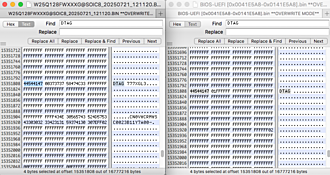

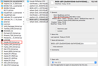

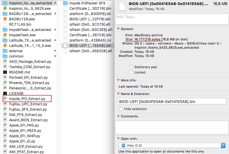

            ok, thank you, I extracted the bios file isflash.bin 18564kB, trimmed it in a hex editor at the beginning and at the end to 18384kB, but now I can't understand how to transfer the laptop data from the old bios to the new one, sorry this day am weak.

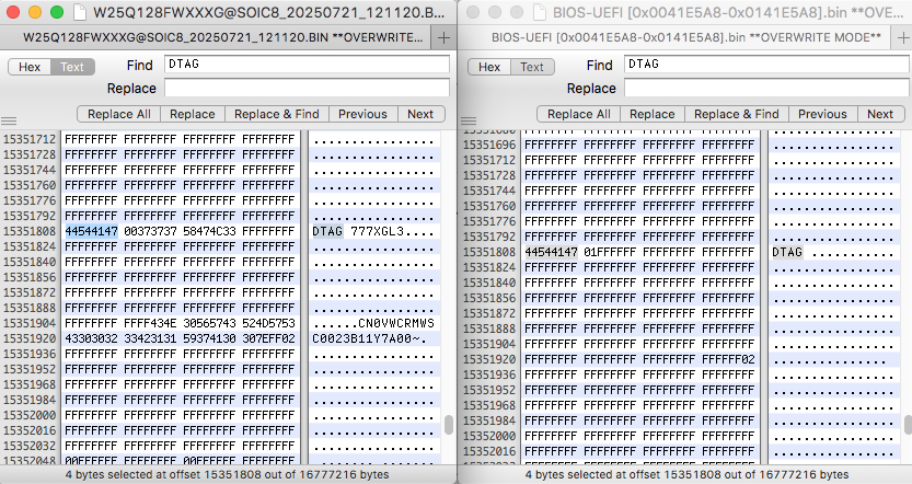

                  It's a insyde platform so use insyde_ifd_extract and you'll get the right bios file. Search for text "DTAG" in bin files and transfer it to new bios.
Name:	Screen Shot 2025-07-21 at 15.50.13.png
Name:	Screen Shot 2025-07-21 at 15.49.43.png
